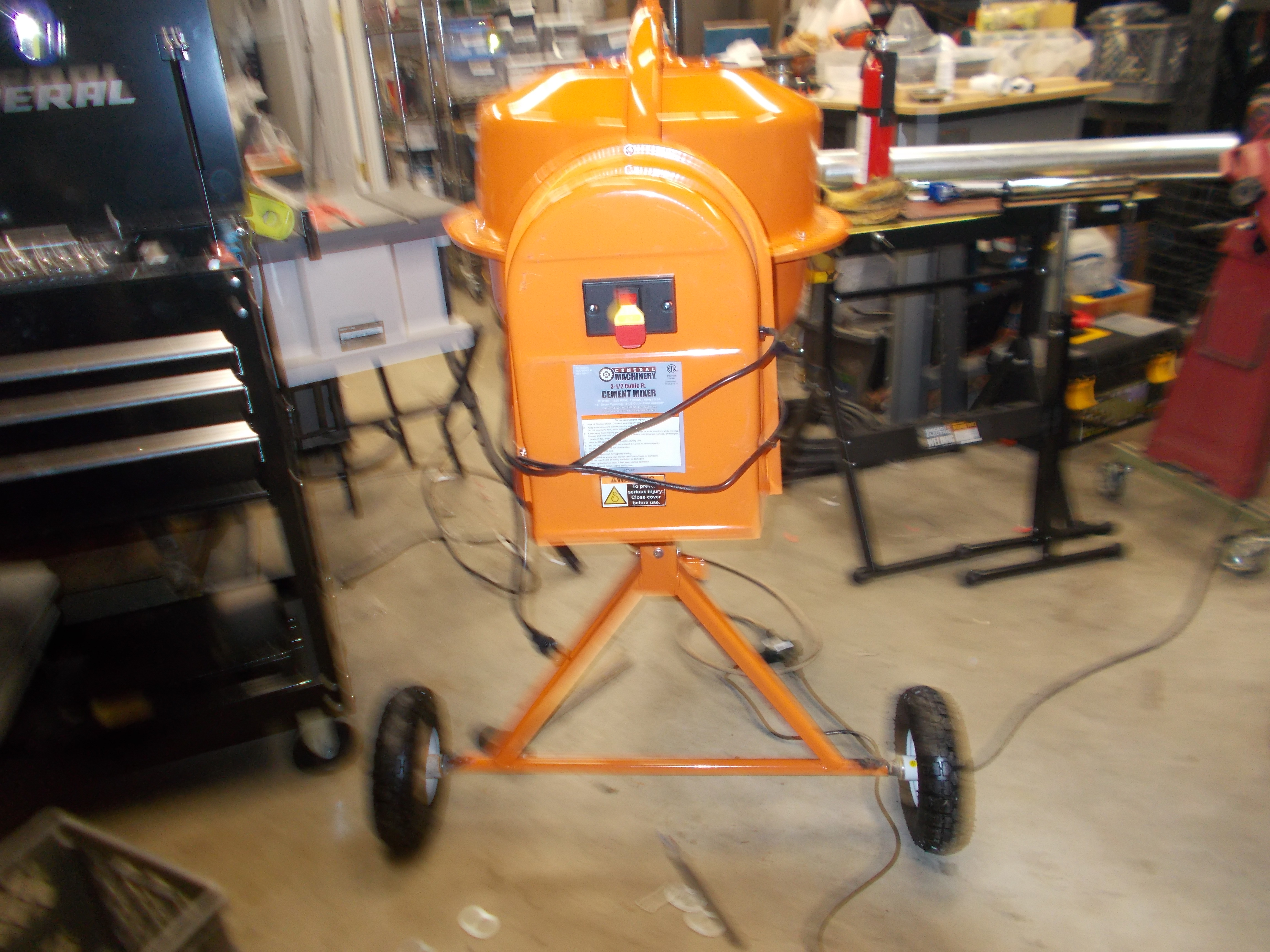

I just assembled the HF mixer. For once the instructions were good and no missing fasteners. I see a big potential problem area with the axle and wheel assembly. The wheels are junk. I determined the tube that is the axle will receive a piece of 1/2" schd 40 pipe. A 5/8 axle most after market wheels are made for is a tight fit . Plan to heat the pipe and drive 5/8 axle stubs about 4" then weld. Add pneumatic tires/wheels and it will a lot handier and hold up under the pressures of heavy concrete. I have quite a few projects for it plus a friend also needs. Save a bundle over rental coats.

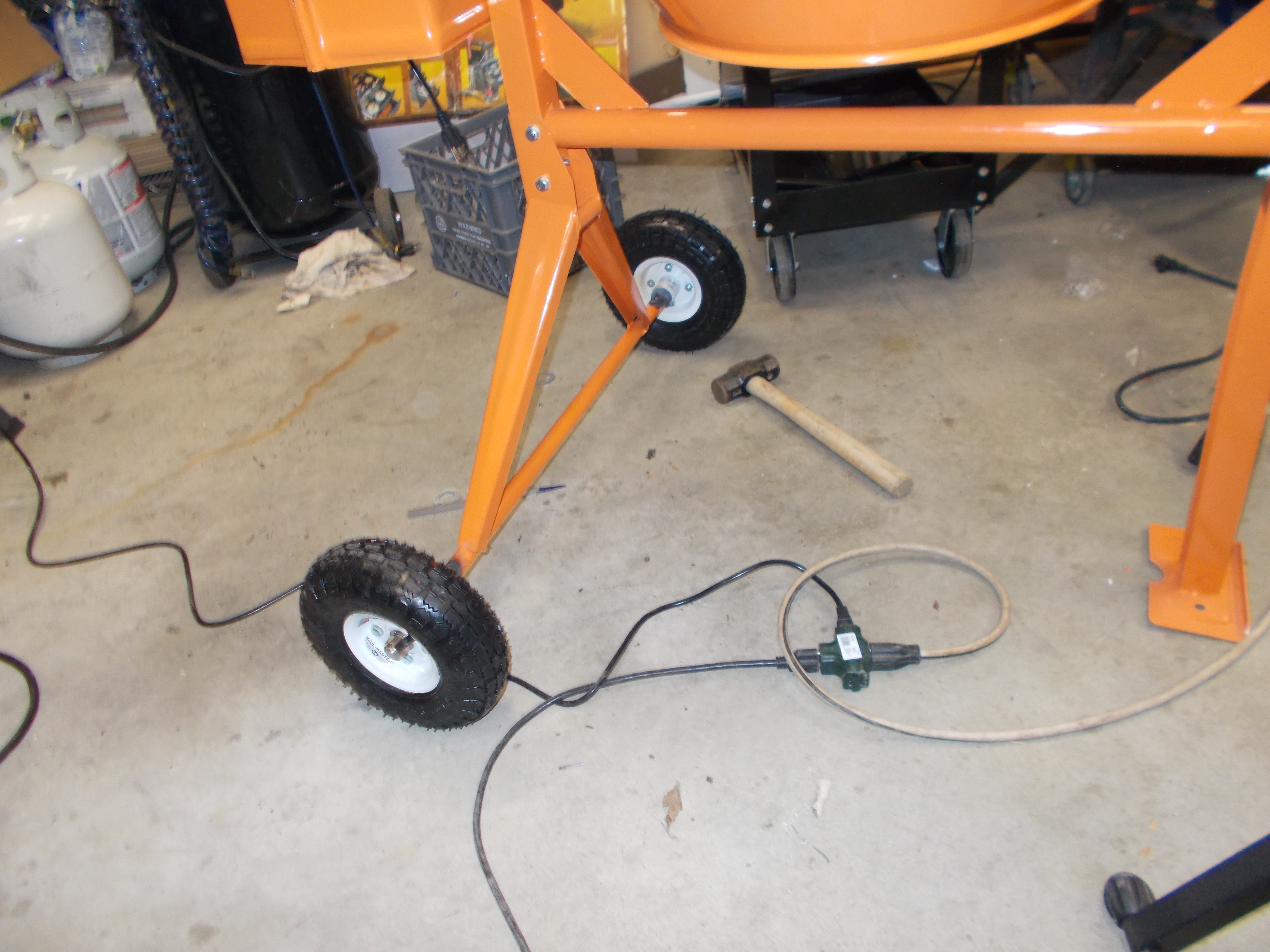

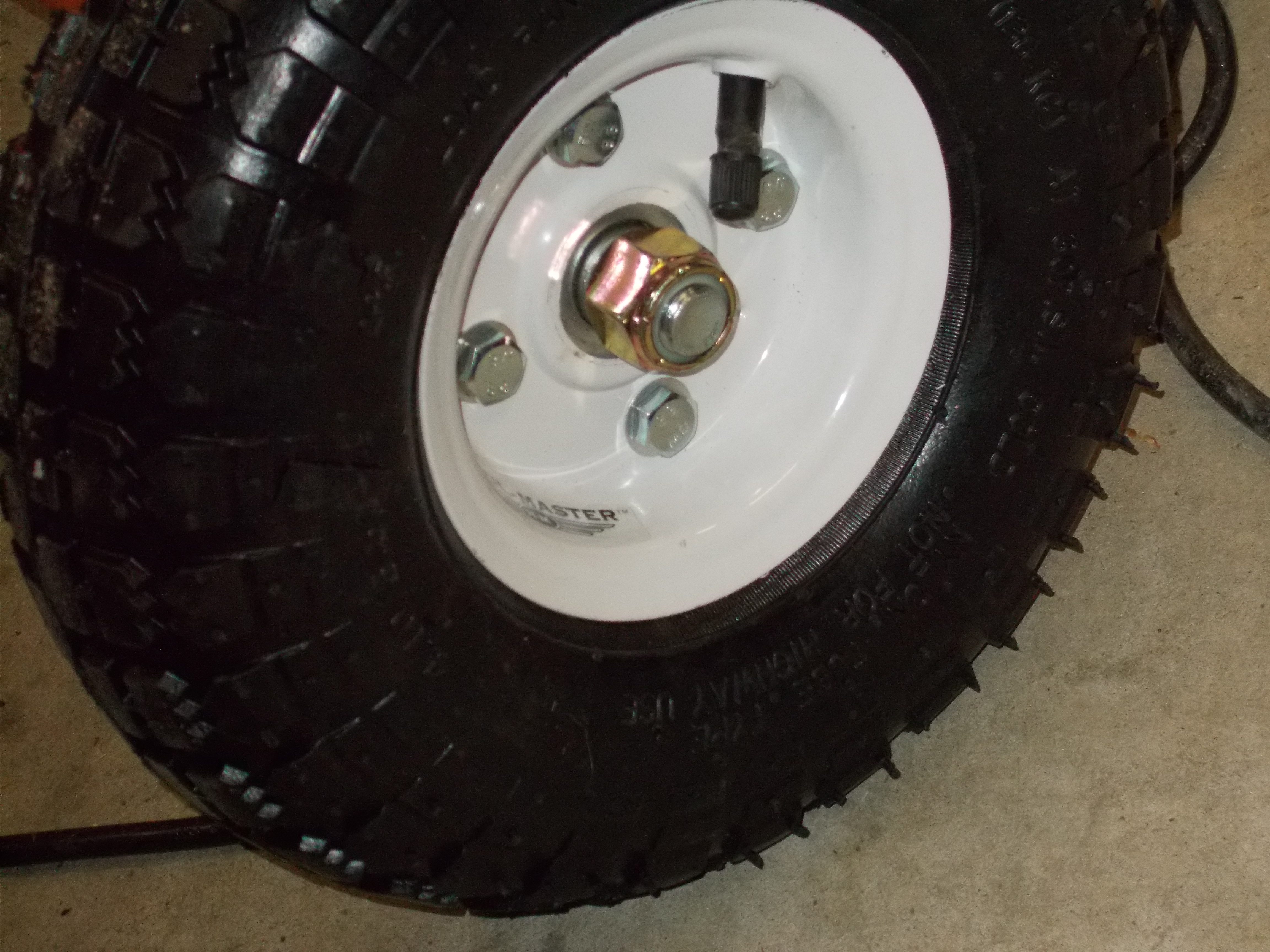

i finished the project. 10" Pneumatic wheels, 5/8 X 5 bolts, pieces of 1/2" pipe. Pipe went into the existing axle tube, 5/8 bolt (heads off) swedged into the pipe with heat torch coaxing; welded all up. Rolls on ball bearings now. Pictures: DSCN0007.JPGDSCN0008.JPGDSCN0010.JPG

Really nice job Ron. Very clean and professional.

Very nice. That should roll over rough ground much better.
Thanks to you and Rock Crawler. Strange thing is I doubt it would cost the factory more than $5 to do on the production line. So much for their touted engineering department. My grade 8 nuts are an overkill and treading a piece of rod both ends is probably cheaper than the grade 5 bolts I cut the heads off. I just had the stuff. Now need to match the orange paint.
