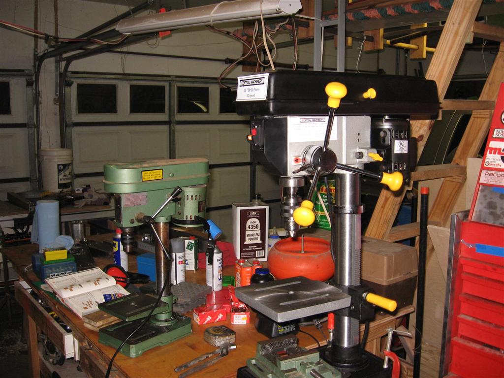

Here is my latest HF addition. The 12 speed 10" bench top drill press for $89. Seems to be decent, I like the slower speeds. It's a heavy sucker. It's replacing my old HF $39.99 bench top that has to be a 1992 model. It has served me well.

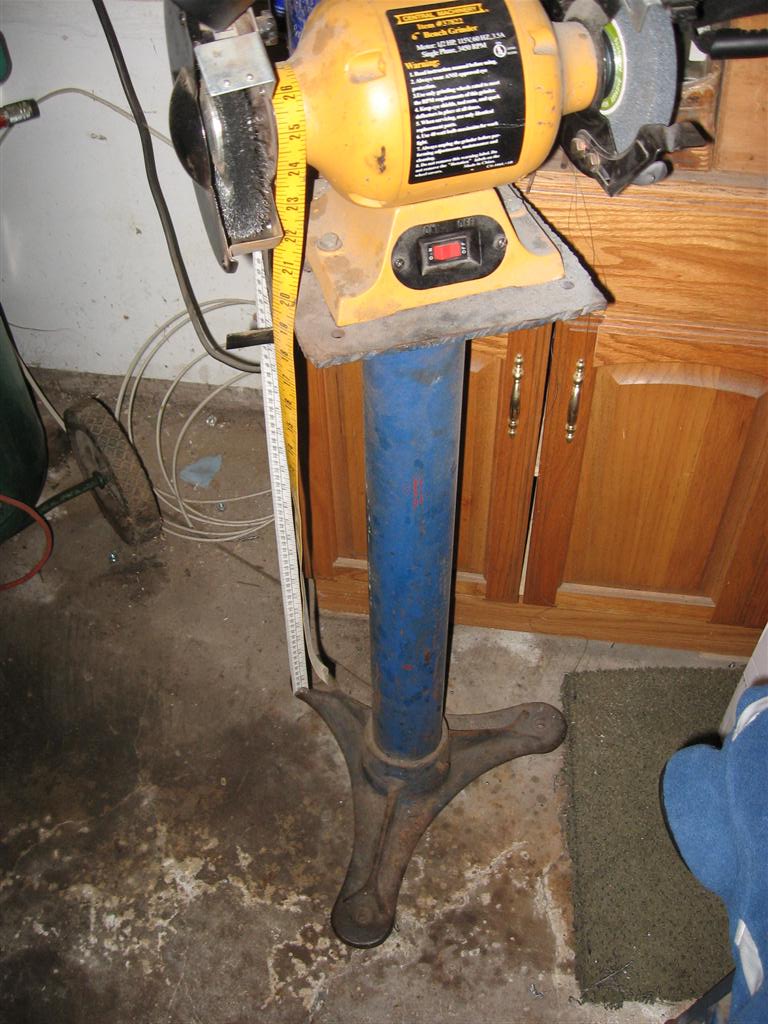

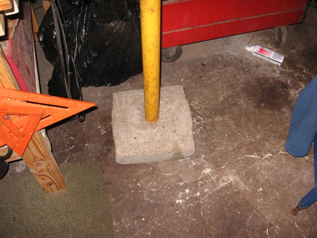

Also attached is a pic of the yellow HF bench grinder. A little light on power but works ok. And a pic of my early poor mans drill press stand (this was pre welder days). The concrete base works well, I formed it with a 3/4" hollow space in the middle of the bottom to help it sit level. The pole was an old stop sigh.. hehe. This weekend I removed the previous wood table top and welded on a piece of plate. I almost made it to small for the new DP, I thought they were about the same size.

Rob, Couldn't help but notice the reloading supplies. What are you feeding and what are you feeding it?
Also, for what it is worth, you can often get old truck wheels for free (or car wheels if you don't need as much weight and stability.) I got some old split rims for free from a tire shop. You weld a vertical pipe to it and then fill it with concrete. Free form and the inevitable banging it gets doesn't chip concrete.
You weld three lumps (can be bolts, nuts, or just chunks of scrap iron) to the bottom of the rim, roughly 120 degrees apart and then use a scrap of ply, OSB or whatever with holes drilled to match the three chunks so you get a seal on the bottom of the wheel when pouring the concrete. After the crete cures enough knock the ply or OSB off and yo have a HD stand that will not rock even if the floor is uneven as it is stable on its three contact points.
The big rig wheels make a darned stable stand base when filled with crete but if you want to move them around to optimize shop layout then consider three locking casters instead of just any old lumps. As you are probably aware, HF has decent casters for a good price.
I have the little '1992' model and I've never been happy with it. The lowest speed is too fast and there's no torque - it's far too easy to stall. No way is it a real 1/3 horsepower.
Does the $89 model have good torque?

You are correct on all accounts on the old one. To fast and the belt will slip. But it drilled a bunch of 3/4" holes this weekend. Seems I always upgrade my stuff right AFTER a project. :) But for the money and drilling wood, not so bad. Plus before I had it I'd try and drill steel with a hand drill (power of course). Lots of good down pressure with a press.
The new one I haven't drilled anything yet. lowest speed is 250 rpm I think. It's a 2 belt with an idler setup...I guess that;s the way all the 12 or 16 speeds work. I need to drill something tonight!! :D
BTW another HF "not so bad deal" I used that big bit set this weekend on the old DP. 12 3/4" holes in mostly 1/2" steel and the last hole was as easy as the first. The set is $29 regular and I had a coupon for $22.99. Here is the link...my local store had them and honored an internet print out.

Good idea on the rims, I never can seem to find some laying around. I've used the concrete before in an old 5 gallon bucket. Cut it about half down, fill with concrete (works nice with that half bag you have left over from the last project...and need to get rid of it :)). The base of the bucket already has a rim for an uneven floor.

When I have made bases for anything and not used the three legged stabilization approach I always have found somewhere I wanted to put it where the floor was uneven and it rocked. That can't happen with a 3 legged approach.
I bought a 6 inch vise with anvil cast in it. I may cut down a steel drum to about a foot or so high and pour it full of crete as a base for the vice. I will use 4 or 6 inch HD pipe as the vertical if I don't find a piece of rectangle I like better. It will get three HD locking casters from HF so I can move it around. More mass helps with the momentum of a sledge blow to the work piece in the vice or on the anvil. The large mass of the base decouples the hammer blows from the caster wheels.
