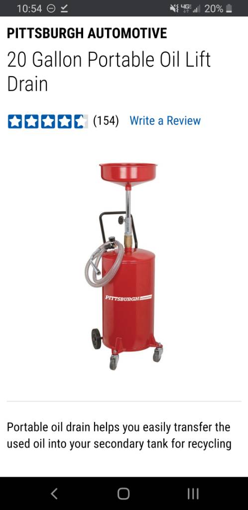

Another good tool for the money.
Finally installed the lift on my shop and needed a good way to change fluids, used something similar at my family's shop. Seems well built and you can use the 20% coupon on it.

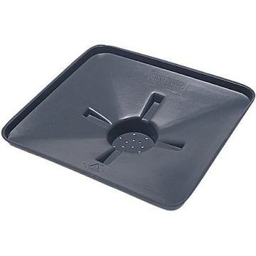

I did add this Lisle catch pan View attachment 646054 because the drain area is a little small for my liking, same setup I had at the family shop.
Buy yourself one of these splash pads.
22" Square No Splatter Pad at National Tool Warehouse
