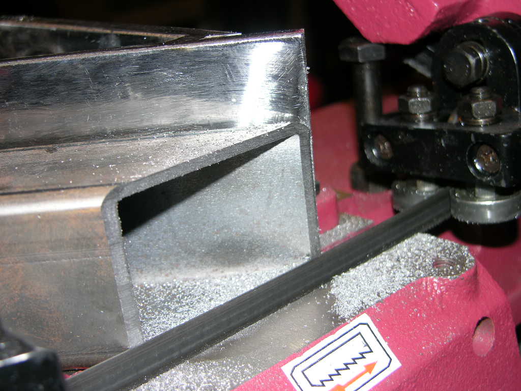

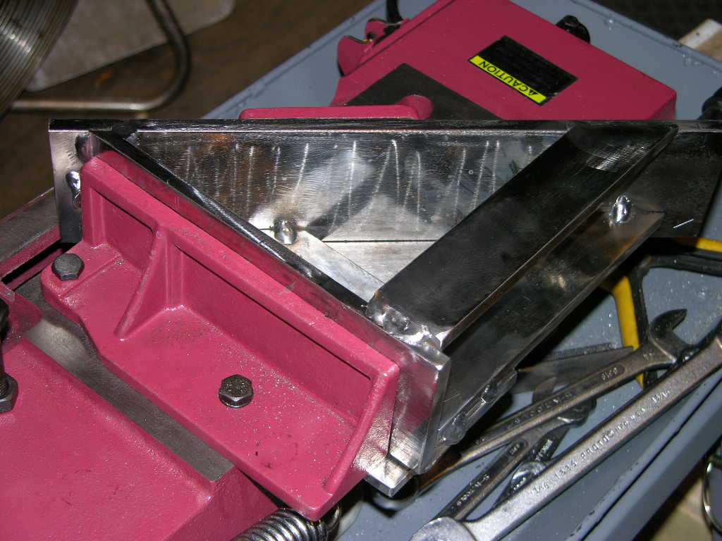

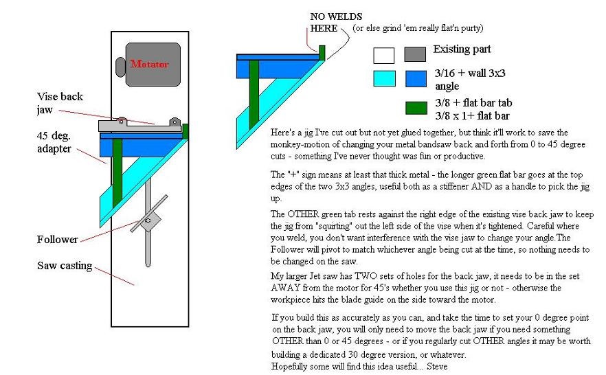

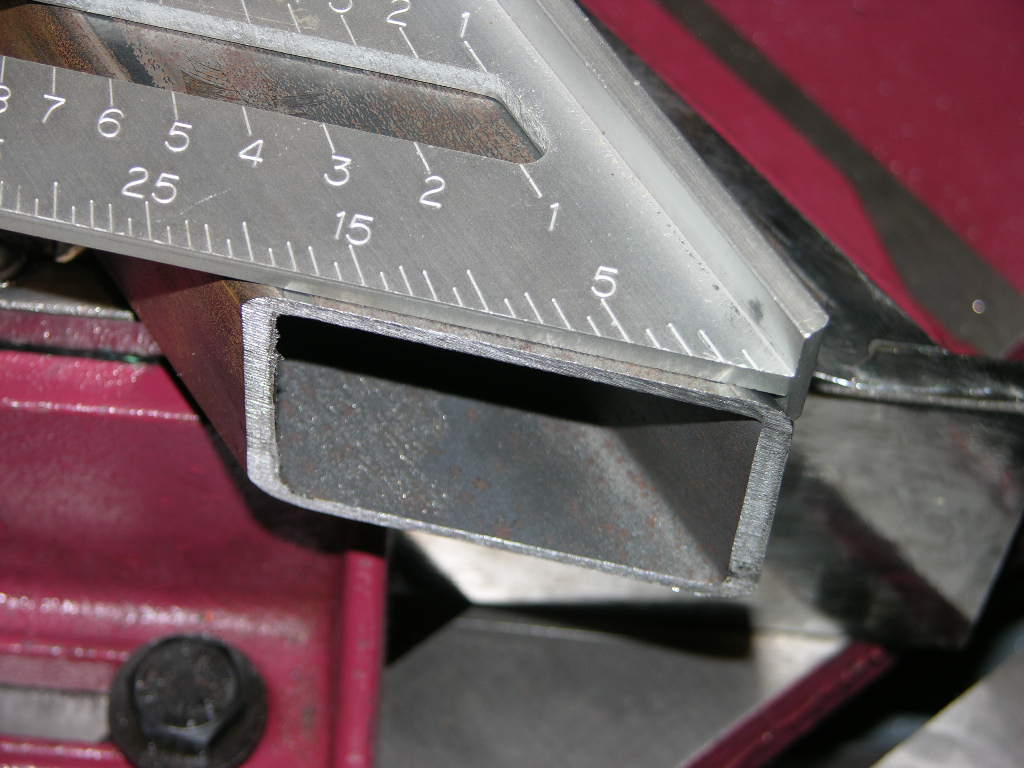

5030 (and others) here's a time saver I built several years ago, did one for my 4x6 HF saw (2 of 'em) and a bigger one for the 8x12 Jet saw - 45Adapt01.JPG

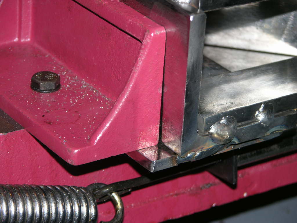

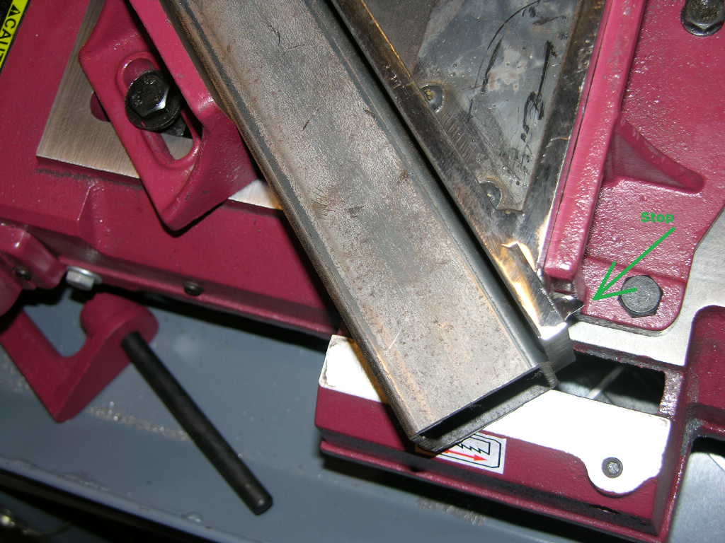

Fixed jaw side, note the small tab UNDER the jaw; jig tends to raise up when clamping otherwise - DSCN1545.JPG DSCN1546.JPG This shows the stop at the blade end of the vise DSCN1549b.jpg - on that one, I drilled/tapped the angled face for a 1/2" bolt, bottomed out the threaded part from the back side, then used a zip disk to flush cut the front, and to slice off most of the un-threaded part to form the stop. Without that, the adapter will "squirt" out of the jaws when tightened. And yeah, there are easier ways, that was the (still being used) prototype :D
If you mainly do either 90 or 45 degree cuts, this lets you swap in seconds instead of several minutes. - It ALSO makes almost ZERO difference on jaw capacity compared to resetting the fixed jaw to 45 degrees.
On all 3 of my saws, I use a smaller digital protractor (so it fits down next to the blade) and set the back jaw EXACTLY at 90 degrees (relative to a properly tensioned NEW blade), making sure BOTH of the hold-down bolts are slightly loose and the jaw pushed up against them from between the jaws; then I tighten the bolts, re-check square, then scribe the bed along the fixed jaw for a reference.
The only time this might change is if you swap blades and don't get the new one adjusted the same with the eccentrics on blade bearings. Once a saw is set up, I NEVER move the inner eccentric adjusters (if they have those) - only the OUTER ones for .002-.003 clearance between bearing and blade.
Enjoy... Steve

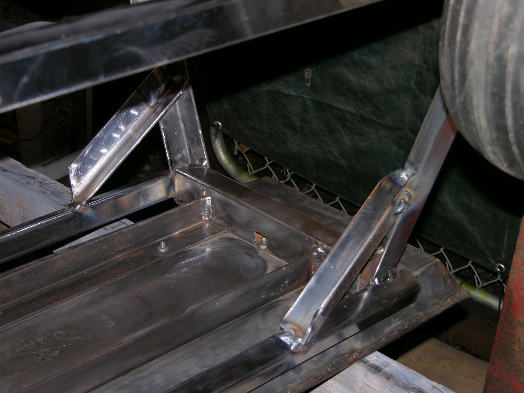

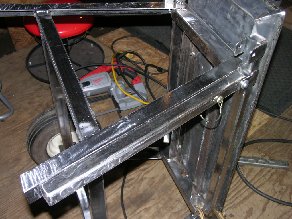

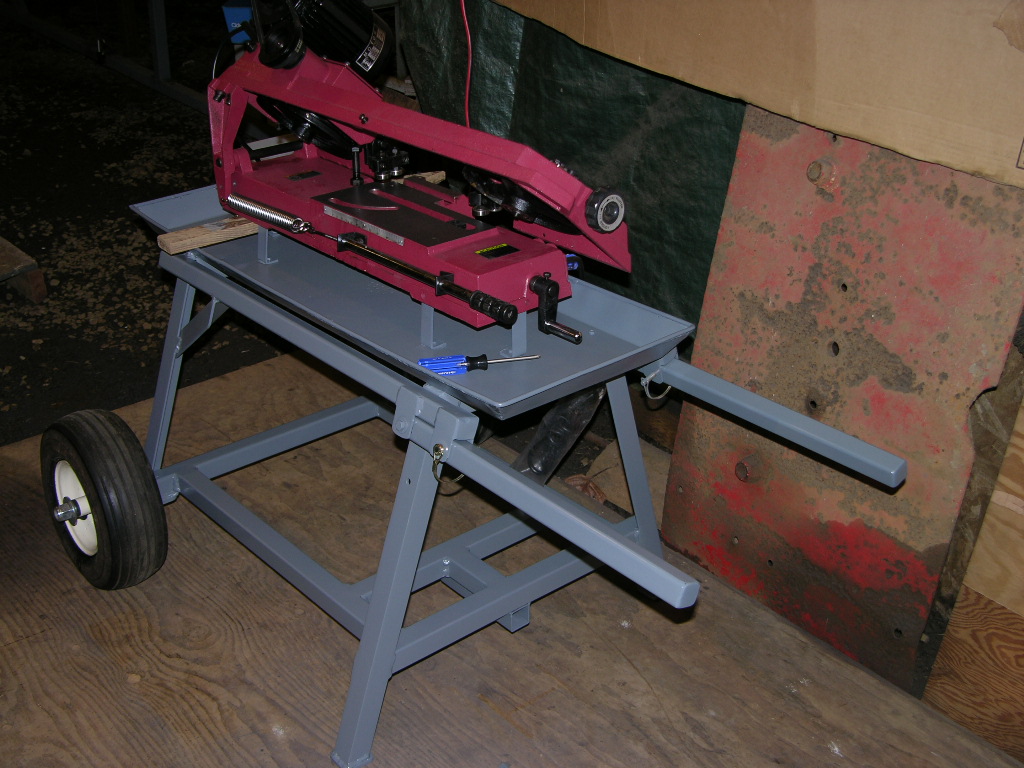

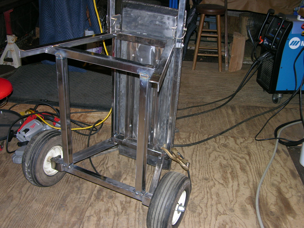

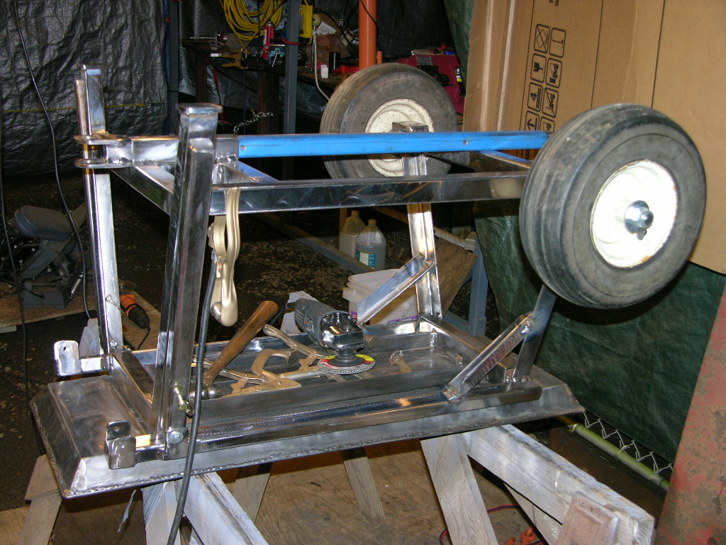

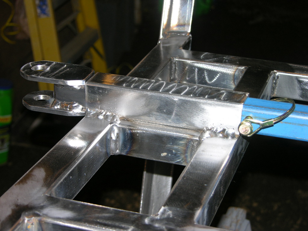

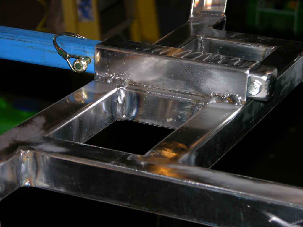

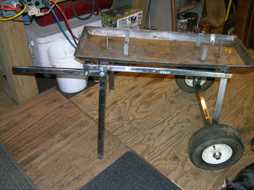

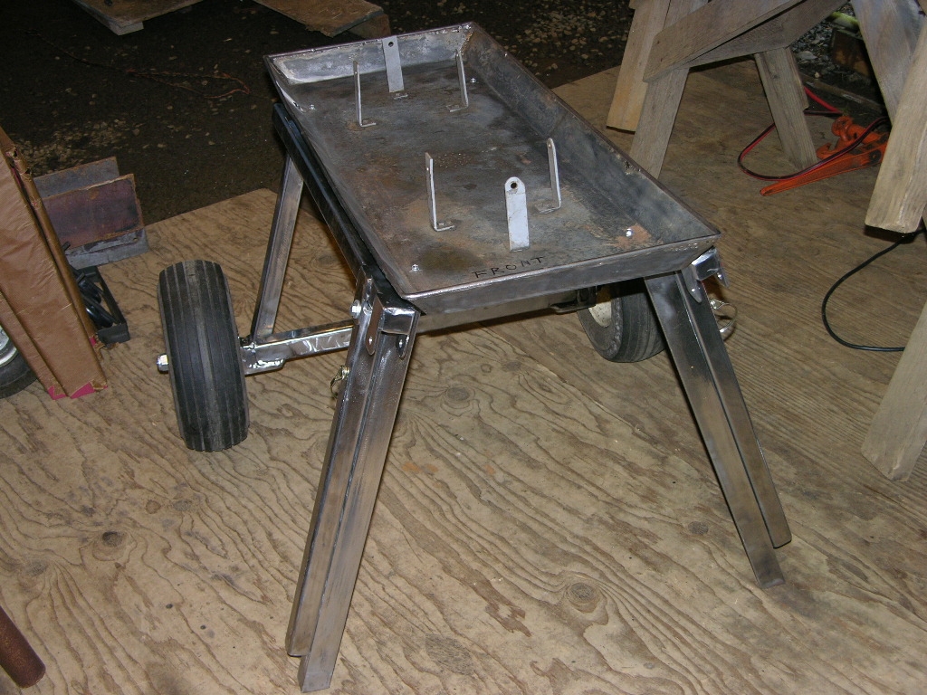

Copy away, that's why I posted it. Oh, and that saw was new when the pics were taken, doesn't look like that any more :laughing: I went a bit different on its base too, my older green 4x6 (bought new in 1981 when HF had exactly ONE store in Camarillo Ca.), original motor and still going strong) is in an 8x10 room along with 'way more stuff than should ever fit, so it's kinda limited on lengths I can cut. (I can feed 20' in thru the door, but outfeed is limited to about 4 feet...
So when I got the newer 4x6, I came up with an "offroad" design - it's its own 2-wheel wheelbarow and has a stowable pin hitch so I can tow it around with the mower or golf cart. Some pics at the bottom.
My Jet 8x12 isn't an Ellis, but does OK. Think it was just under $1200, has hydraulic downfeed, a coolant pump I've never hooked up. Built one of the 45 adapters for that one too, and added an angle iron frame with 13" no-flats on rear, 5" double locking casters front (got tired of having to steer it by lifting one end and moving it sideways :rolleyes:
Here's a few shots of the offroad 4x6... Steve
DSCN1488.JPG DSCN1489.JPG DSCN1491.JPG DSCN1493.JPG DSCN1494.JPG DSCN1496.JPG DSCN1498.JPG DSCN1499.JPG DSCN1501.JPG DSCN1503.JPG
