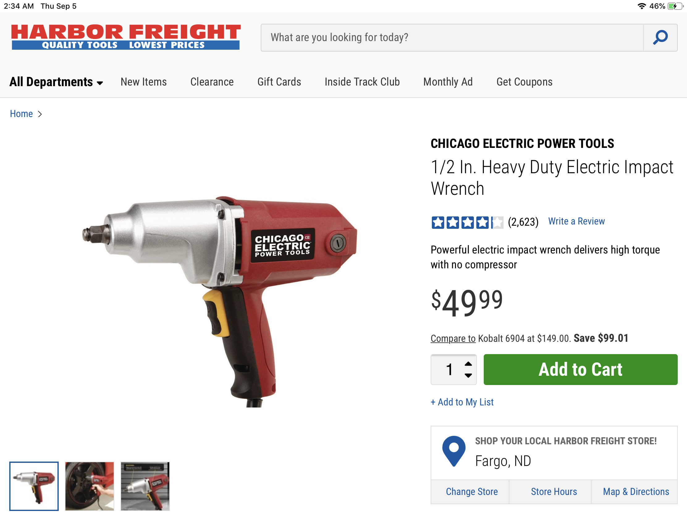

Picked this up almost 2 years ago and it still works fine for what I use it for.
Would like to get this so I can go back to using my air tools, my small compressor does not cut it. Anyone have one like this from HF.

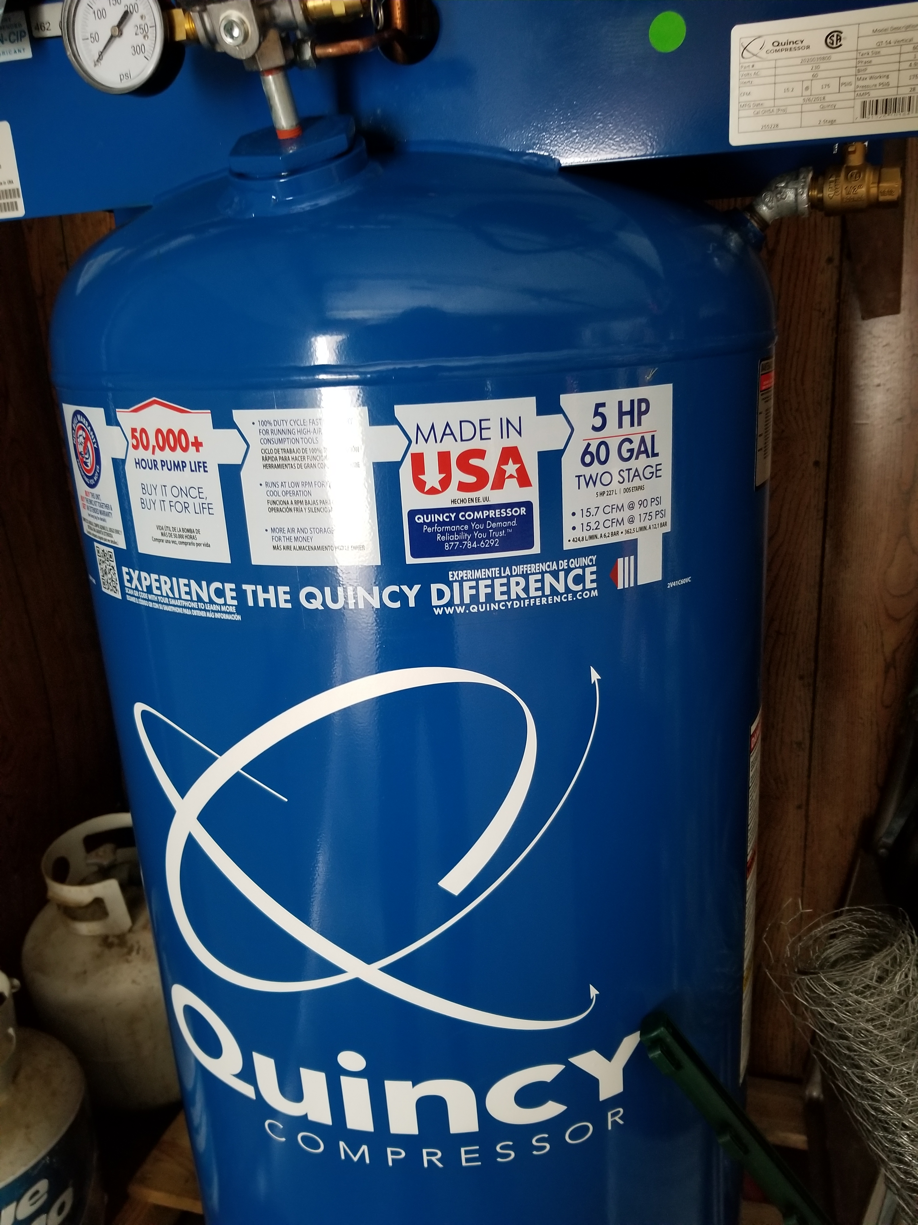

I am a fan of a lot of HF stuff, but...
Unless they've upped their game, I've found the HF larger "shop" compressors to be anemic on their cfm ratings where it matters. Most air tools aren't run at 40 or 50 psi. They are run at 90-100 psi. That is where it takes real "grunt" to run a lot of cfm. The higher the pressure gets, the more difficult it is to make usable cfm. Of course this also depends on what tools you are trying to drive, and how many at once. Some tools are real air hogs, and take a bunch of cfm to run.
I don't look at what cfm the compressor will make at low air pressure (40-50 psi), I look at how much cfm the compressor will make at 90-100, and how much at "full" psi.
My Quincy makes 15.7 at 90 psi, and 15.2 at 175 psi. Now that is some cfm you can work with.

Approximately how much did your Quincy cost?
I believe we paid $1400 ($1399). My wife bought it for me as an early Christmas present and I think she ordered it through Lowe's website. I had been looking at them here locally, as Running's usually keeps them in stock.
