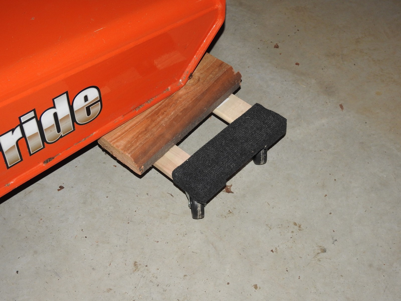

The weight needs to be evenly distributed across the carpeted sections and on top of the casters. The crossbars between are just that, crossbars/stringers, not intended to be weight bearing.
Yeah, that was the purpose of the wood blocks on top, to spread the load. I knew it was asking a lot. Re the other guy and pallets, I'll have to make a pallet for it, it's a 6' cutter. A normal pallet would just disappear underneath it.

The key with those is to get the weight evenly distributed across the whole dolly and not have any point loads.
Aaron Z
Yeah, I knew that'd be a problem, which is why I added the extra board piece. The problem with the brush hog is that it kind of comes down to a point in front, it isn't perfectly flat when it's fully "down". So it's very much a point weight, and of course the skid is only about 2-ish inches wide in the first place.
No doubt I'll constructing something else long term, I'm just dealing with short term problems at the moment. Meanwhile, I still expected that those black-covered dolly pieces were, you know, actual lumber, with wood grain and long fibers. Not wood chips glued together in a 1/2 inch or less mash.

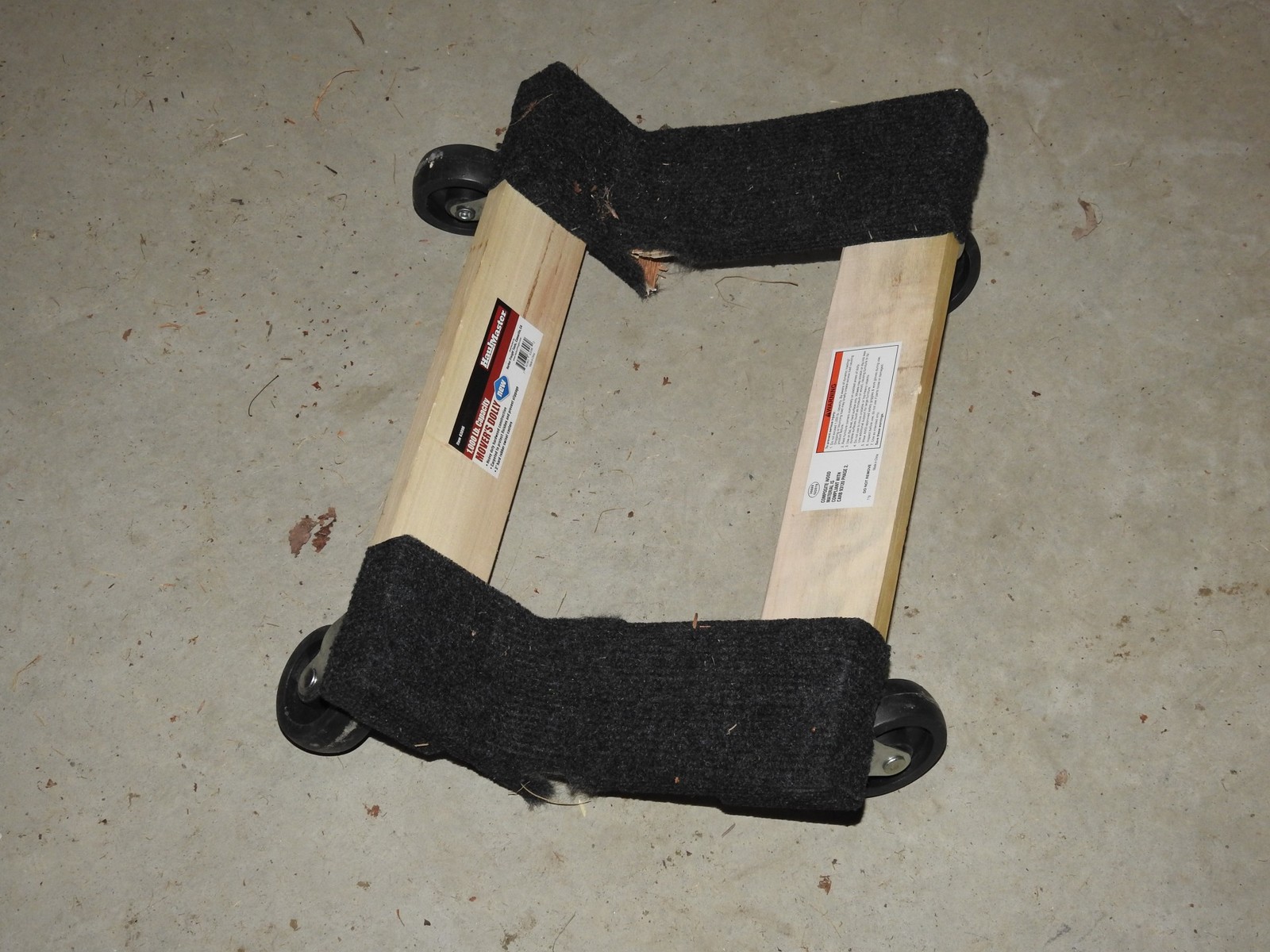

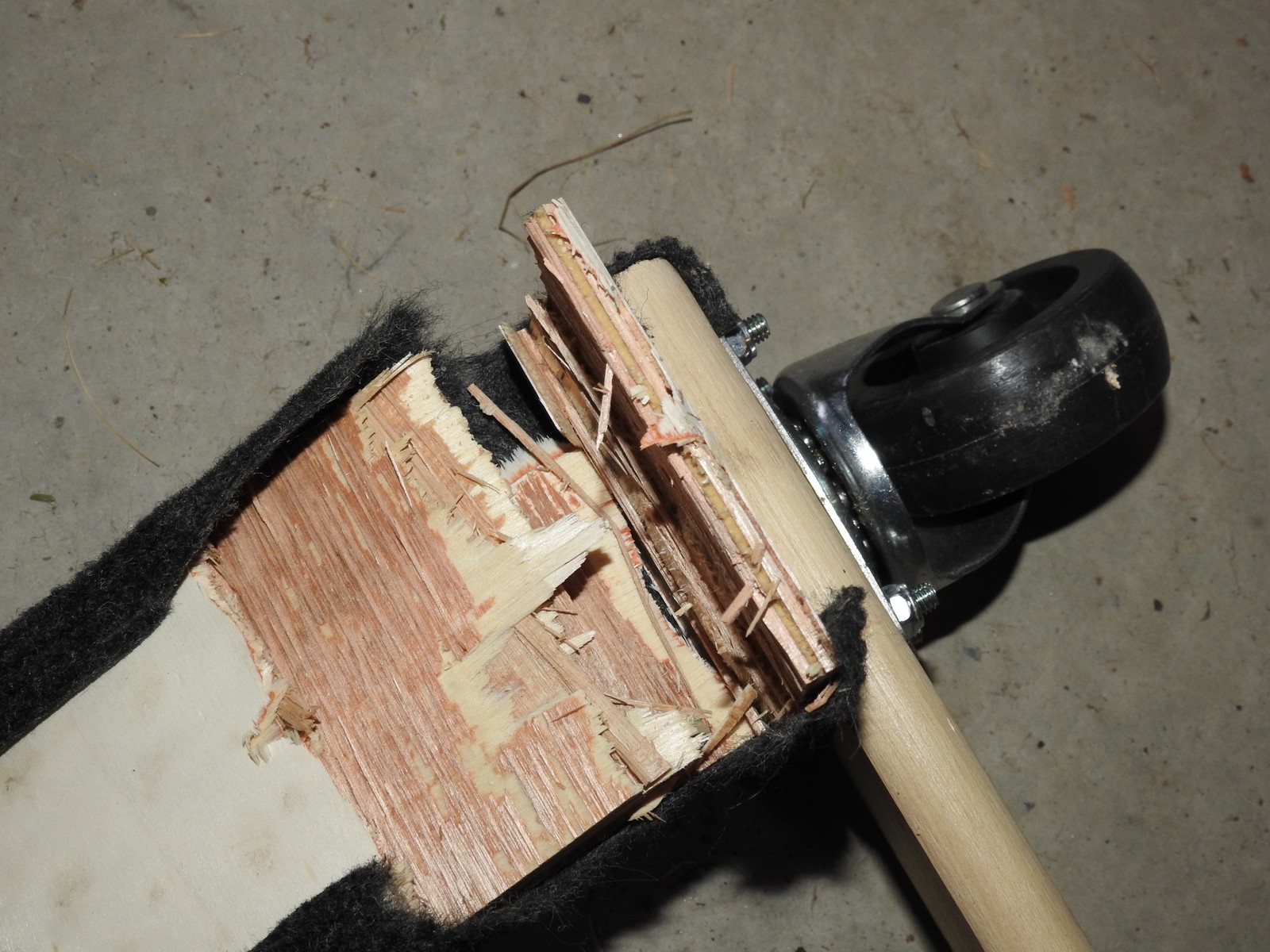

I bought a bunch of HF dollies on sale. The little 12x18's and some 18x30's. All supposedly rated for 1000 lbs. I had my doubts, but lots of people use them and they're cheap, so why not?
Lol, here's why not: View attachment 651087
Turns out the "wood" hiding under those black covered ends is just thin plywood withs some veneer:
It broke under one corner of a 745 lb rotary cutter when I was setting it down. To be fair, the cutter did drop hard the last inch or so (but there were three supporting endpoints, one being the rear wheel).
The way I ended up using it was like this: View attachment 651089
with the wood piece in the opposite direction of the one that broke.
So... some dollies have survived their first day of use, others ... not. Live and learn, managing these tractor tools is all new to me. Meanwhile it's been 2.5 weeks and I'm still waiting for the 18x30 dollies, which are in stock per repeated phone calls but HF cannot seem to get their act together. Last time I buy from them mail order I think.
You've still got 4 casters 3" in diameter, add a few feet of 2x4 and your back in shape.
I've got 30 or 40 of them bought in the last 10 years. So far I've broken one when a 4x8x3/4 sheet of marine plywood slipped and dropped about 6 inches across the middle and another when my bush hog came down hard. If I'm putting something on it that has an edge like in your pic I use a scrap piece of 2x4 or 3/4 plywood.
I've my rotary cutter, my tiller, my chipper and lots of heavy woodworking equipment on them.
I've heavy duty worktables on and stacks of bags of concrete.
I've about 5,000 sq feet of flat concrete in my shops and I should have bought 100 of them when they were $5@ a decade ago.
For $8 it's hard to get four 3" casters.

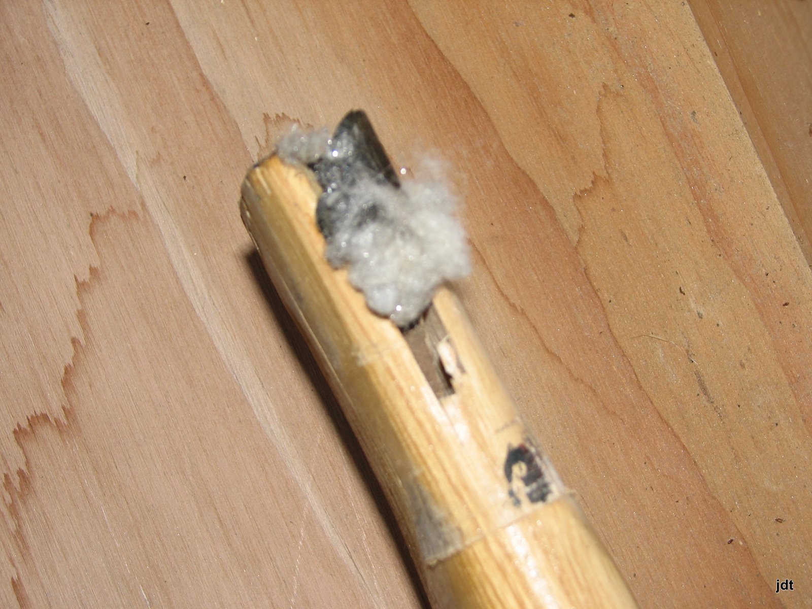

I posted a longwinded bit about this on a blog years ago. Bought the 4.5lb axe (which was a weight I really liked in my axes) from HF, only to have it come flying off the handle on first use in the woods. Turns out it wasn't even remotely connected to the handle.
There was a little blob of black resin in there, and a bit of ... fluff ... of unknown composition. No wedge at all, just a hollowed out shaft stuck in the heavy axe head waiting to drop it on my head. Takes serious talent to screw up an axe to this degree.
If I put something heavy on those HF dollies, I use a piece of 3/4" scrap plywood to span the rails.
That will distribute the weight evenly.
I love those dollies. Use them for everything (usually with plywood).
Only Fiskars for me.
