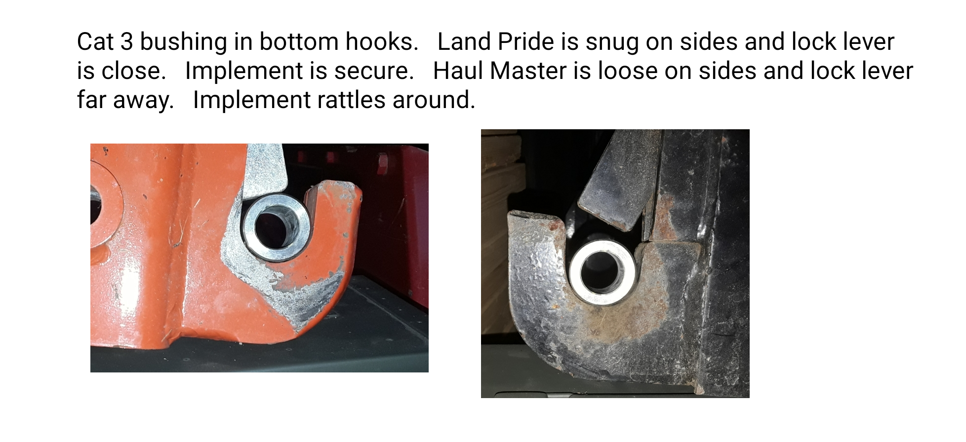

To use cat 1 implements on a QH it needs to be adapted up to cat 3 pins. 1 1/4 top and 1 7/16 inch bottom. One inch water pipe doesn't fit on a quality QH. Plus the ID is wrong unless a bushing is inside. For the OD it will work on the top of a cheap out of spec one such as the Harbor freight.

Harbor Freight hitch example.

Land Pride QH10 seems to be $400~500 per a brief search.
HF what? $129?
Either is fairly priced. Depends on what you want.
For what I use it for, the HF is sufficient. (And was half of today's price when I bought it). But I don't rototill with it, that's the one implement that can't be made compatible.

There are other low cost QH out there that are closer to spec vs the ones HF sells.
The HF quick hitch could be decent if the clearance issue with the top hook was fixed along with making the pin fit closer to specifications. It is durable enough.

I think SpeeCo and Land Pride have cat 1 quick hitches that use cat 1 pins. The Land Pride is a QH10. There are a few off brands also.
I'm modifying the Harbor Freight hitch to fit tighter. At $12 total cost (Rural King) it's not that expensive for precision upper and lower bushings.

... I'm modifying the Harbor Freight hitch to fit tighter. At $12 total cost (Rural King) it's not that expensive for precision upper and lower bushings.
I had Cat1 & 2 3PHs for a while so I put Cat1 pins on all equipment & slipped TSC Cat2 bushings onto 'em as needed to hook up to the Deeres. btw, never used my HFT QH, I'm off the seat checking/adjusting top link and sway chains/bars, hooking up PTO, warming up, etc anyway.
