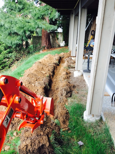

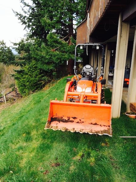

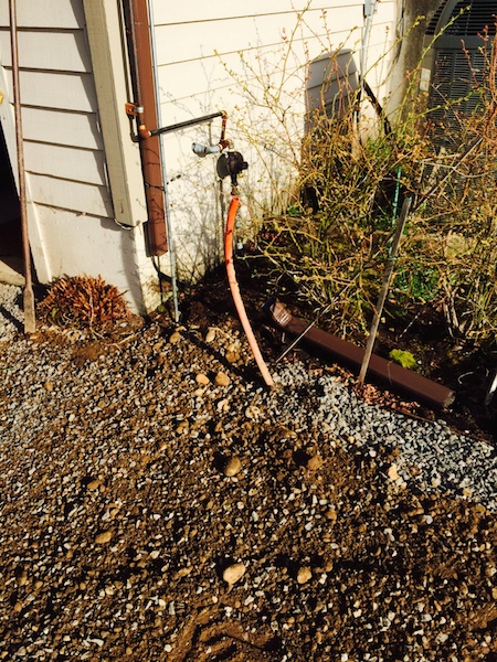

The weather has finally improved enough to allow me to get on this project. Ultimately for the wife, but I want it to have all of the 'bells and whistles' within reason. I hope to post some video at some point but here are some pics of the construction. These first pics show the ditching work to provide plumbing and power to the site.
A plug for the BX here... I can get into places that no bigger tractor can reach and do some major digging...

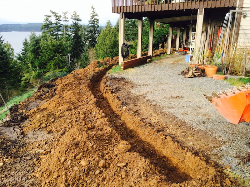

About 80ft of trench to lay 160psi poly pipe and another trench to add 2 20amp lines

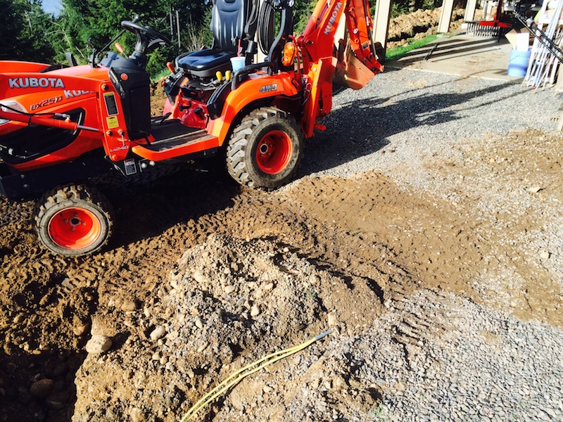

Starting to flatten out a slightly larger than 10ft by 12ft pad for the greenhouse.

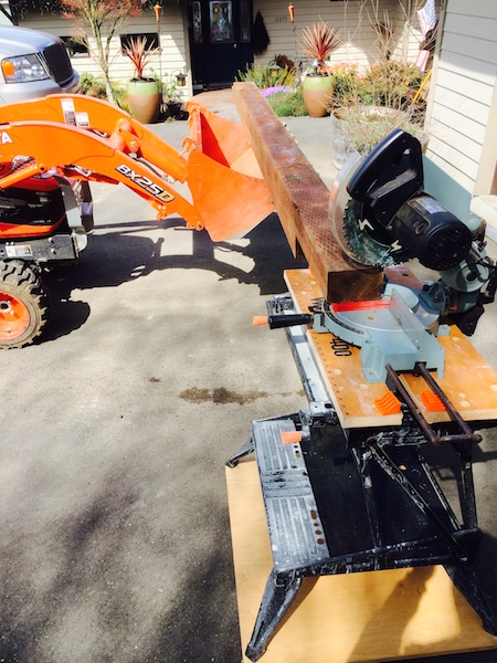

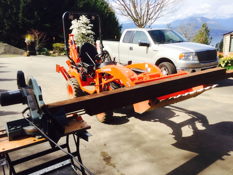

Found another use for my tractor... I purchased some 4 x 6 pressure treated timbers and needed to trim a couple of them a bit to make the frame for the foundation that the greenhouse will sit on... you gotta love all the things that a little tractor can assist you with. My back loves it most!

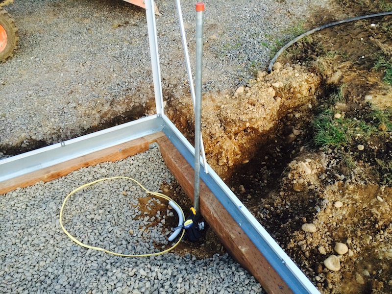

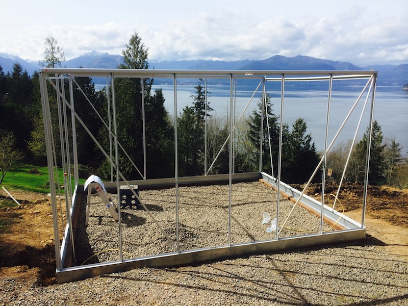

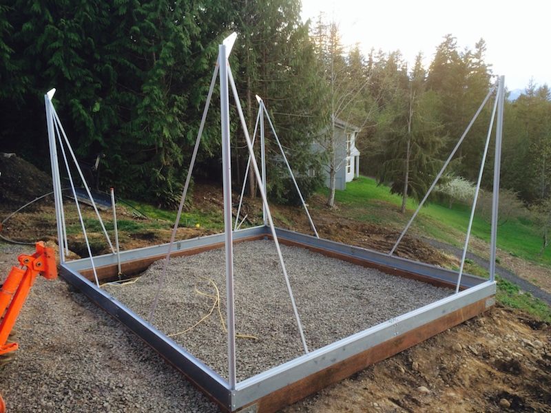

4 x 6 in base frame and 3/4in crushed clean gravel fill in place and now the aluminum construction. Pretty flimsy sheet aluminum and extrusions but efficient use of metal I must admit.
Corners and wall structure and feeling good...

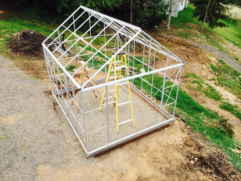

First floor complete and now on to the roof!
Blessed with a decent weather day but of course the afternoon winds are picking up as I now have unsecured members dangling.

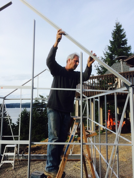

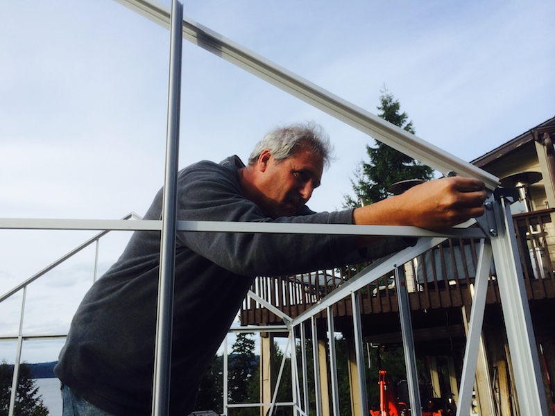

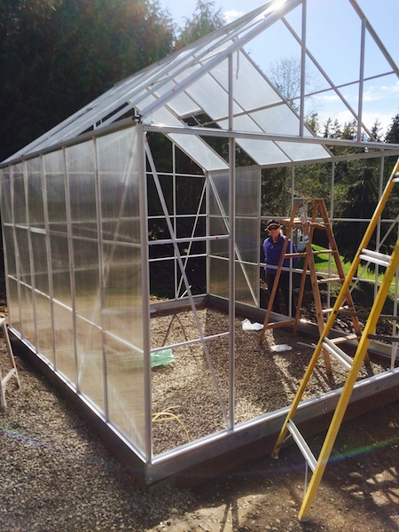

A little more ladder work and at this point really needed assistance from the better half...

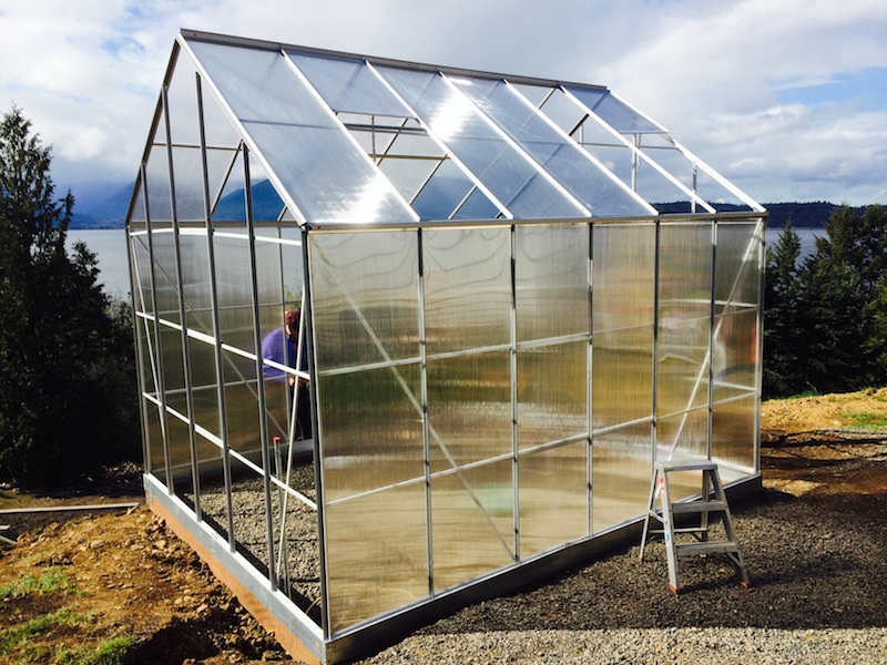

Frame complete and glazing panels going in...

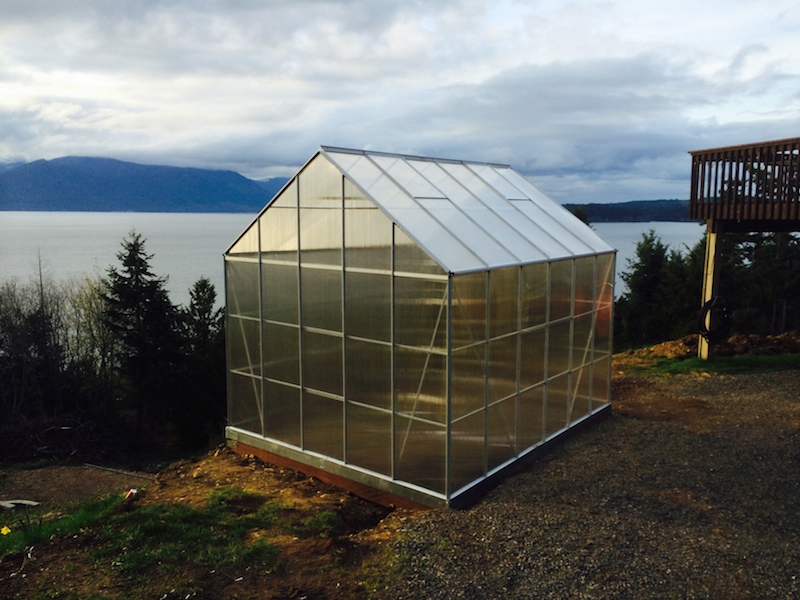

Day is turning to night but feeling good again about progress...
