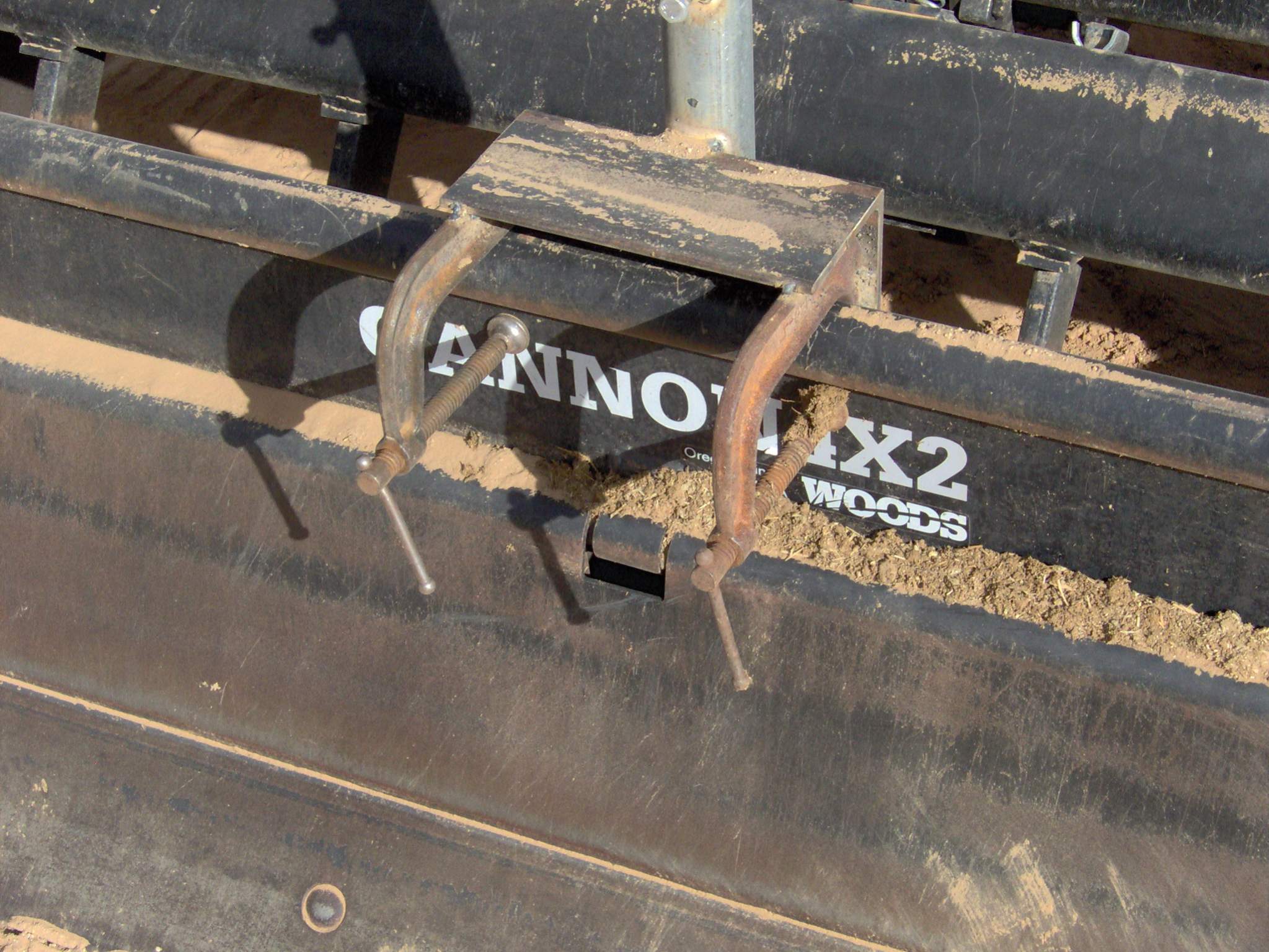

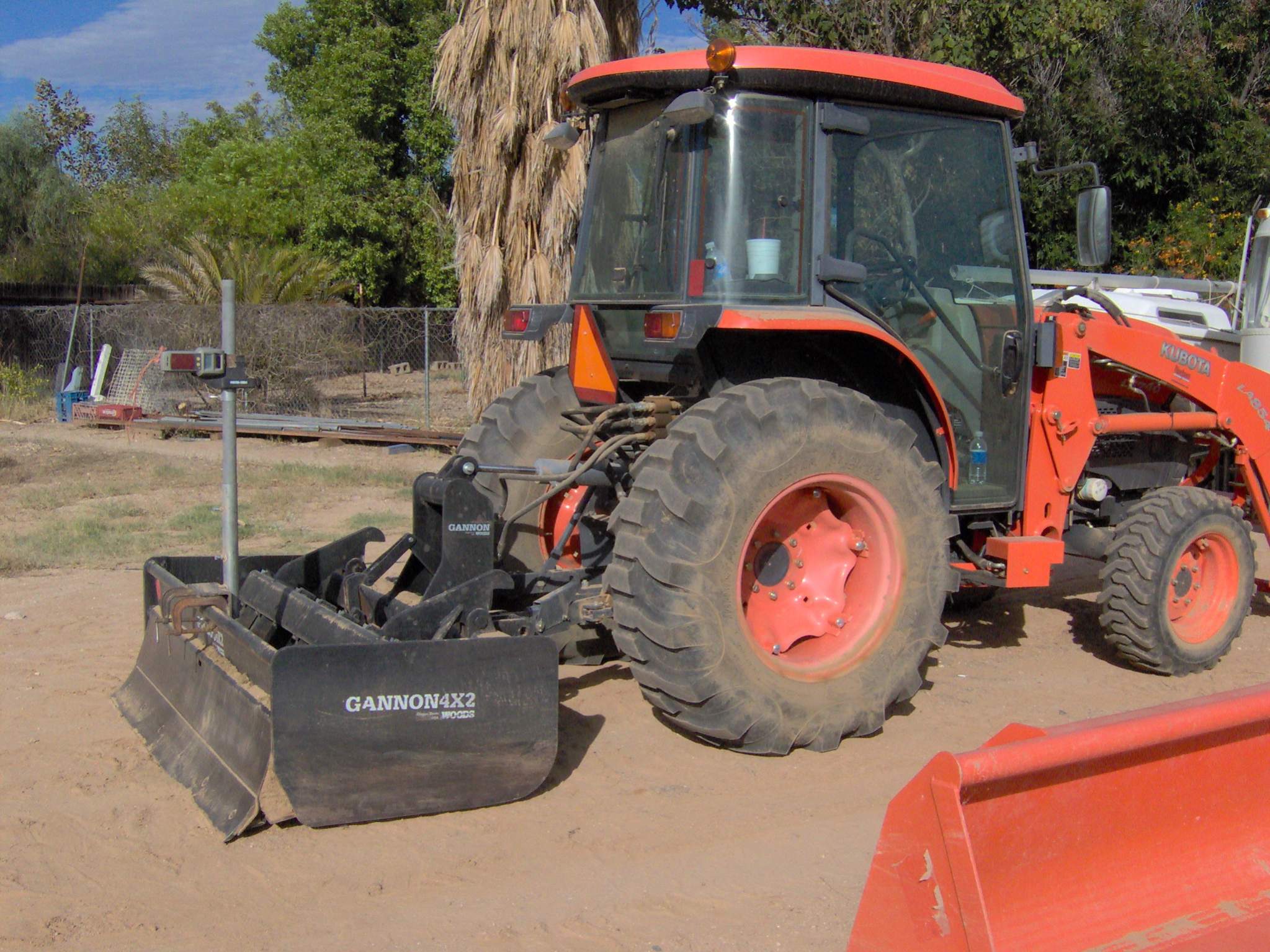

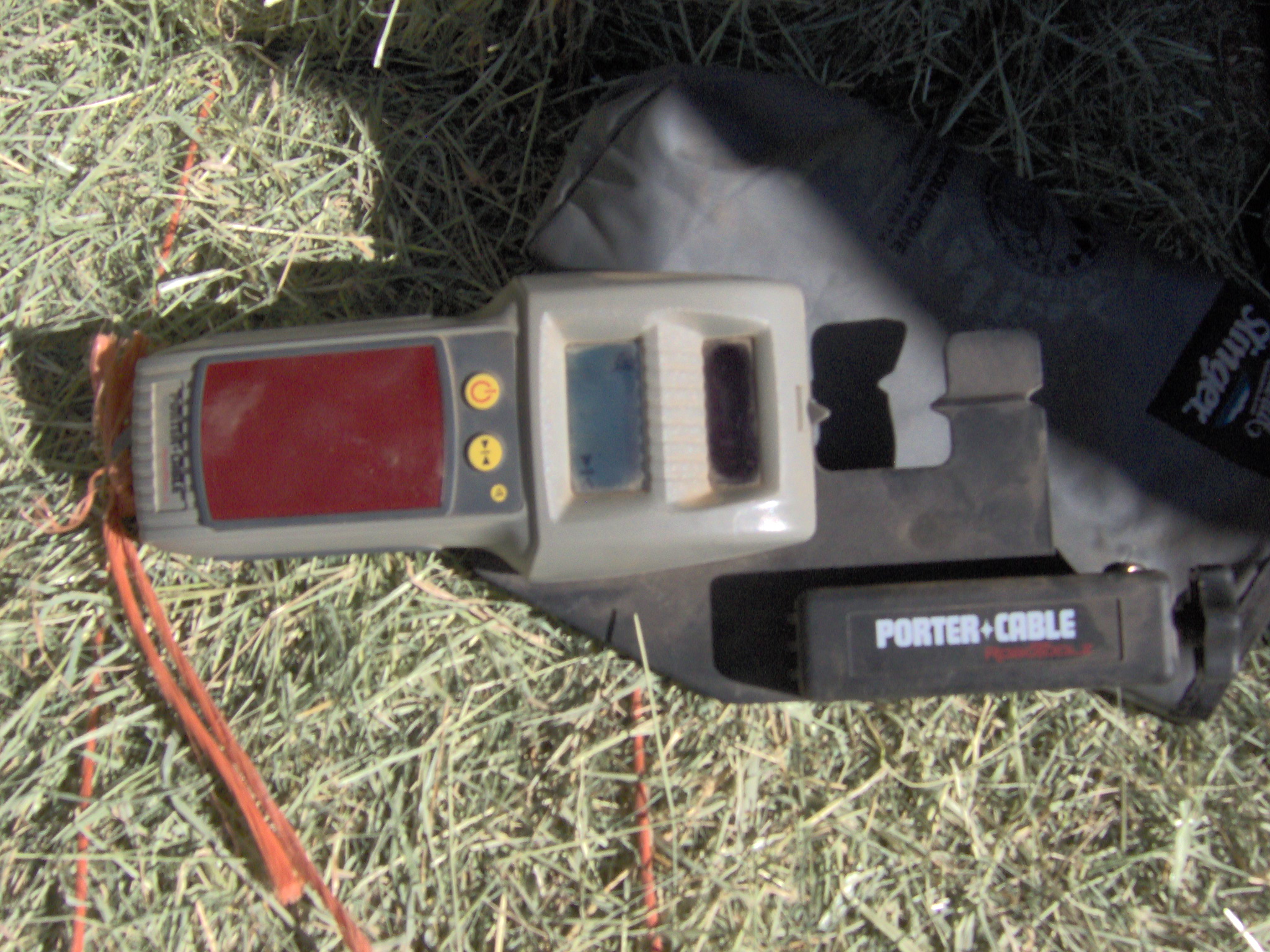

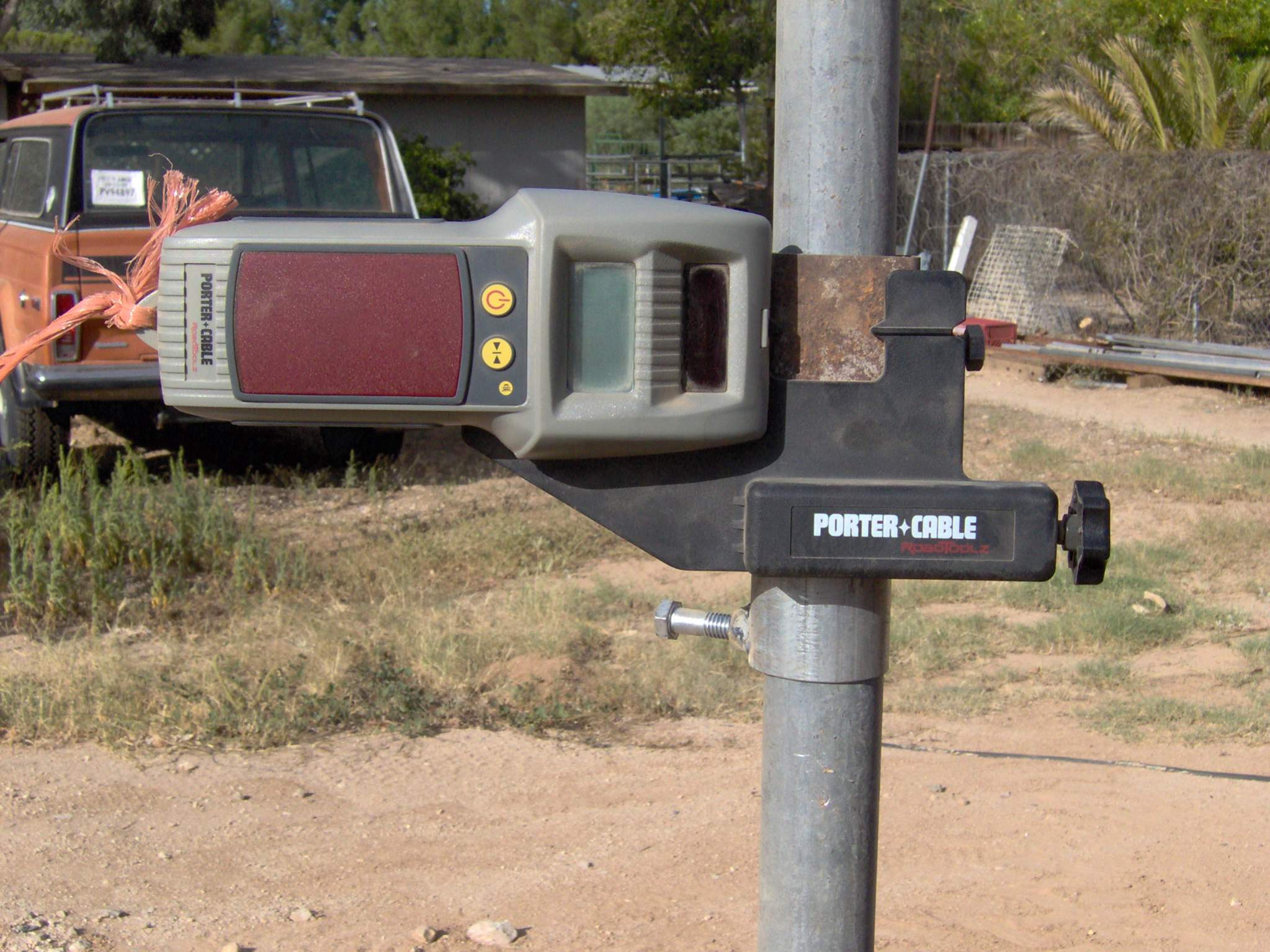

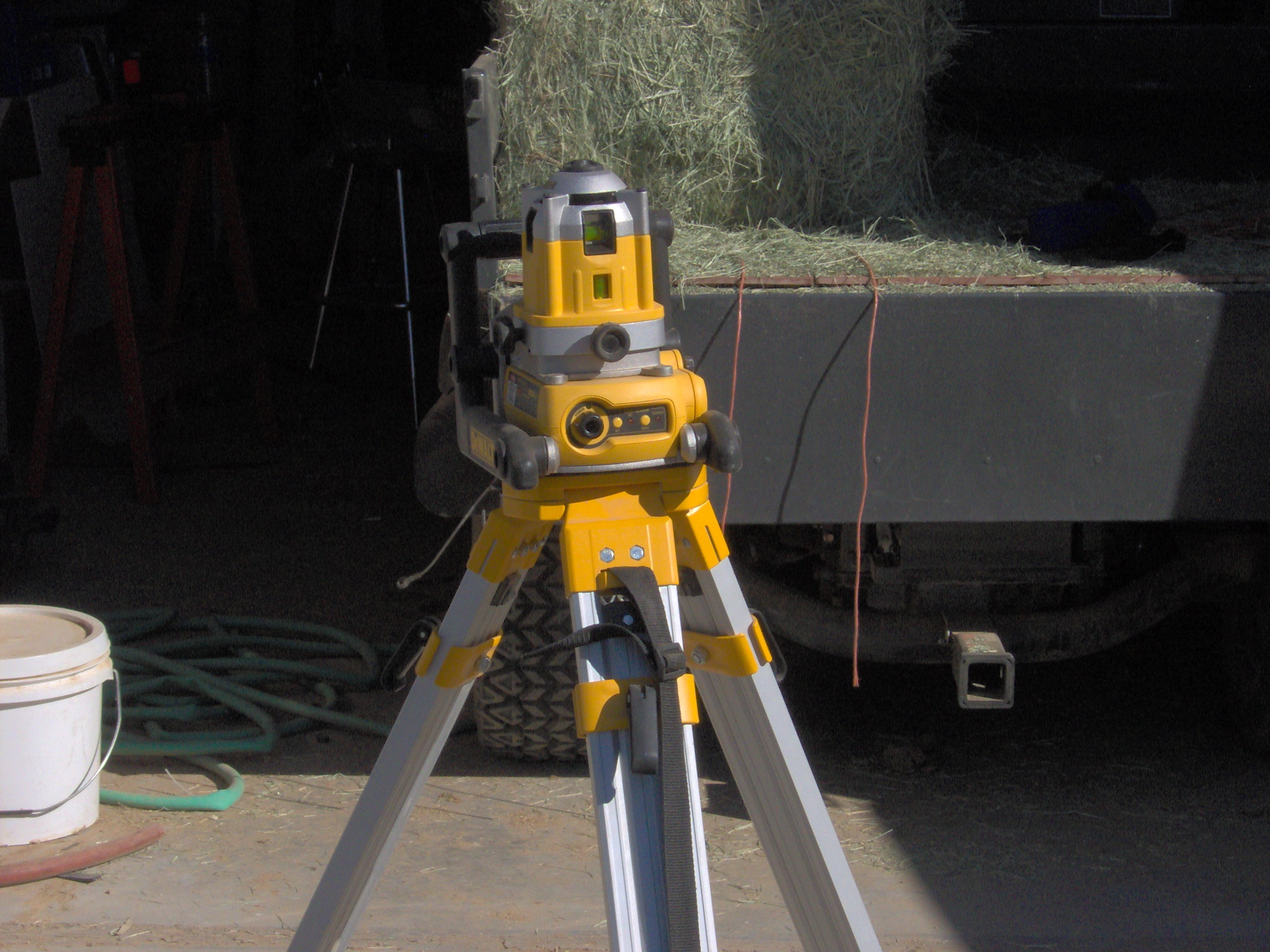

The laser is a Dewalt DW071 manual leveling and the detecor is RT-A1650.

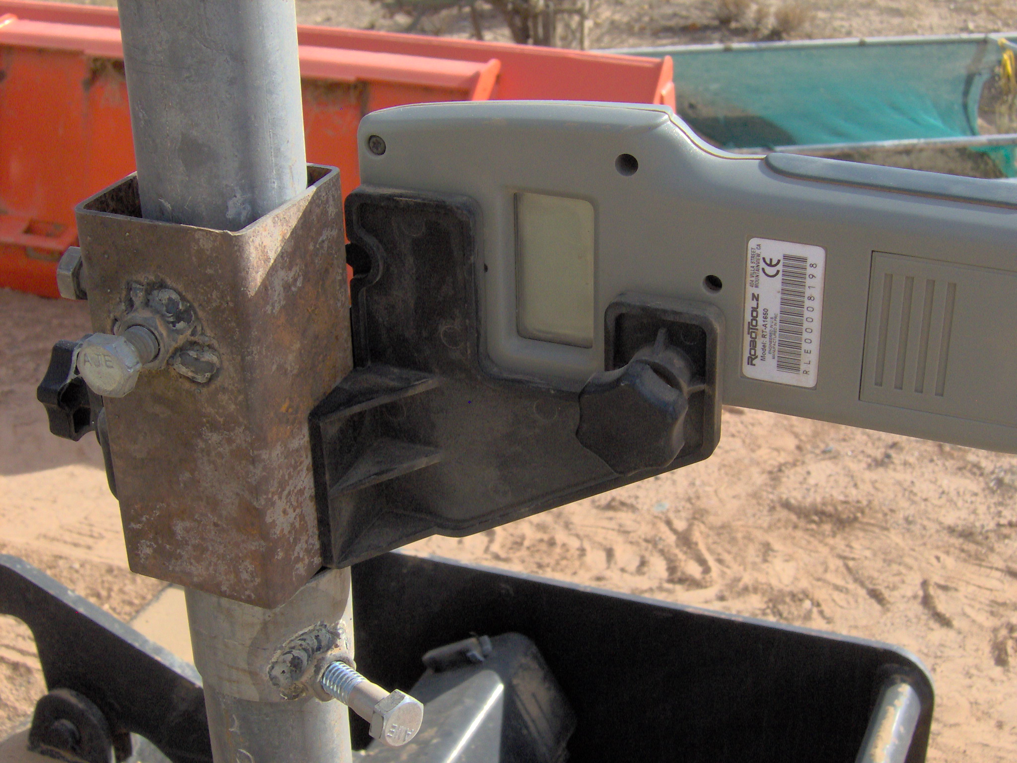

I built a simple mount out of 2 6" c-clamps, and misc angle and pipe. The main pipe is sch 40 so that when I tighten the bolts i will not warp or dimple it. I then used a section of square tube and a piece of pipe that slides over the mast.
The detector is mounted on the square tube using the mount clamp supplied with the detector.
I first set the laser in the center of my field and leveled it.
I then used the detector mounted to a leveling rod and took a reading right by the laser. This became my 0 point. I then walked the field and found that 80% of the field was +8" to -6" and the remaining 20% being a corner that was -16".
The 20% section was eliminated for leveling right now because I will be bringing in dirt to build it up.
With the deviation being 14", I knew that I had to set the laser for a +1 reading.
Next, mounted the detector on the square tube and adjusted it so that the center mark of the detector was at the 0 reading measurement. I then lowered the detector 1" which would give me the +1" that I needed.
I then locked the detector in place with the 2 bolts. Then I butted up to the bottom of the square tube the round ring and tightened it.
This lower ring allows me to change the angle of the detector without having to remeasure it again.
The detector has a fine and course visual modes and allows for audio tones. The tones are loud enough to be heard over the tractor with the window open.
If you are high, the unit emits a rapid beeping, low a slow beeping and a continous tone at level.
All one does is drive in circles so that the detector is facing the laser and listen for the tones, adjusting the 3pt as required.
It does not take long to get the hang of the tones and it almost becomes automatic.

I forgot to ask. When your detector is mounted on the box blade what is the distance (inches?) up/down the detector can be above/below the beam and still get a reading? If it is only a couple of inches is it difficult to know if the detector is too high or too low without going back and physically raising the beam to see if you get a reading? Your vertical slide mount would make this easy enough but would require getting off the tractor. Maybe a lever mechanism could be set up to slide the detector up the mounting post from the seat (I don't have a cab) to "probe" for the beam. If you slid the detector up and did not get a beep you'd know you were still too high.
Your post mentions detector angle of 170 degrees but I don't know what that angle refers to. I presume that is 85 degrees horizontal from perpendicular to the detector?
Ray
Once the laser detector is set on the box blade, I get about +/- 8" from level in course mode and about +/- 4" in fine mode. I use the course mode for leveling.
From experiance using this setup, if the tone was emitting a high signal (rapid beeping) and then drops out, I just lower the box blade and it comes back into signal range and vice versa.
Once you have set the detector to grade requirement, you do not want to move it. Just raise or lower the box blade. The only time that I would reset the position of the detector is if the angle of reception is too great. That is why I have the lower collar on my rod. It allows me to change the reciver angle without losing my grade setting.
The 170 degree is the reception angle from the laser, 85 degrees left or right from center.
On a side note, I did some research on my laser and noticed that I can turn it to shoot a verical line. So if I can rotate it 90 degrees, one would assume that it would operate at any angle in between.
That being said, if one were to place a sub-base under the laser that angled in x-y axis, then you could set a compound angle with the laser.
Just a thought
Peter
