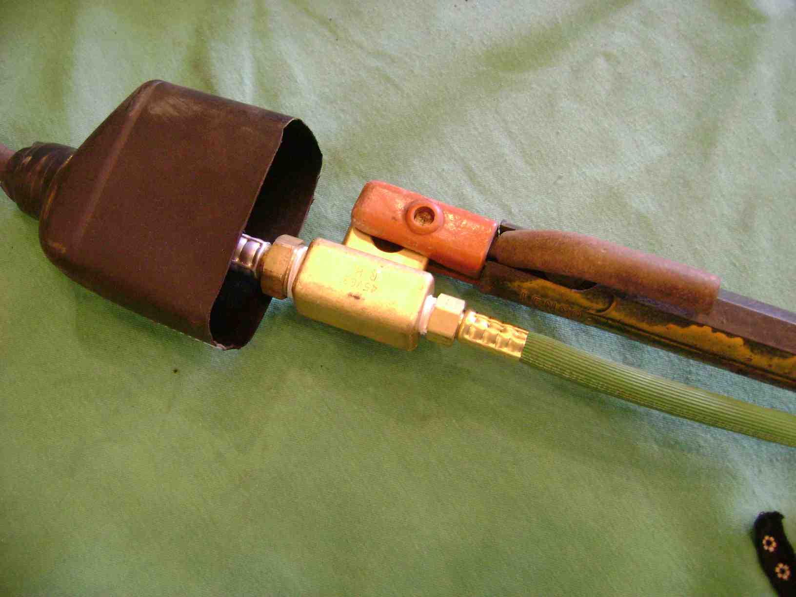

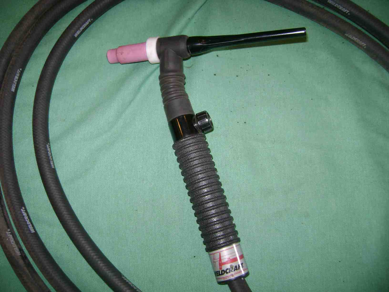

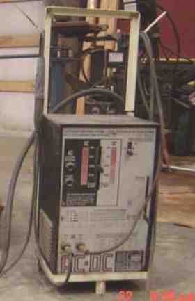

I didn't see a foot pedal with that machine. Not that you need one, but it does make life easier. If it were me I'd buy a Tig rig, flow meter, bottle, and a used buzz box off Craigs list first.
I used this buzz box for years to Tig weld with.

Well it boils down to how much risk you willing to accept? Normally I would no way but since you already have over half the money in HF bucks well then it might be worth a gamble but do realize it is a gamble. HF does usually offer extended warranties for additional monies. I do think this unit would be slightly better than the 115 unit stick machine that you are currently using but that is not really saying much. Assuming it comes with a manual valve tig torch then that part is always worth $50 or so and it could be transferred to another power source if the HF power source craps out.
Likely this HF 230 volt input 130 amp output unit is somewhat similar to the stripped down versions (no dual voltage) of the Longevity 140 and the Everlast 140. While the Longevity and Everlast do carry 5 year warranties which may seem like a good warranty deal on the surface, but is it really? With the Everlast and Longevity warranties you pay the shipping both ways when problems are encountered. In this case likely $70 or so to return it to the importer and then another $70 or so for the importer to return it to you. Who wants to pay $140 or so in shipping on a roughly $200 unit when problems are encountered. Any way you slice it consider it a disposable unit as you will not be able to fix it when something breaks. And something will break. You tell me what is the longest that a desktop computer, or laptop computer has lasted you? If you reach that with a cheapo welder full of ciruitboards then you did good.
If you want the safe bet, buy a used 230 volt AC/DC buzzbox of craigslist (bulletproof). Use your HF bucks on something else. I actually like HF for some things but their welders are not one of them usually.
PS: Try some 5/64 6013 with your current little 115 volt 70 amp crapbox. I have a similar crapbox only 50 amp fixed output. It will burn 5/64" 6013 and 1/16" 7014 and that is it. I actually hate 1/16" diameter rods but ease of 7014 makes them somewhat tolerable. For this little unit I actually prefer the 5/64" 6013. That said, you are pushing your little crap box way too hard if you are melting smoking wires. The 115 volt stick welders are not really made for building large projects as they have way low duty cycle. Consider it more a quick repair type unit and you will have better luck with it as they can easily handle a quick repair assuming repair is within their amp capabilities. Course I also have a Miller Thunderbolt AC225/DC150 buzzbox so my little 50 amp crapbox rarely gets used but I do use it for giggles occasionally.
