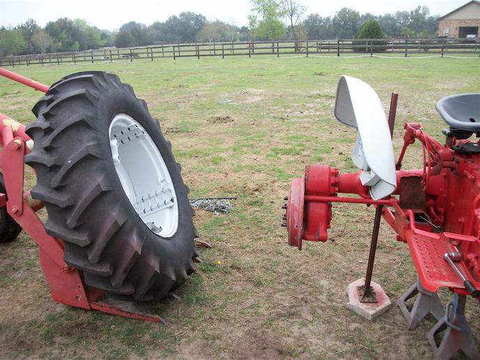

All kidding aside, I wonder how that would work, to bring a tractor up to the side with forks, grab it and back up, set it aside and grab the other one. Couldn't do it in the garage, it would have to be out in the open with room to maneuver. Seems like it would still be dicey to keep that tire upright with the forks under the middle of it. I think the flop-over factor would be huge. Unless you put the forks together and picked it up from the inside of the wheel. Anyone ever done that?
   / Handling Filled Tires #48

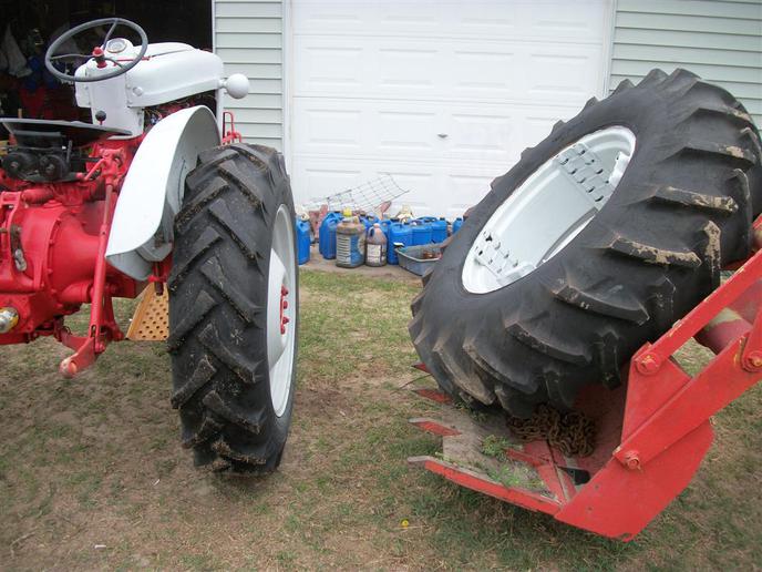

i've used a tractor with a loader to shuttle tires right up to the hub and then use a prybar to walk it off the loader bucket and lean against the hub
   / Handling Filled Tires #49
i had to swap some tires off this rowcrop and put new ones on ( ouch$$ ) on some different ones after some rim repair and a new brake drum... loader cam in handy.
