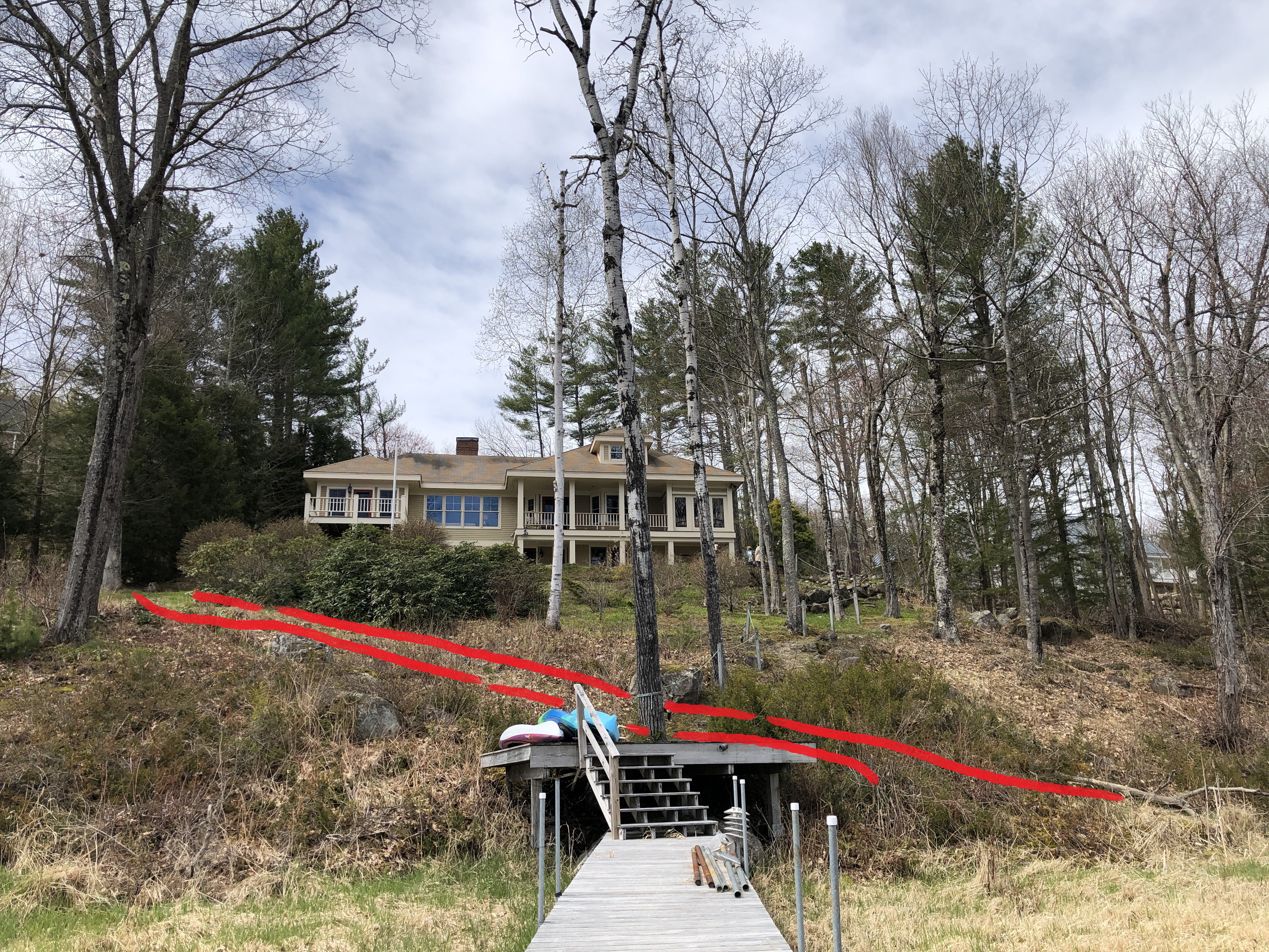

If it were my property, I would not be able to resist carving in a tractor-able "road" down to the dock. IE, bench-cut in a sloping path. A tooth bar on your loader bucket and a sturdy box blade should be able to get the job done.
Hard to tell from the pic if there enough room between the big tree and the boulder to carve a path through like so:

Thats a great idea. Ideally I want to put some sort of switch back path in. Gentle enough for an electric golf cart. And maybe still wide enough for the tractor. There are some nice properties near by that have done that. Probably cost a fortune and a lot of permits. But that is a ways in the future. But I like how you took advantage of all that width.

I've done lots of hillside work and cuts with Kubota tractors but I've also paid for someone else with the proper (Tilting blade) dozer, excavators to do some side hill cuts so I can use them with my tractors and RTVs. A tracked dozer can safely cut a flat path/road/drive across a hillside in short and safe order and how much is body and or machine damage worth.

There are strict rules near water edge (especially first 50ft). I cant even cut a tree without a permit and its doubtful they would grant it.

Permits aside... I think you could cut a path with a switch back or two. I have a steeper slope and have done pretty much exactly that with my BX25D and a Piranha tooth bar on the bucket. I will try to dig up some photos and post later.
Without a tilting boxblade or backblade it is difficult to cut the proper angled path across the slide slop unless you also mess with backhoe. I assume you don't have that on the back of your tractor. Also the switchbacks take a lot of room unless you don't mind a Y turn to negotiate it. I have one turn that I can go around without using reverse but it results in a steep section, and the other requires a Y turn.

This has to be the best solution for you along with burning near the water. You have the B2320DT, it's your property, I'm not understanding the permits, permissions, etc. What purpose is having your tractor if you can't use it? Who's going to complain?
If you grade it nice, maybe put stone down, you have great access walking, taking a small boat down, etc.

Your dock looks like it is on a marsh, how about a picture of where you want to get to.

I only want to get down to that first large landing area. The long skinny dock does go over some soft ground. I dont plan to put tractor on that.
