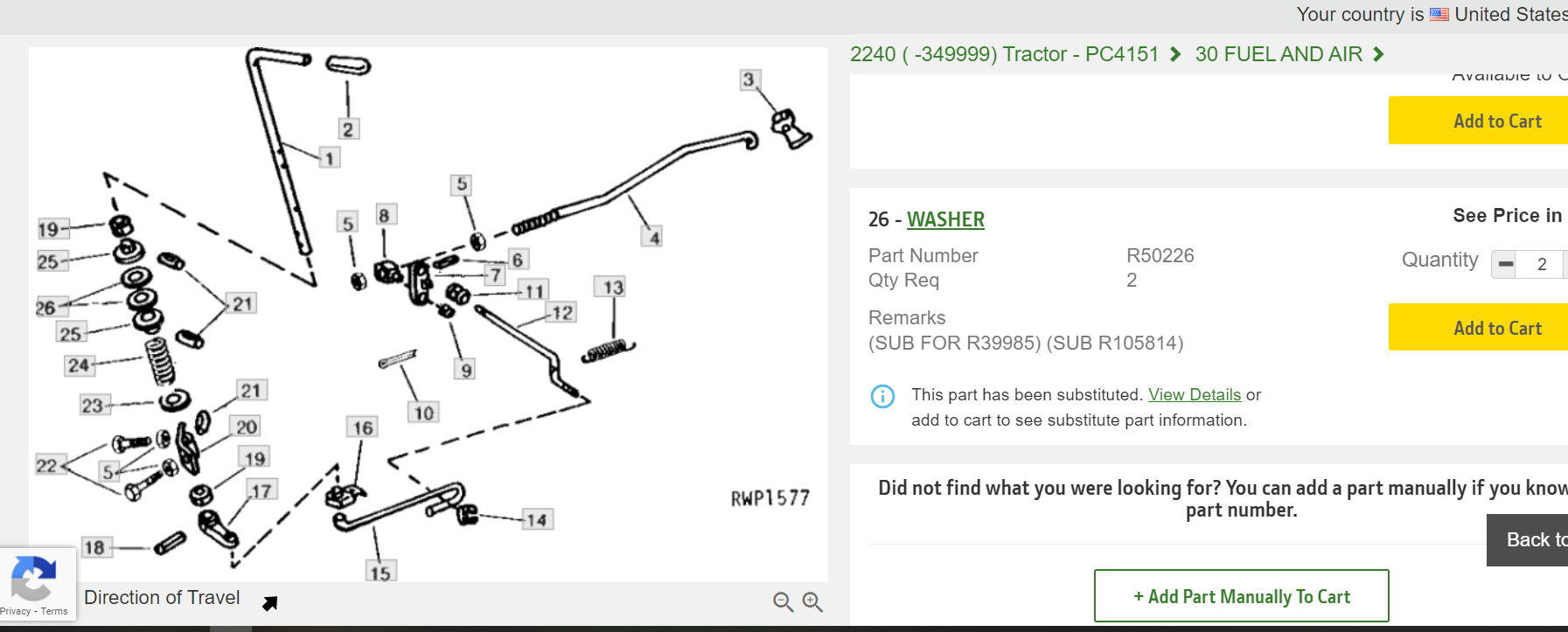

My 2240 hand throttle won't hold it's position, Does the spring just need replacing.
/ Hand throttle #2
Maybe someone oiled the friction disk or washers.
Remove it and clean all oil off, and if not oily then get a new spring.
/ Hand throttle #3
The fitting under the spring corrod and then stuck to the shaft. Then the spring can not do it s work.
Strip and clean...replace the clutchplates.
/ Hand throttle #4
Ditto what DLTrekkers & beenthere stated. Removing those groove pins(item 21) while linkage is in place under dash panel is required. Friction washers are $12 each

/ Hand throttle #5
Yep, what everyone is saying. Those hand throttles are maintenance pigs. I have to take mine apart, clean, and adjust it at least once every 30 or 40 years. ...
It's likely to take almost an hour to do it right if I just sort of pick at it while cleaning the shop and lubing the front axle.
But just like all one hour jobs it takes longer - especially if I am doing it again because I forgot a part the first time. But it's one of those things that works so well when you get done that it's a pleasure.
