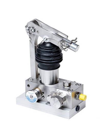

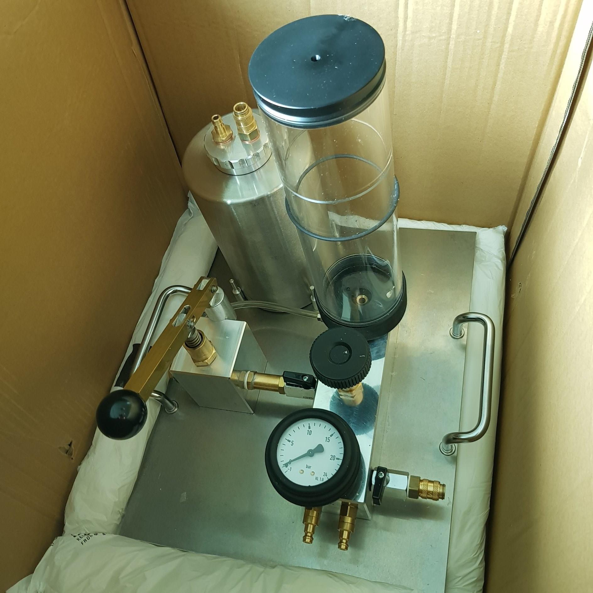

Need to build a DRC charging kit.
Basically just need a hydraulic hand pump that can get up to 20bar without introducing any air in the system at all.
This is the device I need to make
If anyone has any other suggestions on what kinda of pump and manifold I need would be much appreciated

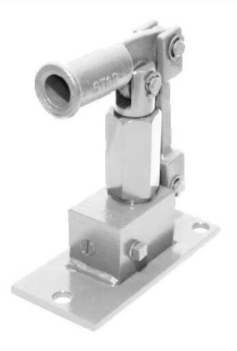

Closes I can get to a pump are these types

You can get a hand pump for cartridge valve cavities. HydraForce (HP10-21 or HP16-21), Bucher (CMHP-10), etc. ISZ

   / Hand Pump suggestions #5
Check out McMaster Carr, they have all kinds of options for hand pumps. Stay away from the Portopower types those are rated for 10,000 psi and not made the same quality as the one pictured above.
   / Hand Pump suggestions #6
Manual Pump for Leak Testing and Calibration, Portable, for Water and Hydraulic Fluid, 363 PSI
McMaster-Carr
20 bar would be 294 psi, so this would work.
