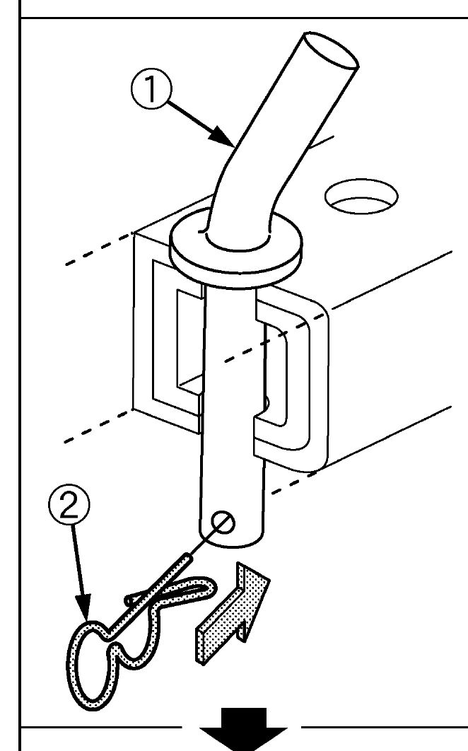

Part number and where to buy
THANKS

That type is available at pretty much any farm type store and a few other places. Not sure the extra kick in your diagram is necessary.

Looking for the twist lock Kubota, look on messicks found a part number but pic was old style pin.
/ Hairpin Cotter for Stabilizer #5
Don't use cotter pins on those particular pins.

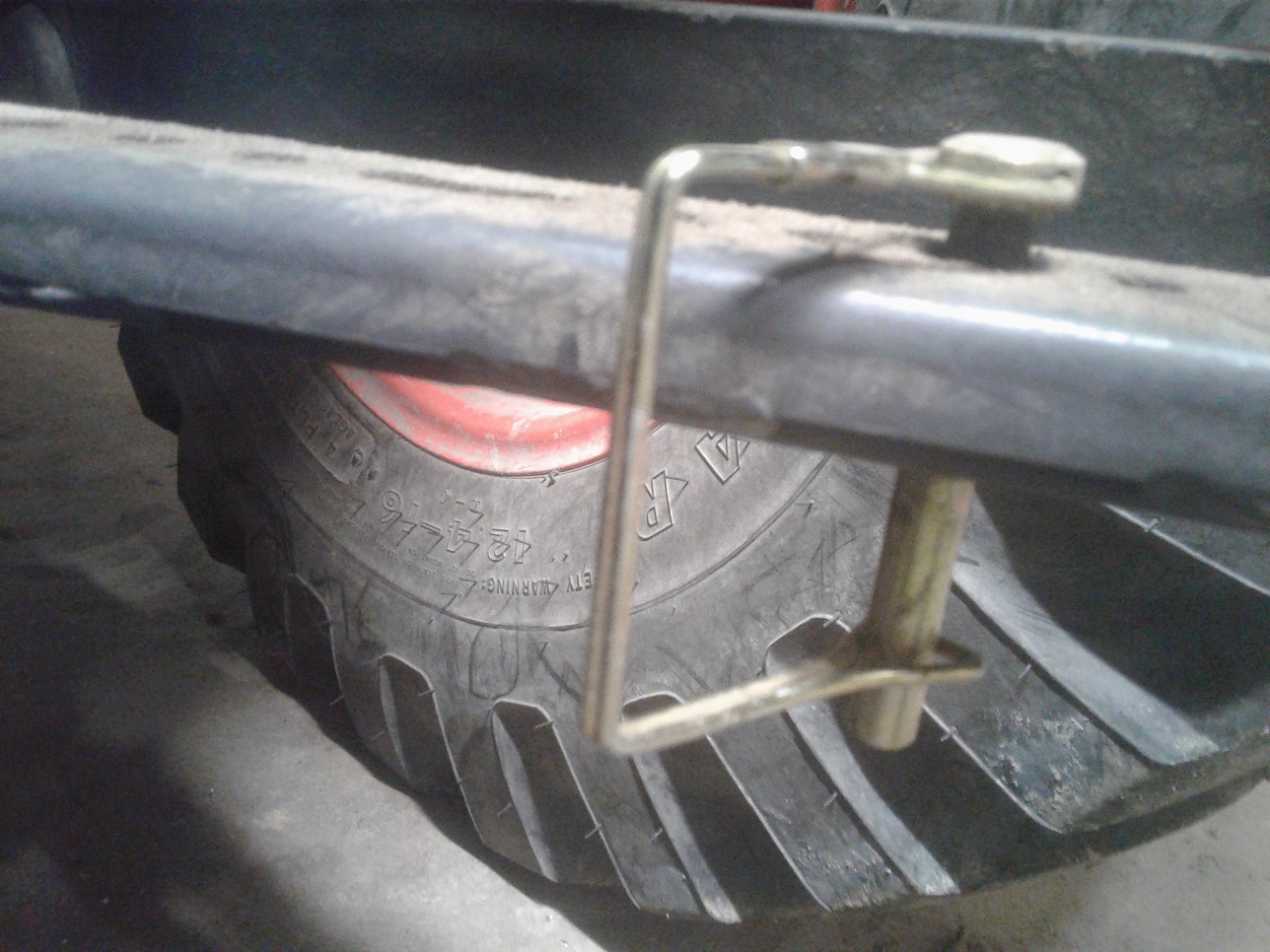

I've had good results with these.

If I'm not mistaken you are showing the hairpins that lock the lynch pins on your 3-point stabilizer arms. I use hairpins at that location and have narry lost one. Now - go down lower, where your 3-point arms attach to the rear differential housing or whatever. I've lost a few at this location. I now use high carbon bolts and Nylock nuts.
After all the searching and finally using these bolts & nuts. The neighbor takes a pair of pliers and makes a 45 degree bend in the final inch of the straight leg of the hairpin. Like me - his only reason for removing the 3-point arms would be to repair damage.
