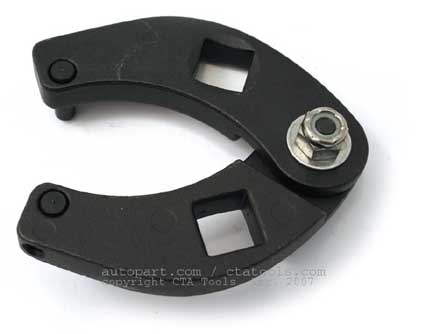

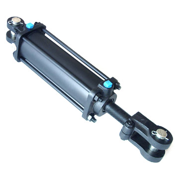

One type of hydraulic cylinder uses a "tie rod" design. It has three or four long bolts (tie rods) running the length of the cylinder (on the outside of the cylinder where they are plainly visible) holding end-plates onto the cylinder.
It's pretty obvious how to open those, so I'm guessing your cylinder has a "gland nut" (keep your mind out of the gutter!) on the end that the rod (I said, keep your mind out of the gutter) extends from. The gland nut has two holes in it. A special wrench spans around the rod and has pins that fit into those holes. I found one for sale in a local business that caters to industrial folks but sells to individuals too. I just now found one on the net for $16.22 + shipping, pictured below. The website is (as of 08/08/2007)
Auto Parts and Automotive Tools
Note the square hole for inserting a ratchet or breaker bar.

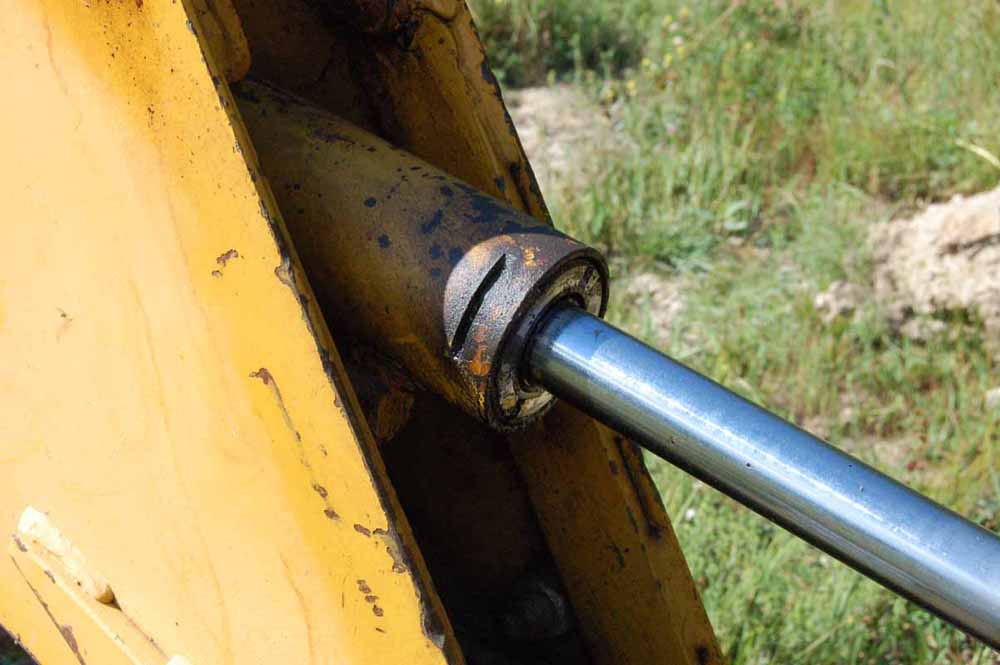

Thanks, Bud. The cylinder is 3" but quite ling. There are no obvious nuts on it but there is a slit near the end. What kind of tool do I need for it and what kind of motion do I do? Are there any pictures of the cylinder to look at? Once I see one open I'll be able to figure out how to do it.

The slit is for accessing the retaining ring. You need a spanner wrench to turn the gland nut CCW until you can see the end of the ring. Pry the end of the ring out then continue to turn the nut. Once the ring is removed, pulling on the rod end will allow the rod assembly to be removed from the cylinder.
/ H Cylinder Repair
Here is the picture of the Bradco cylinder to repair.

I finally got to disassembling the cylinder. I got the gland nut wrench as you guys recommended, works great, and removed the retainer ring inside. Now I can not remove the gland nut. Any tricks to use to remove it, or do I just use a brute force? I do not want to mess up the piston.

at work we have air cylinders that have the side grove in cylinder.
were you able to spin the the end of the cylinder?
If so spin it again slowly and look in the slot on side of cylinder there might be a wire type lock ring in there.
Spin it slowly and look for a gap in ring if you find it then pry out one end of wire out gently and spin rod end of cylinder and it might spiral out, some times you might have to pull on wire with a pair of vice grips as you are spinning it.

The cylinder end would not spin but I can spin the gland nut. The nut moved out a little just so the ring groove in the slit disapeared towards the end but I can not grasp the nut, it is not out enough. The nut seems to be made out of aluminum or something soft, it gets scored easy when I try to grasp it with wide pliers. The gland nut has no handle to grab so I do not know if I can just pull the rod out with force (what force). I will see if there is a groove inside the cylinder end.

OK, guys, I got the cylinder apart. There was nothing special about it. I went to a pro shop and asked. They told me to knock it out using a hammer. So I did and the piston pulled the top out. I undone the piston nut and removed all the seals. There are eight of them on the piston and the gland nut. Now I do not know how to order the new seals. There is a rebuild kit mentioned in the Bradco manual but I can not find even the model on the net. So I am looking through the H/D catalog and can not make sense of it. I am not sure how to measure the seals and O-rings when the are worn out or damaged while removing. I guess I need a lot of help.
