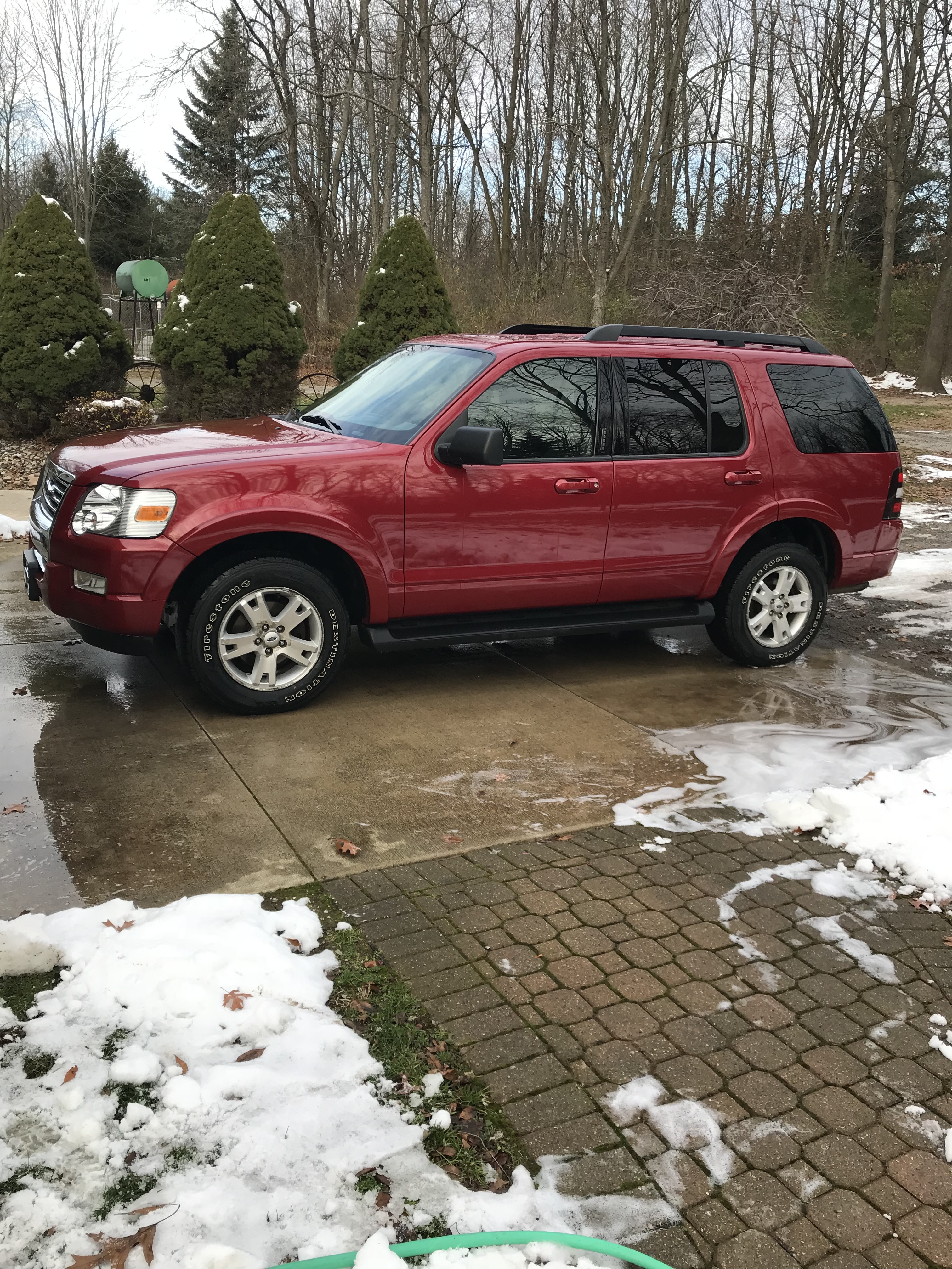

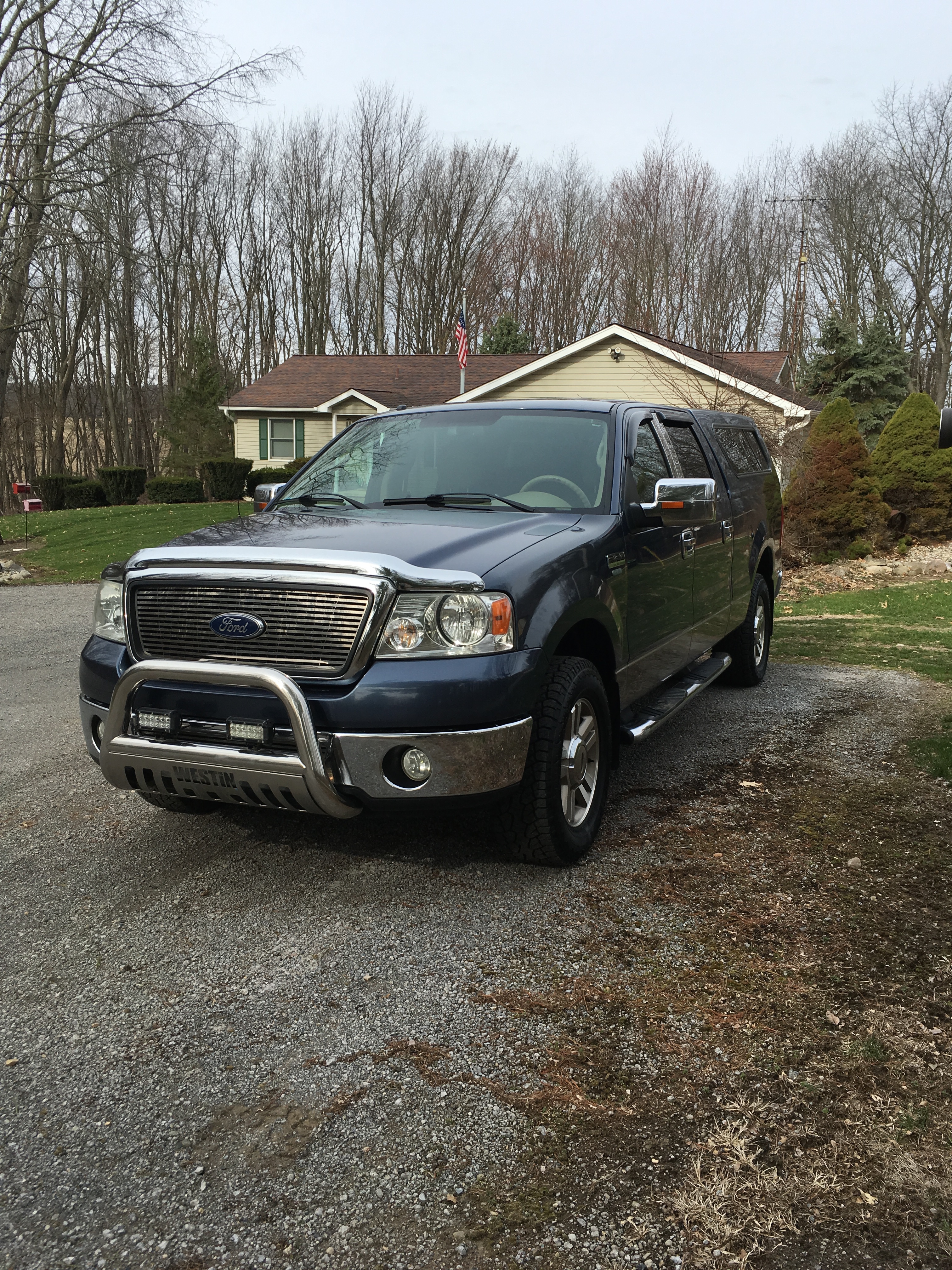

I have always used the Walmart brand full synthetic oil in my beater trucks with no issues.I also use Wix XP oil filters.
