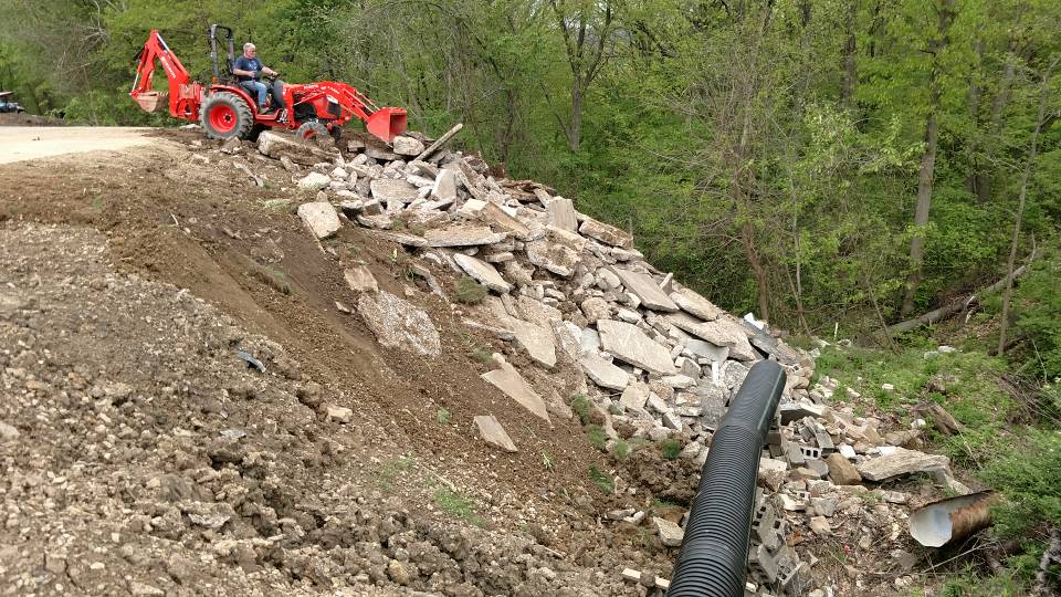

Almost identical to my setup/needs. Ford 8n/2-WD didn't give up on me though - I gave up on it. Slipped out of gear and ran down my hills one time too many!
I looked at lots of manufacturers and ended up with a Branson 3725 hst. Ran a spreadsheet with all the specs and Branson was the clear winner for me. I put at tires on it and spread the rest wheels. I didn't fill the tires.
Used the loader all weekend with 5' bush hog for ballast.
Bush hogging was so much faster and less stress than with the 8n.
Safe hillside operation requires four wheel drive (4-WD). Tractors have brakes only on the rear wheels. When going down hill, tractor weight distribution shifts forward, decreasing rear tire grip. With 4-WD engaged tractor feigns four wheel braking. Without 4-WD engaged, on a steep slope, an uncontrolled descent may occur.

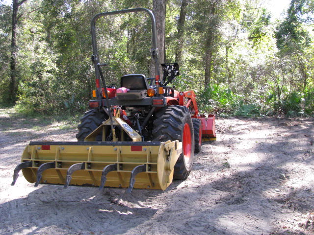

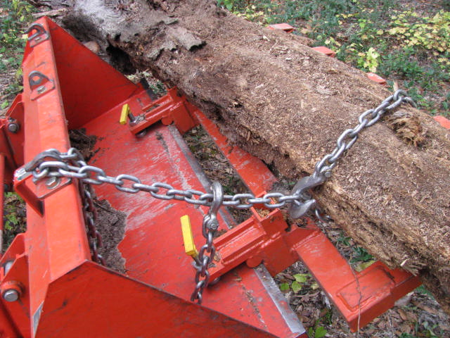

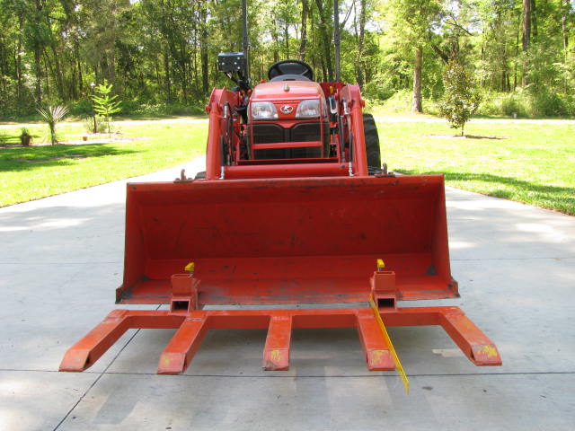

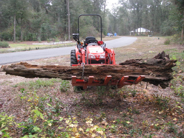

It was not a B3350SU. It was a B3300SUHSDP. Tires inflated with air. I run over irrigated lawns in an upscale, rural residential community every operating day.
