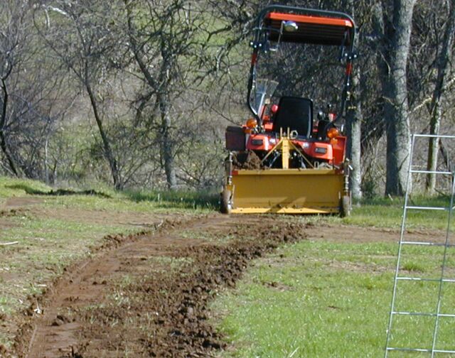

HomeBrew2 said:
THAT is very clever!!! I really like the rake ... I find a curved-tine rake to be too aggressive many times. Also, looks as though the float might function as a "hula" hoe for those sparse but prolific dry summer weeds!
Here is a picture of the rake in the operational position for pushing( it will flost back when going forward so you can use your blade to cover holes or level where brush was removed. If you desire not to get a sore neck then it can be taken off and installed on the inside of the box blade and it still folds up out of the way for normal blade use. It really keeps the dirt out of your brush or weeds.
I can just hear those brains cranking out ideas.;)

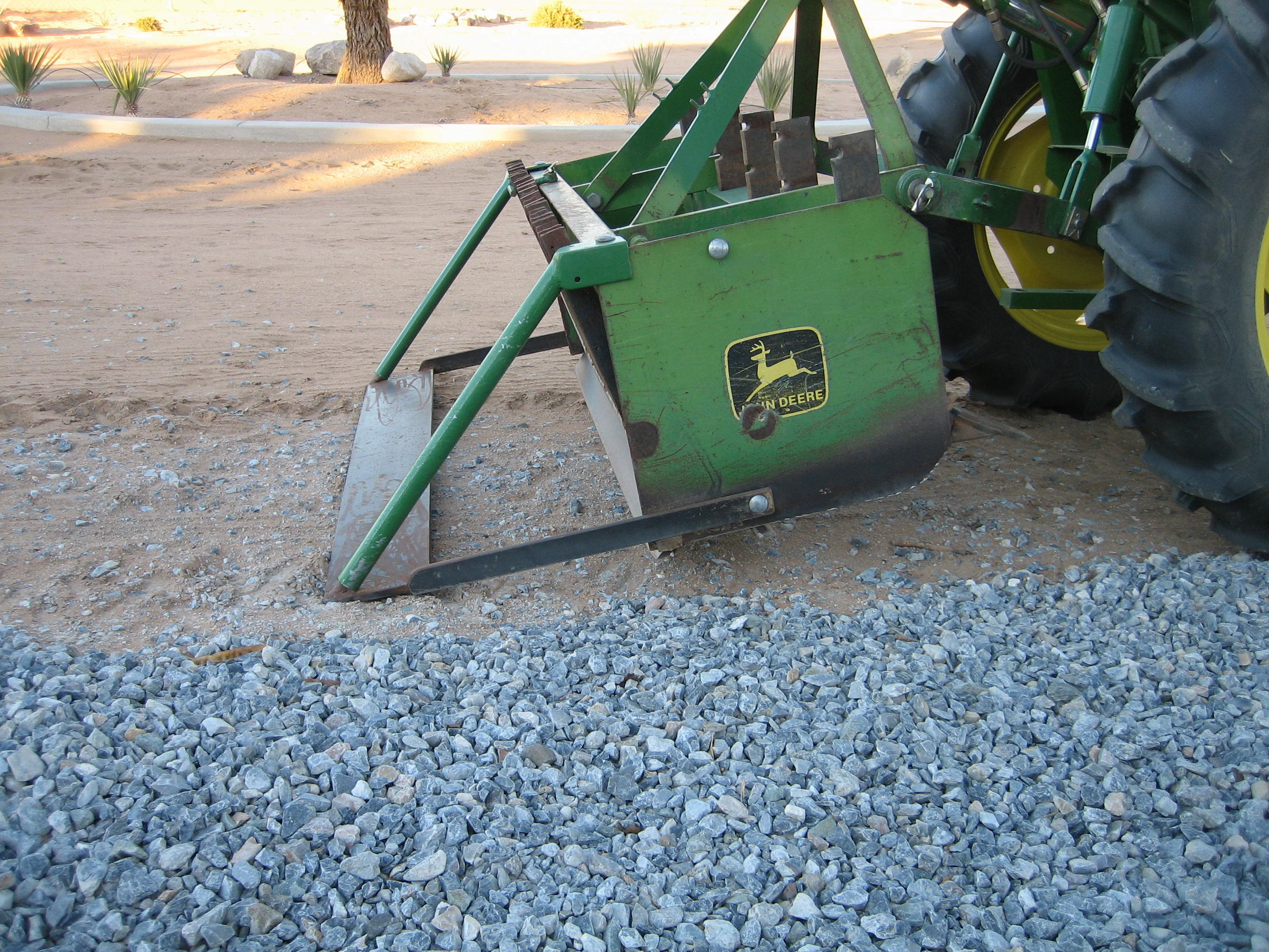

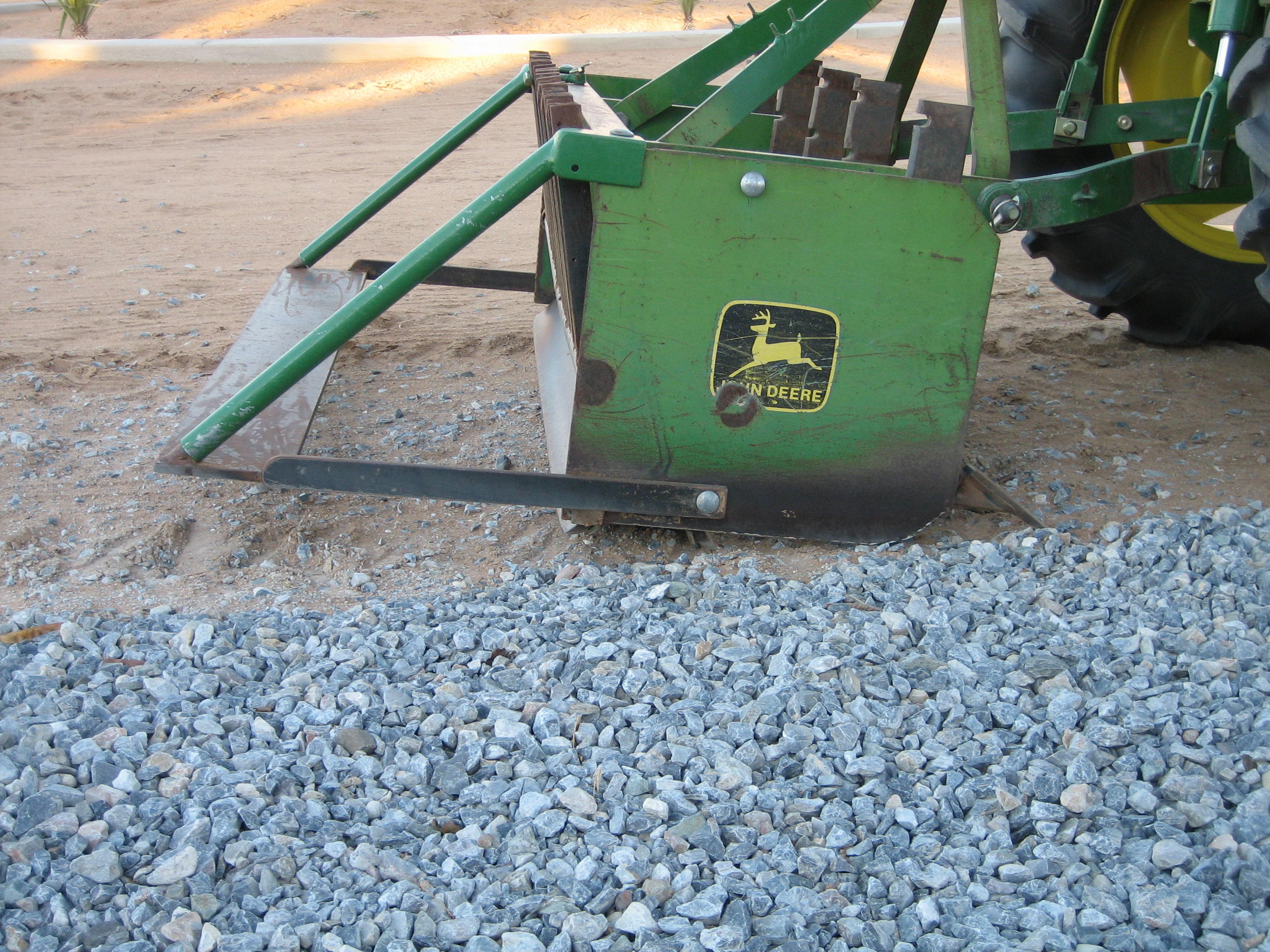

mfrost said:
here is another idea. works great in sandy soil and it also keeps the back blade functional for pushing dirt. It also helps in compaction and no moving parts or flat tires.:D
I see the sand, where is the soil? ;) ;)
So are you in Eastern San Diego county, Imperial county, or where? Looks mighty arid!
