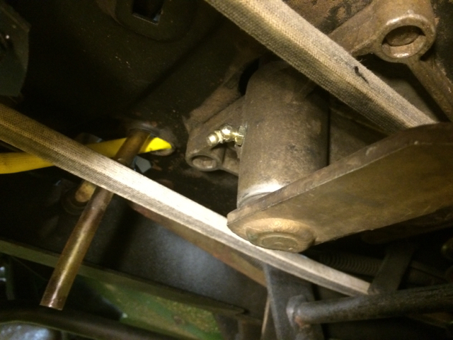

Here is the one on the draglink shaft housing. I used a 6mm 45degree zerk to keep the hole small. I get into the project and forget to photograph it when it's open and easy

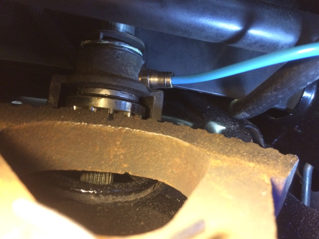

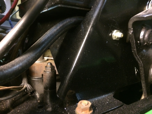

It looks like I can only post one pic per posts. Here is the remote zerk I mounted for the steering wheel shaft lower bushings.
/ GT275 steering
Here is the 6mm push connect line fitting installed at the lower bushings that connect to the remote zerk.

Thanks for the pics. Just a caution, as being the grease points are easy to grease now, over-greasing may be your worst enemy. The one in the vicinity of the belts looks particularly vulnerable.
But good idea to ward off future seizure.

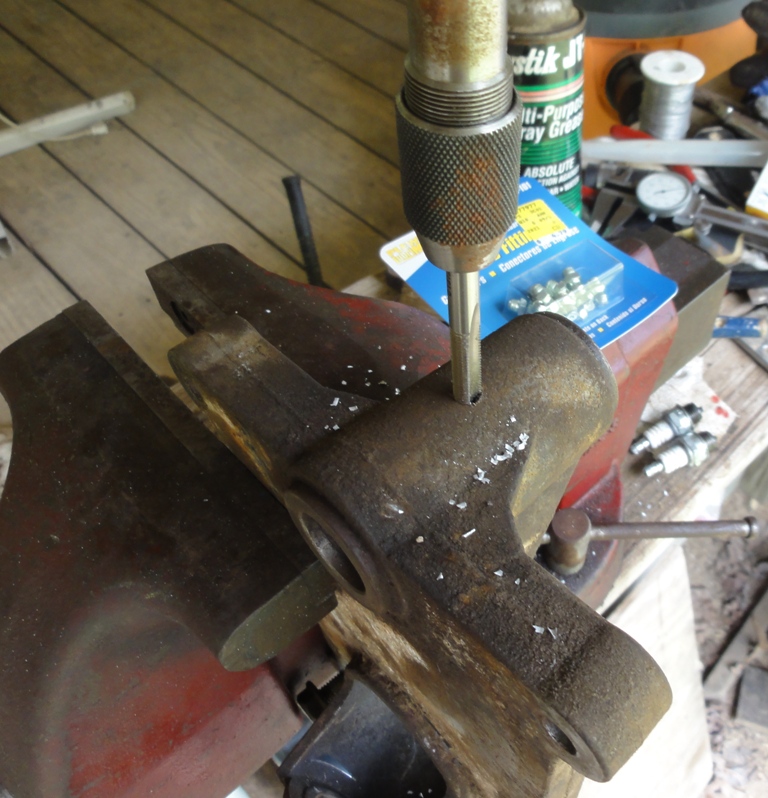

I think several of the mowers could use grease fittings on portions of the steering sector.:thumbsup:
This is on a LX188 and I suppose they think the grease impregnated brass bushings are sufficient.
I put a grease fitting on two of my mowers.
This is in between 2 of the brass bushings.
It fairly easy to drill & tap IF you have it all apart. Getting this off is not so easy...
