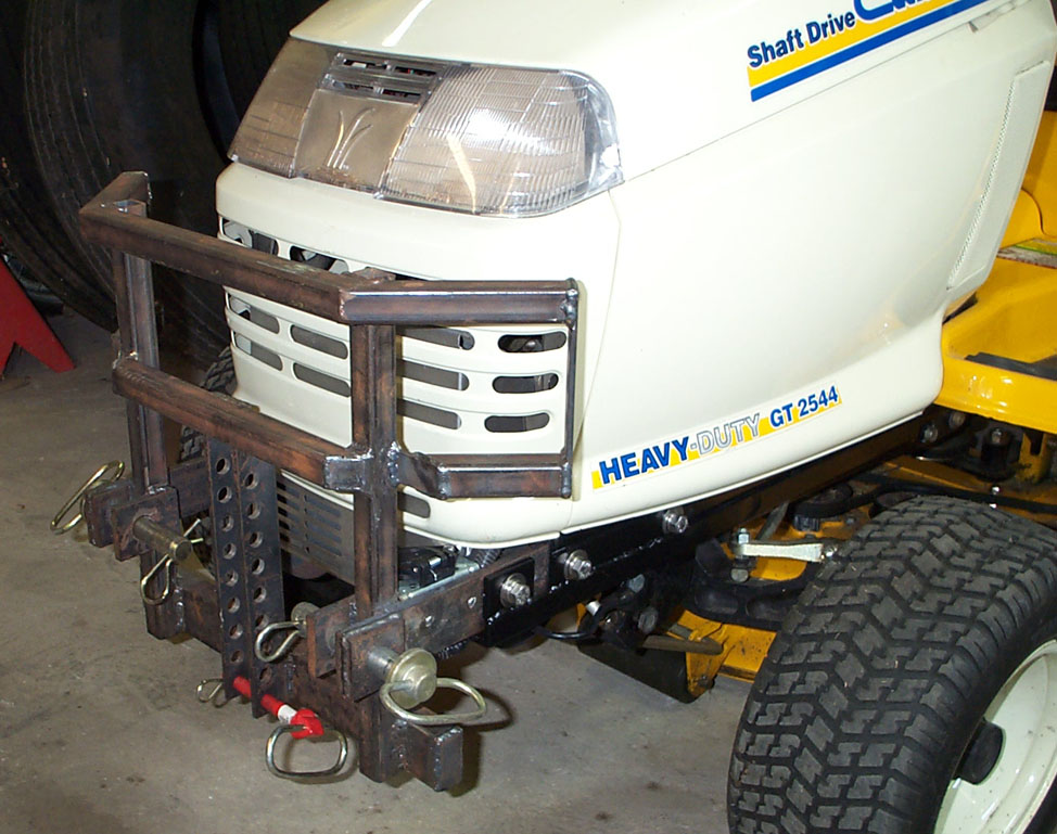

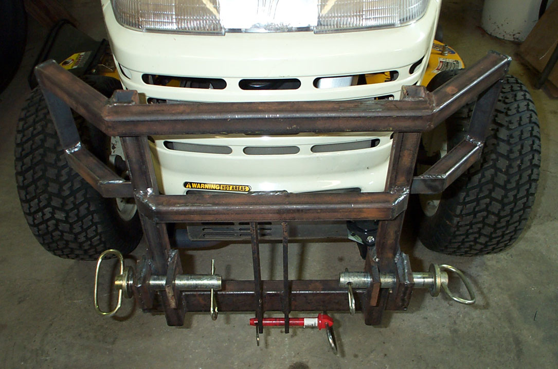

Well, finished modifying my front gaurd, let me know what you think. I personally liked the way it looked before, but I had to make some clearance for the actuators. Time to paint... :rolleyes: Got it blasted and primed today, hopefully it'll be yellow by tomorrow afternoon.
You'll see later why I had to make clearance when I post some more pics of the whole project. You can also see how the 3rd mounting bolt fits in one of these pics. That main 2" bar is 3/8" thick, I'll break the CC in half before bending that stuff. I tend to err on the overkill side. :eek:
