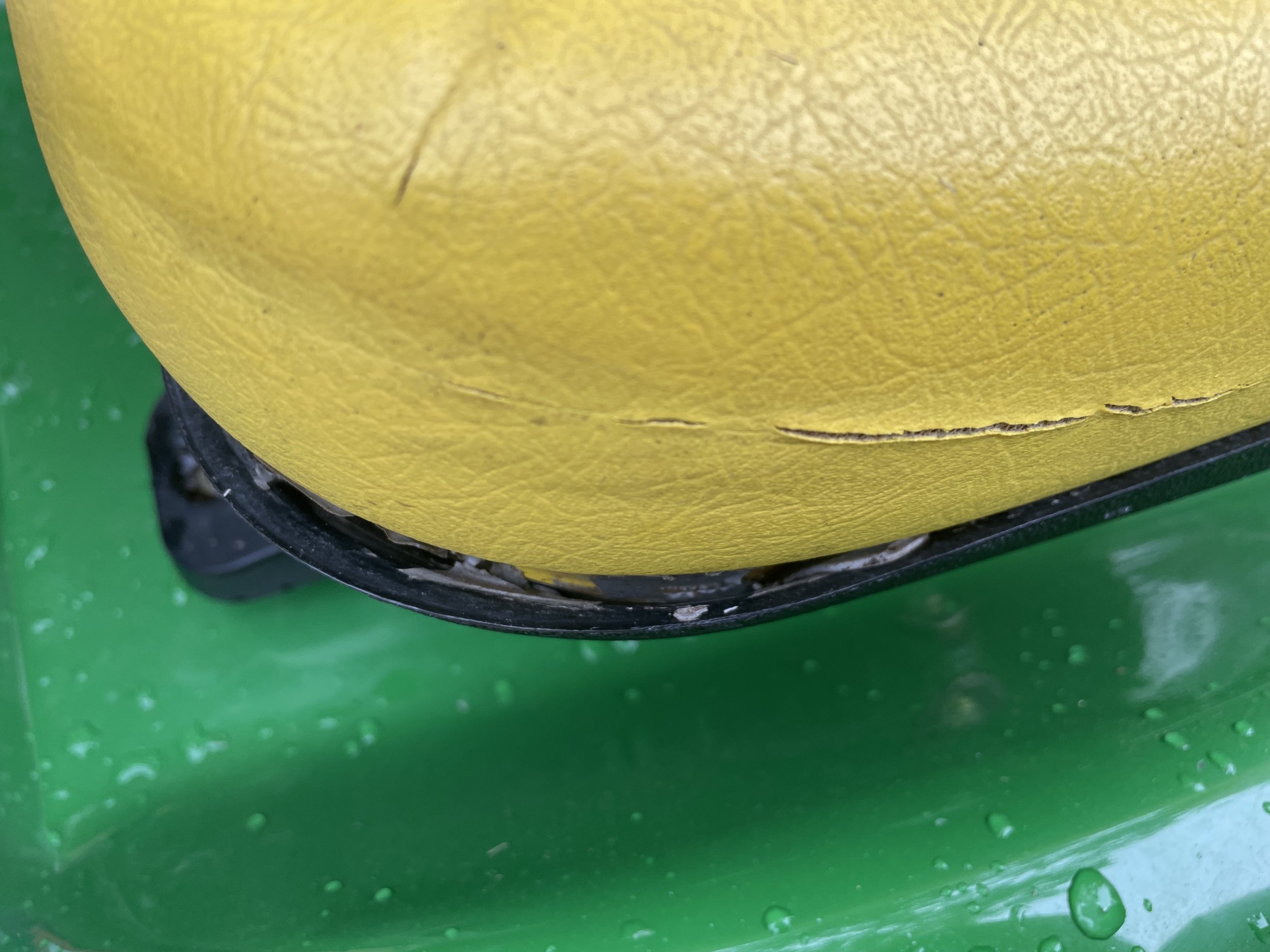

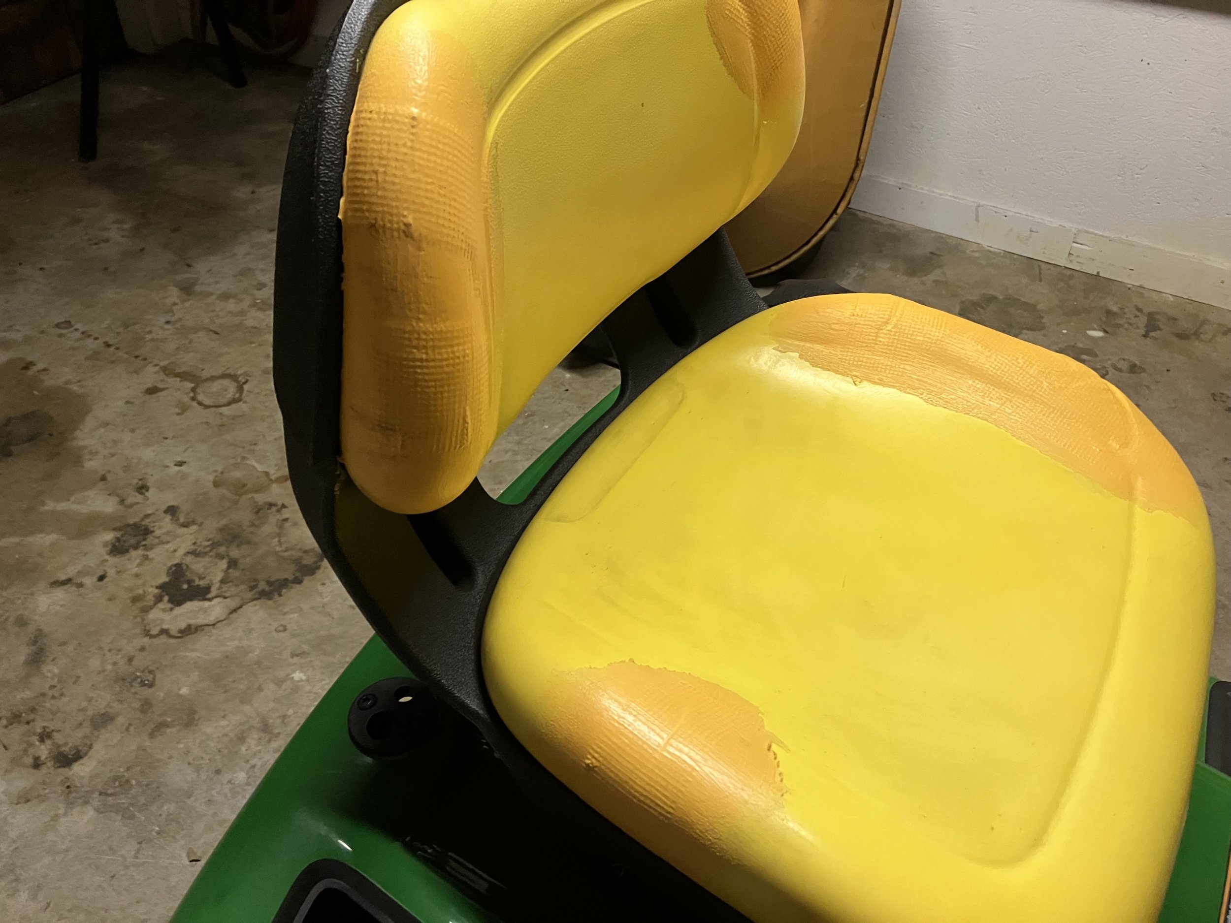

What are you guys using to patch small rips/tears?

A seat cover.
/ GT Seat Repair #4
No "repair" that I am aware of. Only replace the seat. (or put a cover over it).

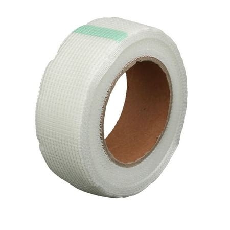

I repaired the seat on my JD rider with Plasti Dip. It worked so good. It’s the stuff you dip your plier handles in and stuff. First I got some of the mesh you would use for sheet rock that has adhesive on it. I put that on the tear then coated with the Plasti Dip. I let it dry and put on 4 or 5 coats. It worked very well.

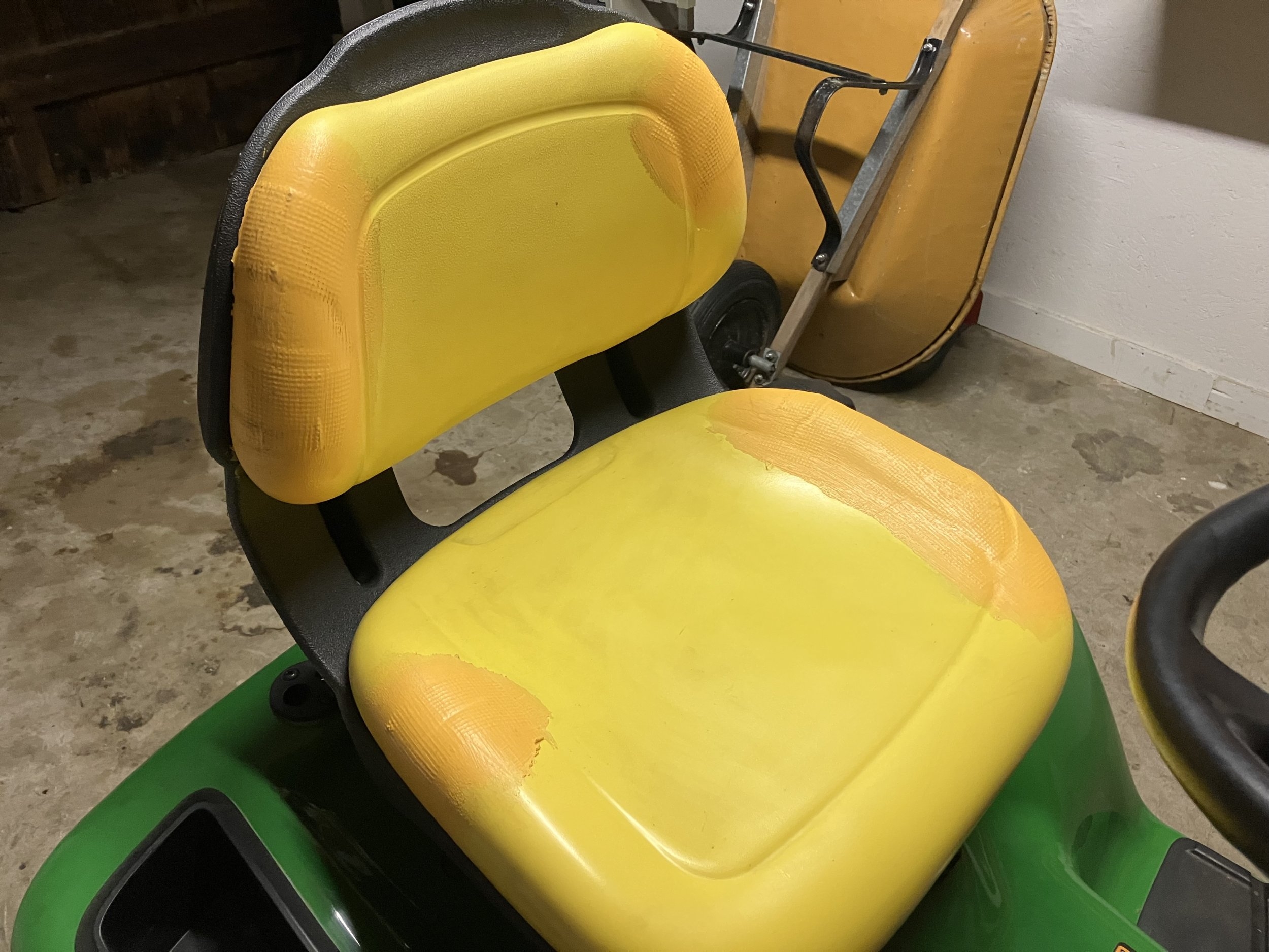

Please post some pics of this repair so we can see the good results that you have.

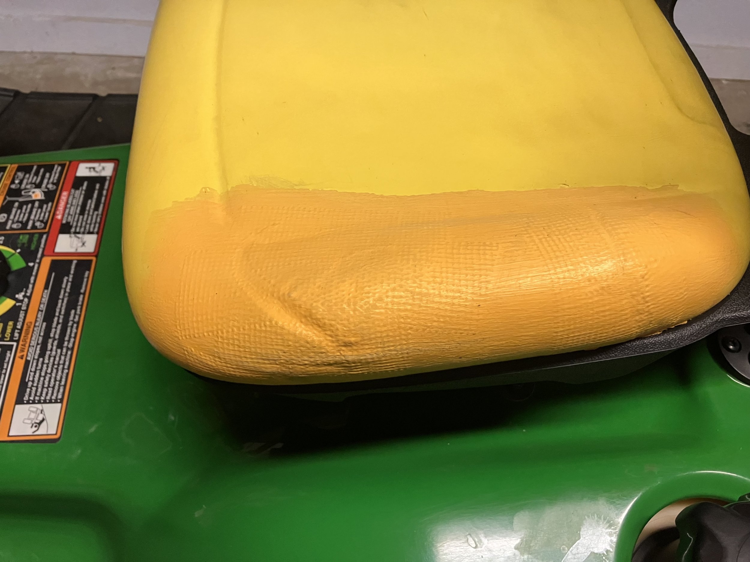

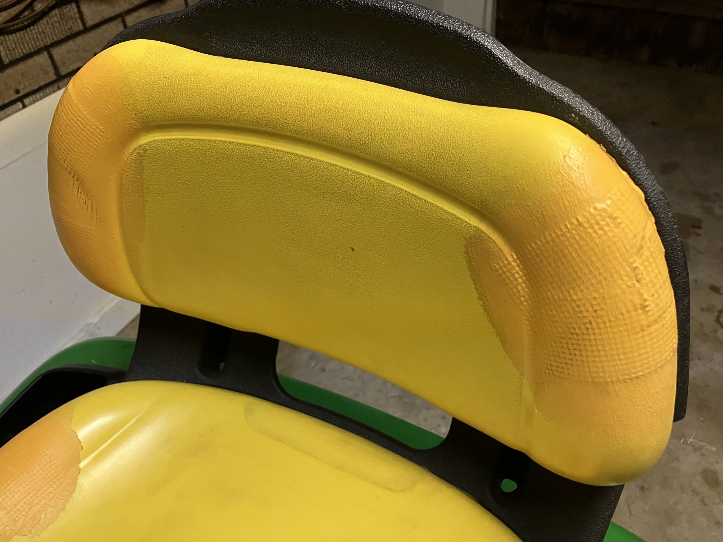

I all those repairs were done a year ago. The mower is 13 years old. The mesh is needed to keep the tears together before applying the Plasti Dip. Apply a coat, let it dry, apply another, etc.
/ GT Seat Repair #14
Very respectable-looking repairs. Thank you for the pics and the method used.
