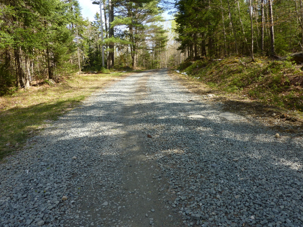

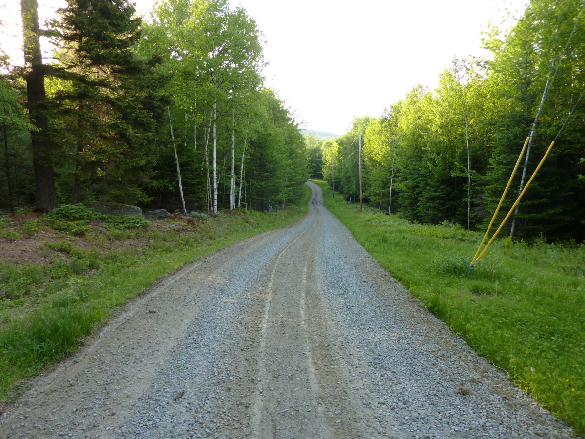

It depends on what you mean by serious work. If you need to recrown or change the pitch for drainage its not the tool to use. If the general contour of the road is ok but you have wash board, shallow wheel ruts, or pot holes then they work very well. On mine if we have a bad mud season I use my rear blade first to get the crown and drainage pitches reset then I use the grader plane afterwards and for the rest of the year. Here is a before and after pic of a section of my road. They're not a real good example but they are the only before and after pictures I have. This section is still pretty primitve. No proper road material at all except some crushed stone that I put in the mud ruts one spring before it dried up. I went over it with just the grader. Maybe this will give you an idea. But you really need to try one. The other important thing the grader does is it remixes the surface material so it is just like it has been resurfaced.

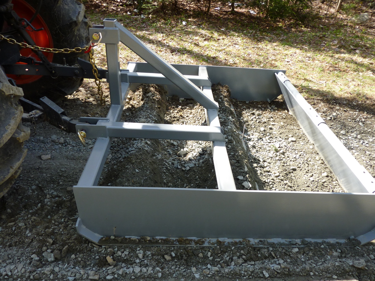

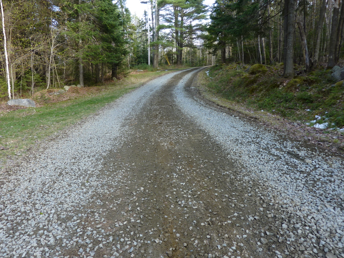

Not rude at all. But Don't forget eveybody has different needs and priorities. Your right it is not a boxblade replacement. It is specialized to make it very easy and quick to create flat planer surfaces from grassy, lumpy, bumpy, pot holey, rutted ones. What may seem silly to you may make perfect sense to the next guy.
Different strokes for different folks.
