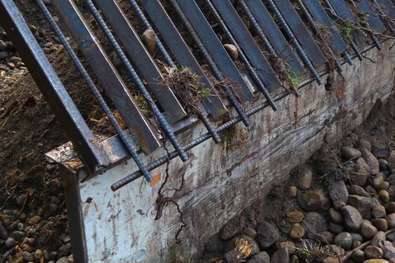

It's not everything that I wanted it to be, but it is doing the job.
My wife thought maybe I was avoiding the work and welding instead :)

I don't think I have major changes to make.
This is based more on that it is working and I don't want to sink any money into the project.
I used angle iron spaced about 1 3/4 I still plan on the smaller screen that lays on top. My brother in law has the material. just a matter of time.
I think rebar could be made to work. Just allow for a greater than 45 degree angle to clear occasionally.
My slotted verticals hold the chain that adjusts the angle. Lifting the high end increases the angle. I can do this with the bucket while working.
I used cheap 1 inch square tube to hold the verticles while welding. It's still there and I use it to lift and move the rig.
Sure it bends a bit but were are talking tractors and rocks. the bucket slides up the grizzly and rig hangs well for moving.
I keep it low (real low) if traveling much of a distance.
I think that it works very good for my purpose. Sod sucks and hangs up the material. But once it's out of the way, it clears well.
If I do get sod hanging up, I either scrape the grizzly with the bucket, or toss some of them by hand.
If I chop the sod into smaller pieces with the bucket, I don't have as much as a problem.
What doesn't show well in the picture is that I have 2 sheets of OSB, faced with plywood, backed by a front lip frame to use as a backstop for the bucket clearing the rocks. I did not have this when I first tried it and went right back up to the shop and fixed this.
A separator and backstop is a must.
I'll post more. Once the chill leaves the air, I am going to get back out there today.

Yes, it's definitely doing the job. I have abused it quite a bit already, and all the weld's continue to hold.
My (2) BIL's and I discussed some changes we might make based on some free stuff I might get from them :)
I definitely need to build my planned screens to reduce the pass-thru size.
Everythings was done with my WeldPak 125HD FluxCore. No new welder yet!

I have used it enough to determine a couple of design change. I'll try to post pics.
1. Stronger Top Bar. This was originally to hold it square while welding and I left it. It works great as a carry bar, but it's not up to the task. I also use it to shake the unit to clear sod and hung-up rocks.
2. Better lips to retain the OSB side boards. Right now they slide in and are held in place by friction. I have to re-install the same boards after they vibrate loose.
3. No need for angled feet to slide the unit, I just pick it up.
4. Add on screen to reduce pass size. Now that I have done about 30 yards, I think I have too many 1.5" rocks :( I still think multiple passes will be easier than trying to reduce it in one pass.

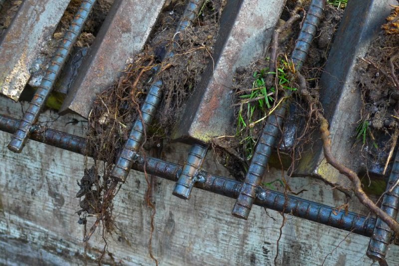

I tackled #4 above and created an add on screen to reduce the pass size.
Material is running low, so I tried Rebar attached to the 1" square tube.
I welded to vertical pins to the main frame that holds the tube from sliding down the tube.
It is also constrained from moving sideways.
At the bottom, I have a small pin that sets into the center angle bar to keep the bottom edge from sliding sideways.
Still working well, But I sure have a lot more rocks. (and smaller ones at that) to move out of the area.
Since the angle iron takes about 1/2 the force, rebar seems to work 'ok'. The slight flex of the rebar does make clearing stuck rocks easier than when he bigger rocks got jammed between the rigid angles.

I will continue to share my experience with my Grizzly.
On the main foot rail, just left of the angled feet, you can see the small angle iron used to retain the osb.
You can also see that the separator doesn't like it's pounding and needs a brace. Still works for now
New Item 5. Frame needs add'l support if I want this thing to last a long time. The frame side (now horizontal for maintenance) is a single angle and is carrying more of a load that I thought (my pounding mostly). Need to build a simple truss of rebar.

#13
Here are the pins to hold the rebar grill that reduces the pass size.
Two 1" square tube on the frame top. only one corner is shown
One 6" piece of rebar on the bottom center. slides into the angle on the main screen frame
rebar grill slides up, locking the bottom with the pin, then drops over the square pins on top.
Last photo shows the rocks out a couple of previously run material.
