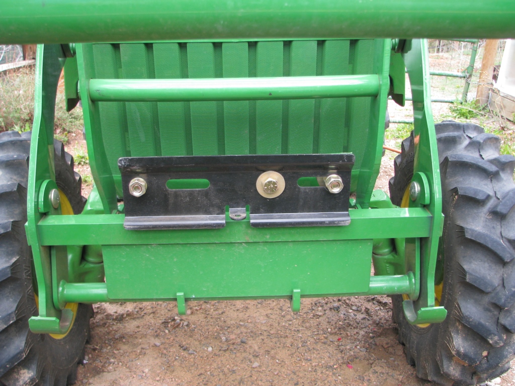

I've attached a few pictures of the grill guard on my 790 and the 300 loader. The loader has to be removed anyway so taking out two bolts isn't too much more work. In my case the tool box bracket would be in the way also. I think I will keep going in from the top unless I need to replace the battery.

A couple of pictures that show the weight bracket just below the bracket for the toolbox.

I was just surfing for tool boxes and saw this post. Figured I'd add what I just posted elsewhere on a hinged grille guard for my 790 with 70 loader. Also, had seen a tool box post that had a box mounted to a bar mounted between the ROPS uprights. I think this may be my only option for a tool box...the search continues......

/ Grill Guard on 790 #16
I need to remove two bolts (top ones) and the guard will pivot about 45% forward for battery maintenance or removal. I was hoping to incorporate a tool box here too (like Mech has) but I only have about 12" x 5" to work with....so it wouldn't hold many (MANLY) tools. ;)
