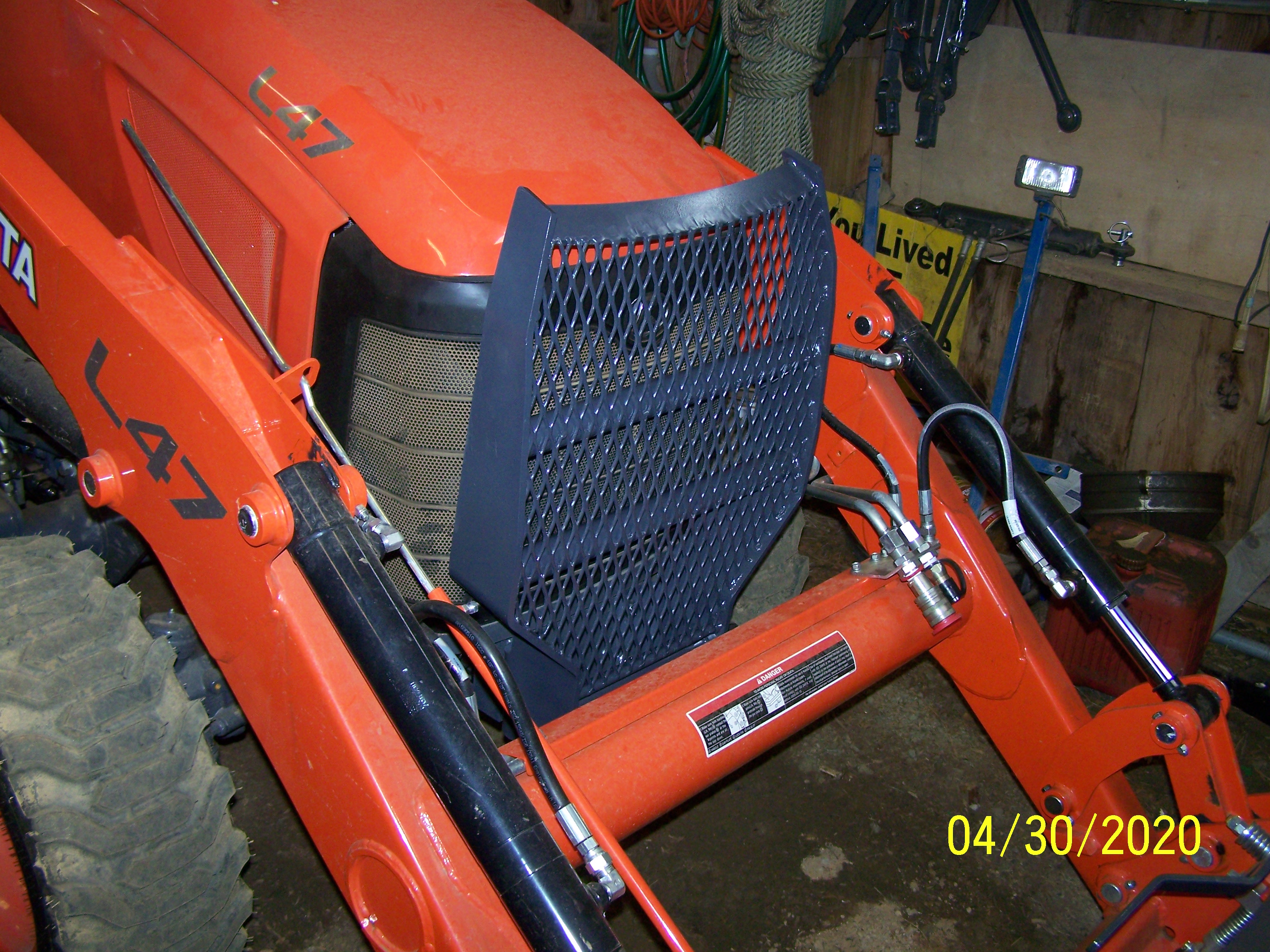

After almost driving a stick through my grill while grappling brush, I decided that my brush guard could use some improvement.
A few members posted photos of their machines and I basically borrowed ideas from them.
I used a 2ft sq. piece of 3/4x 9 ga expanded metal.

Ok. How did you weld it? MIG or stick. I need to do the same and would appreciate some suggested settings. I suck at welding, but it's on the short list.

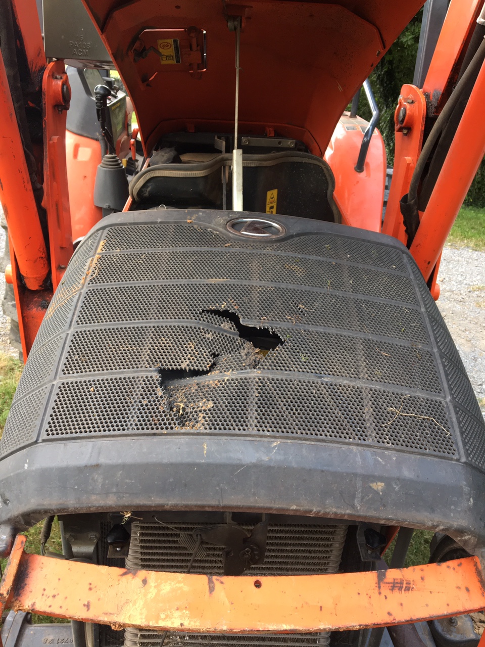

Routinely work trees and brush.
Didn’t ever see the stick that did the damage. Able to glue back together. Then made this.

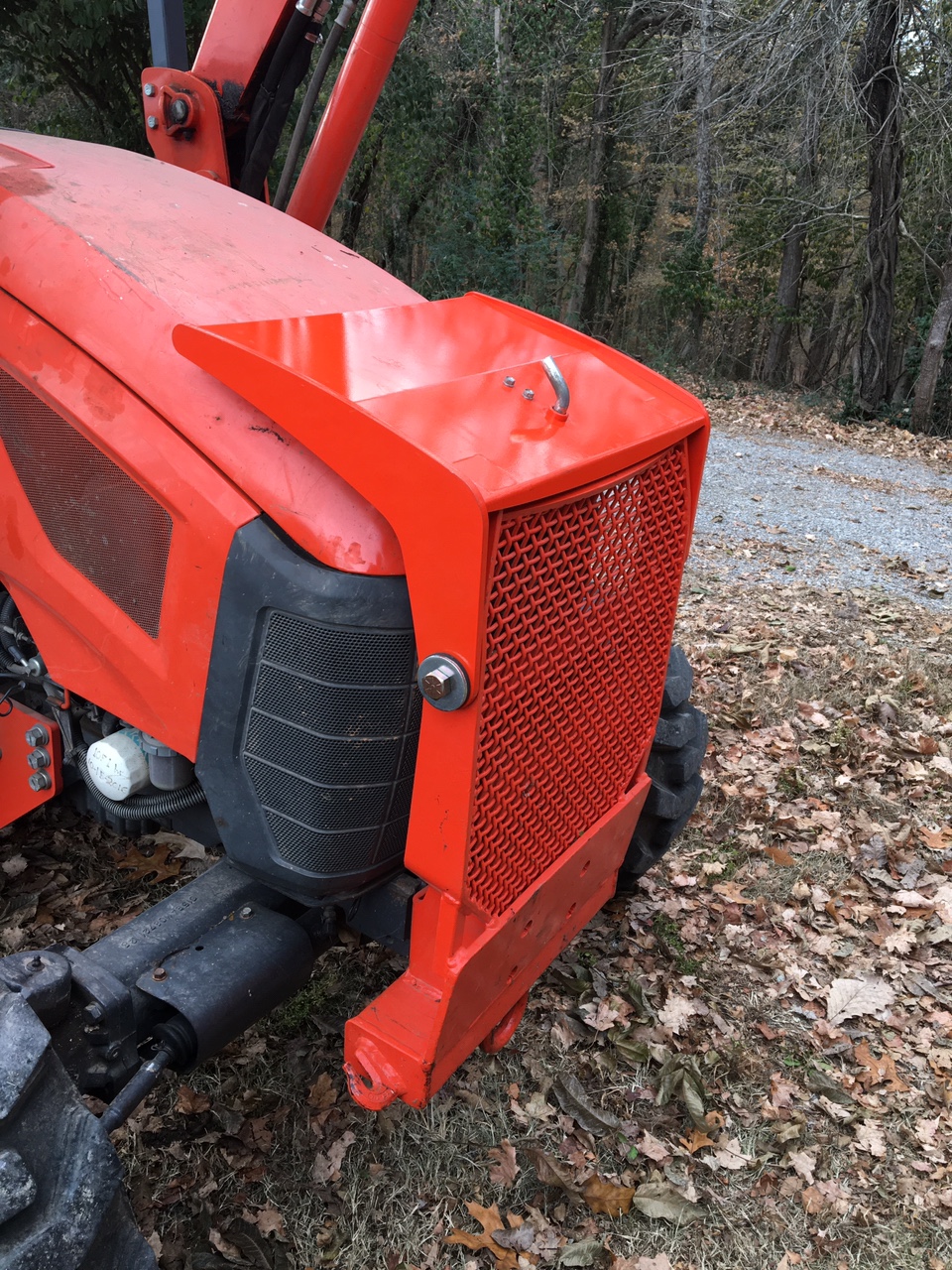

Added 125# of armor. Quarry grade screen is tough AR steel. Bumper with hooks and D-ring for tie down. Helps protect axle when bush hogging. Bonnet protecter hinges down for access is a Kubota option for the M59 and is a Handy tool table for maintenance.
I used a friends Mig machine. Can't tell you much about settings. His machine has a chart for heat and feed rate. I looked for the settings for 1/8 steel then tweak the settings as needed.
I'm a real amateur. I think I could have done this job with my stick welder, but it would have taken me ten times longer and it would't look as nice.:(

Mad Max got nothin on you.:thumbsup: I really like the screen.

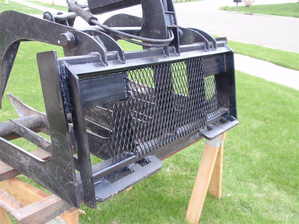

Nice work. Now do yourself one more favor and add some expanded to the back of the grapple. I did it, and it really helps productivity. You can push into a pile and nothing comes poking through the grapple so you can scrunch up a lot more at once.

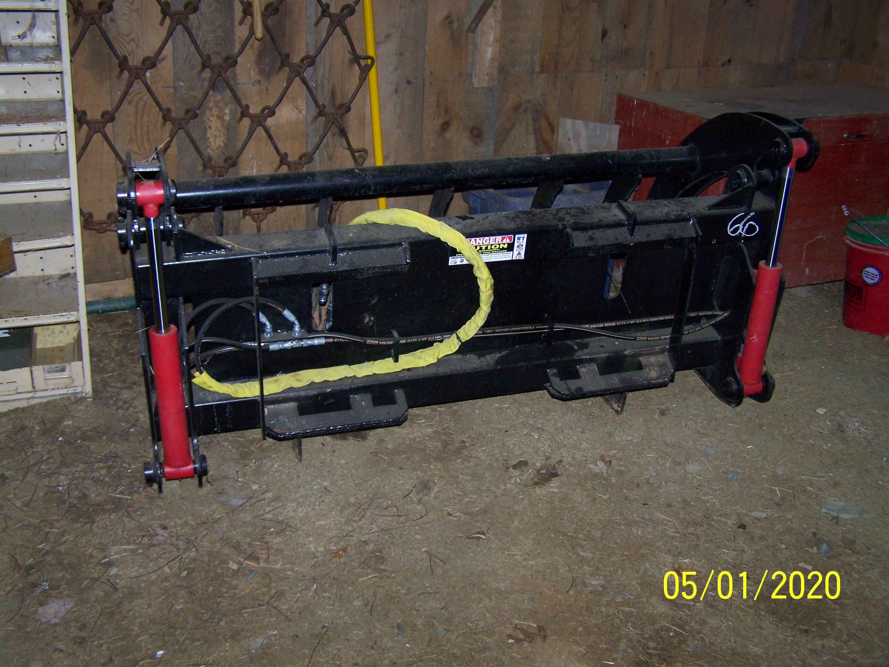

That's a good idea! One more layer of protection.
My grapple design is a little different. It has a solid back.
The bottom tines are short, (root rake) so I do a lot of scrunching too.:laughing:
