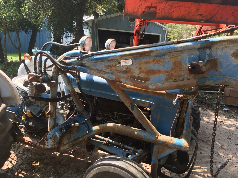

Cool enough the fluid tank is within the 3” loader structure itself. I have no idea how much capacity it takes; I’m sure it’s quite a bit. (Lowest horizontal pipe in the picture) IMG_1330.jpg

25 GPM at 2500 PSI would take 44 HP. I would think 14 GPM would be plenty. Are you wanting to drive a hydraulic motor or just cylinders?
   / Gresen 2712 M
#23
Well I’ve considered hydraulic driven wood chippers and stuff of the sort just so I don’t have to upgrade to a new tractor. Make the simple old tractor one that can handle any implement in the 45 HP range.
   / Gresen 2712 M #24
For reference on existing reservoir size: it takes approximately 33 inches of 3 inch pipe to hold one gallon
If you increase the pump size very much you will also potentially have to increase the hose sizes, valve size, reservoir size, etc..
