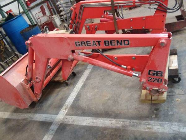

I've found a GB220 loader that was on a john deere 650 locally
it looks like it'll fit on my 155d
but I can't find any specs
anybody got a GB220 on a ym155d?

here is a pic of it

Wouldn't doubt it would work but also would believe there would be some fabrication involved on the mounting hardware. Purely speculation, no experience. :2cents:
/ Great Bend 22o loader on a YM155d #4
That looks like its masts have pins that rest on saddles, to make it quick-detach.
And I don't see the crossmember that runs under the bellhousing and ends at those saddles. I hope the seller includes the crossmember.
My GB loader undercarriage is bolted on by the starter (and equivalent on the opposite side) as well as to the bottom of the transmission, and also has radius arms that go back to attach below the back axle. I don't see any undercarriage like this in the photo above.

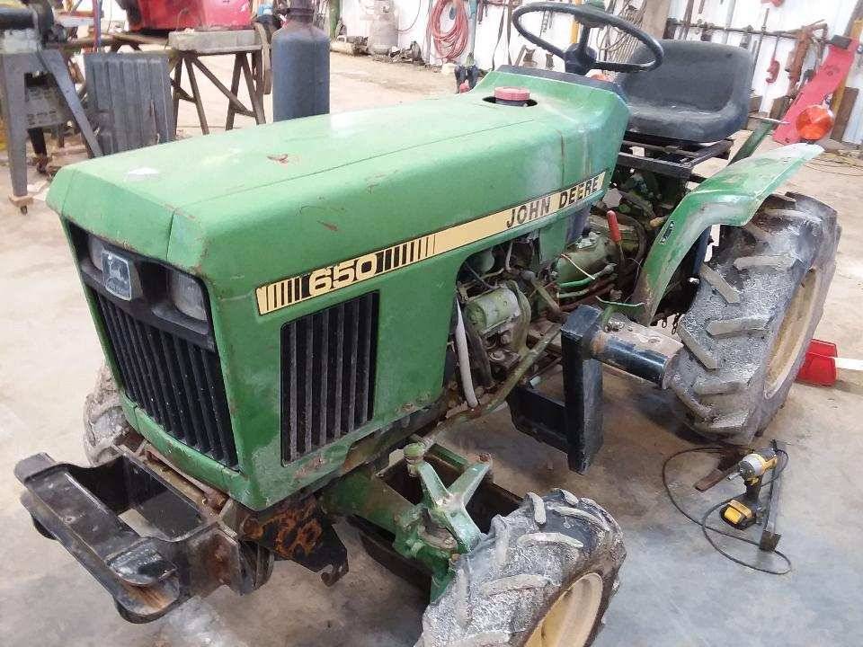

yes the brackets on this tractor come with the loader, there is one for the front and one for each side
I did not see anything that would go to the rearend. though the JD650 has a cast iron trans instead of the steel one
wouldn't be to hard to fab something for that part

the JD in the pic has a blown engine (if you're wondering) and is also for sale seperately

yes it doesn't look too bad, the bucket has been welded at the mounts on both sides, I couldn't really tell why but the bucket is a slightly different color,makes me think maybe it isn't the original bucket? and the mounts were welded on to make it fit.

Great Bend loader is excellent quality. That what is on my YM240. Apparently dealer-installed when new. Mine runs off the tractor's hydraulics and that works ok. The lift is not real fast but it's quite sufficient for general farm use. I don't know if YM155 has the same capacity hydraulic pump as YM240.
As for undercarriage, we read about tractors split in half at the bellhousing. I think you need the arms going back from the crossmember under the transmission, to prevent that localized stress. I linked to photos of my undercarriage in my post above.
If you have a welder and can fabricate the mounts for YM155, that would be a good buy.
