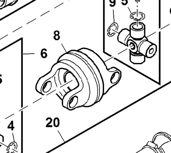

I've had an HX-15 for about 4 years now. Apparently I'm greasing it correctly or I would have issues by now.

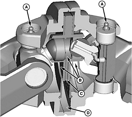

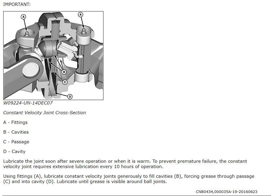

But I can't help but to think how poor of a design the CV joint is on it. Instead of having a dedicated grease fitting for the CV joint itself (like most all others do), it supposed to have "passages" from each of the UV joints to grease the CV. You are supposed to pump grease in the UV's fittings and it is supposed to make its way to the CV cavity.
However, from day one, the problem has always been that when greasing the front universal joint, grease oozes out from around the seals after only a couple pumps. Grease doesn't do this on the back one, so I assume that that most of the grease is getting in there from the back uv joint.
Does anyone else have this problem?

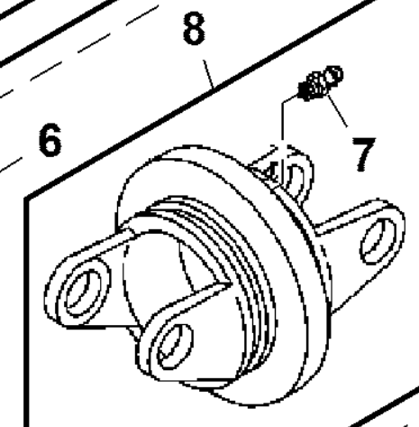

So you're stating your JD HX-15 cv joint doesn't have grease fitting(key 7) on cv center yoke listed in parts catalog? I know all the JD rd balers I've owned had a grease fitting on cv joint yoke in that location. HX15 operators manual shows 3 grease fittings on cv joint
The older models did, which is what your attachment is showing I believe.
The newer models have this type:

Just for clarification...
I know that CV joints on PTO shafts need regular greasing. I have several other implements with CV's. They all have dedicated grease fittings on the CV joint itself that allows you to directly pump grease into it.
The HX-15 uses a Waltershied shaft, which does NOT have that dedicated fitting, and instead is supposed to rely (as shown in the above diagrams) on grease coming from the U-joint cross fittings to go through passages and make its way to the CV joint.
My question is if anyone else has had my experience where only the rear U-joint (directly behind the CV joint) is the only one accepting grease. The front U-joint has grease coming out from around the seals after only a few pumps.
Maybe that's normal, maybe its not, but that's' what I am trying to find out.

Thanks for correcting my oversight because I didn't research the last serial number break on HX15. I'll state eliminating the grease fitting on center section is not one of the best of JD engineers shining moments/thoughts.
