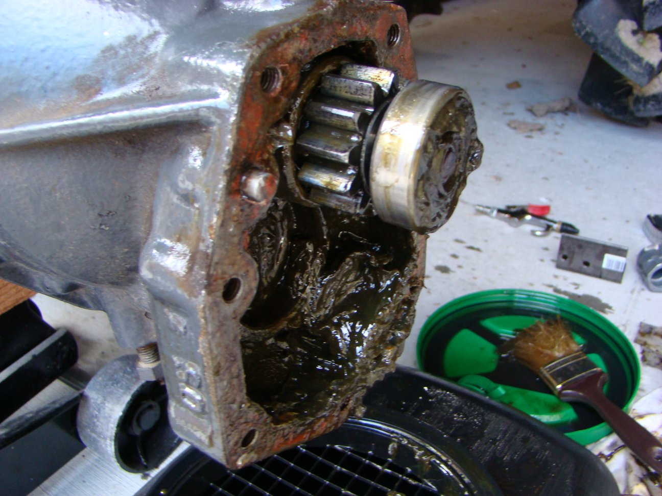

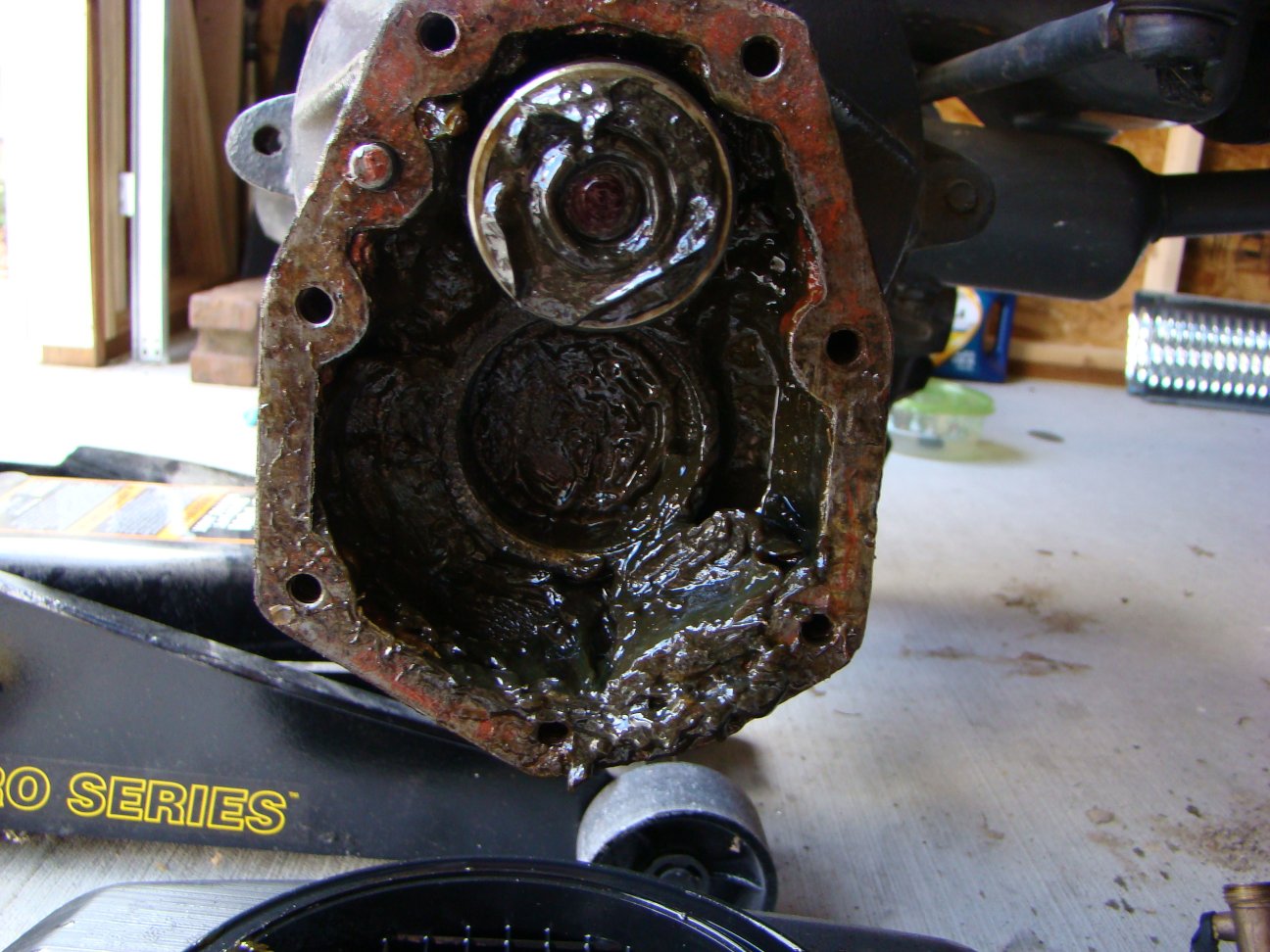

Hi all,
I just bought an Iseki tx1300f and went to change all the fluids. All went fine until I went to drain the front bevel gears (the ones closest to the wheels) and nothing came out. Upon further inspection, I saw that somebody had filled the cavities full of grease, or at least mostly full. I put back 90W gear oil like the user manual stated. I wanted to take the cover off and clean everything out, but found out it may be a bigger job than I thought especially since I'm still waiting on the service manual to arrive. Should I worry about cleaning out the grease, or leave it as-is? Thanks in advance.

:eek:Who would do that??? I would try to flush all that out with kerosene. Not sure you will get it all. Then fill with your oil, run it and then change it again. You will probably have to do that several time to get it all out. That is probably the only way to get it all out w/o disassembling the whole thing. The only thing is...how long has it been run that way:confused:.

The bottom seals were probably leaking , rather then fixing it they more then likelly took the easy way out . as long as it has enough grease in it it might be ok since its lasted this long without any damage , but I dont think I would chance it at the price of the gears IF you can even find them . Heres a thread that might be helpfull from when I tore my TA255 apart , I still haven't got the gears I need and am only using it in 2 wheel drive . Best of luck . ;)

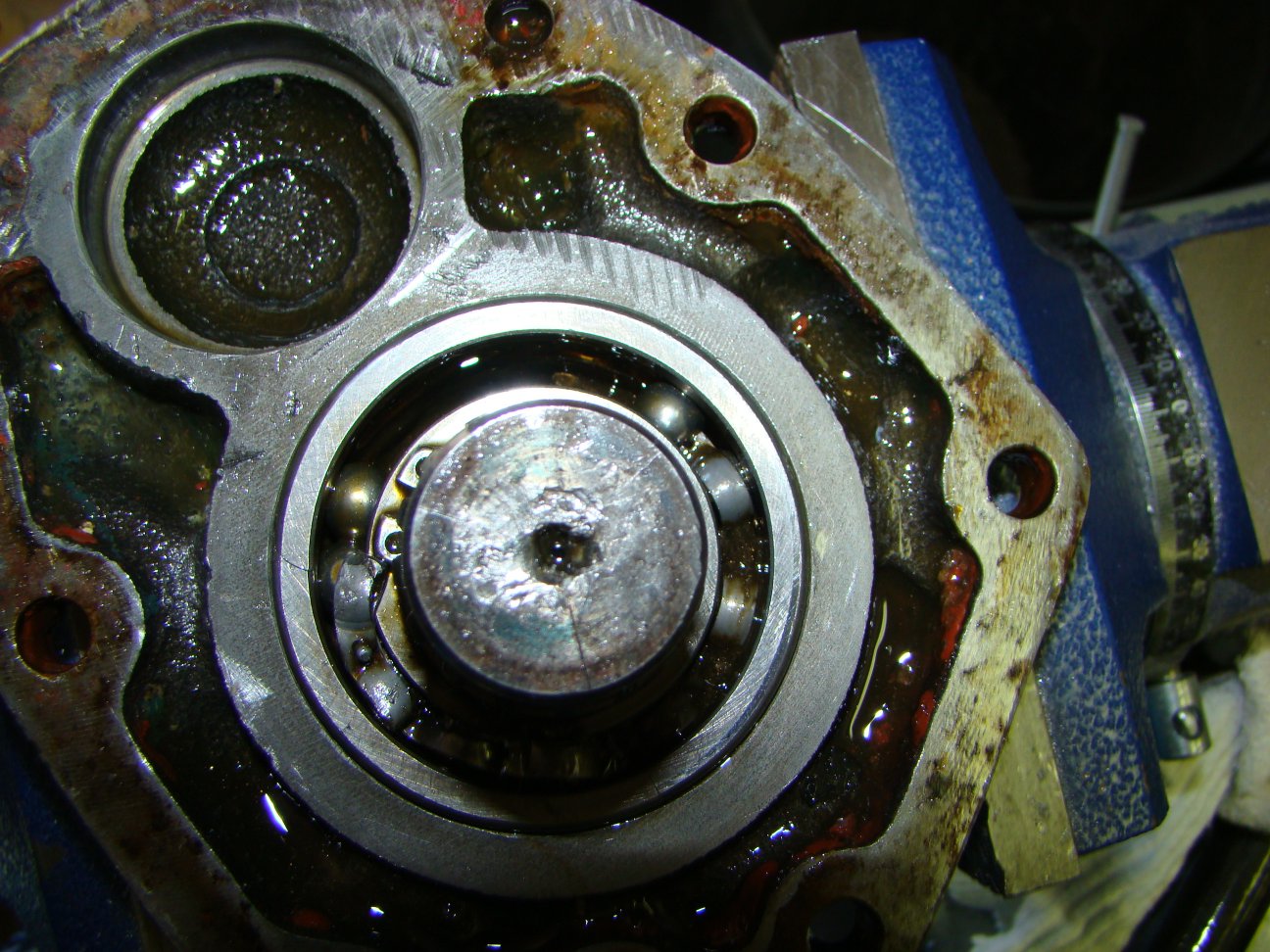

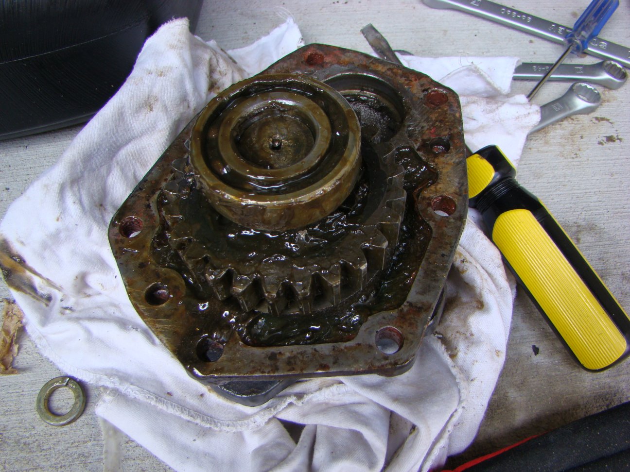

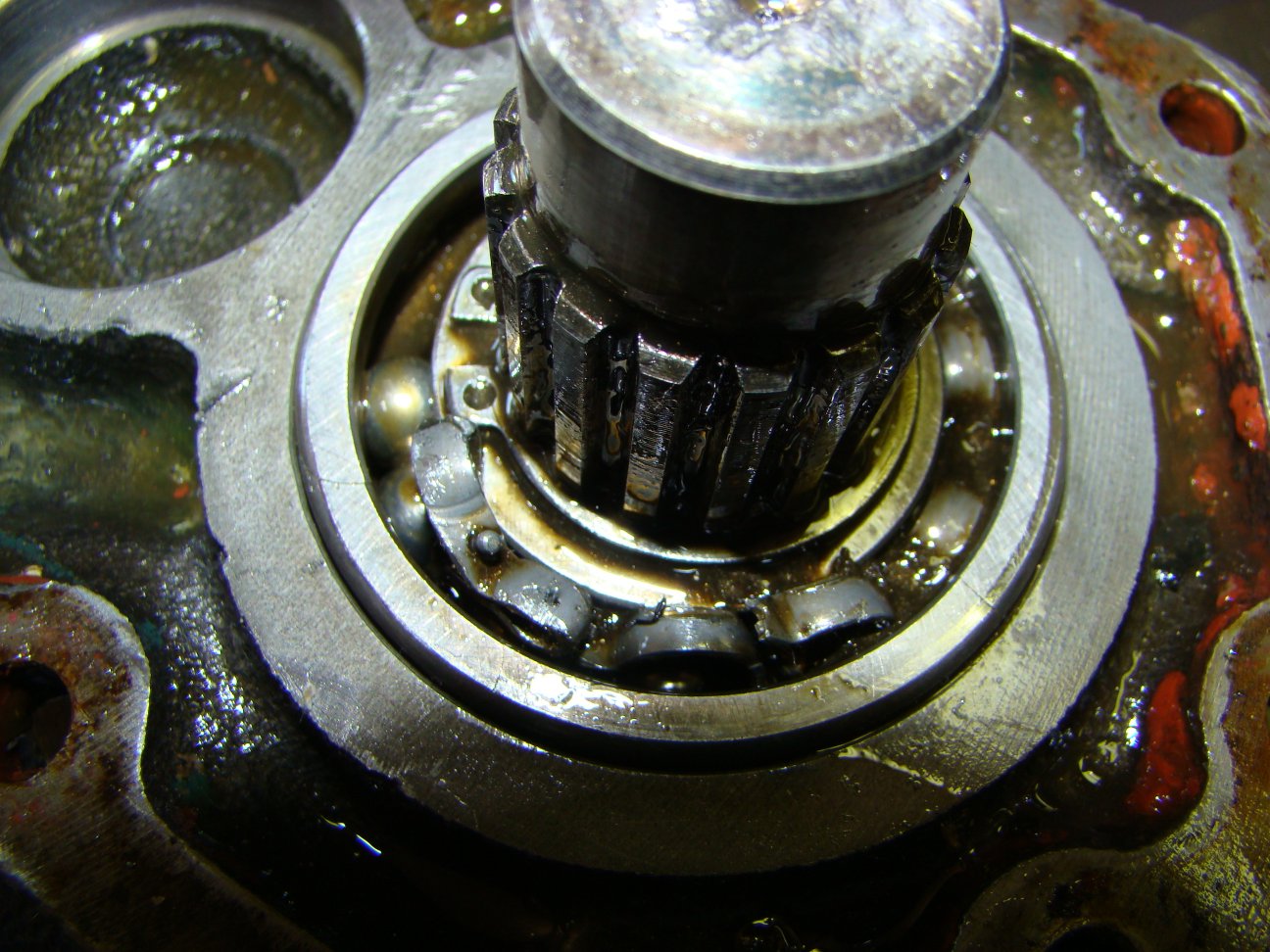

Well, after an afternoon of fighting apart the left side of the tractor it finally came apart - not quite like the service manual stated but at least it did come apart. The wheel drive shaft was suppose to leave the bearing on the end towards the tractor in place and it took most of my screwdrivers to pry it off. There wasn't much room to work with in there and I can't wait to get into the other side and find the nice surprises I found with this one. The bearing closest to the wheel was shattered. Now I'll need one of those and a seal as that looked unusable. Check out the pix :(

i doubt the greas / oil mix will hurt anything.. it will just become a thick lube.
I think you may find someone greasesd the box because it had leaky seals they didn't want to address.. that or they didn't know any better.
It sounds like #2 grease.. it would have been better had they added a nlgi 0 or 00# grease.. like a ep pourable lube or even jd cornhead grease.. if flows and slumps vs making cavities. In hard times I have added gun grease #2 AND 85/140 to make a soup in a leaky box.. it's better than straight grease.. course any lube was better than none.

It looks like the gears are ok, from my tiny screen here. At least you went ahead and did the disassembly and inspection before the broken bearing wrecked the whole front end.

I don't think the bearing failed because of the lube which I guess is good. The other bearings looked good and one of them was sealed and didn't have a c-clip on the end of it like the service manual stated so somebody has been in here before using "aftermarket" parts. You can see where there are a lot of marks on the housing gasket face from someone hacking away at it which is unfortunate. I'm thinking the bearing that failed may have been the wrong one. It literally shattered on the outer race when I tapped it out of it's socket. Seems like it may have been a bit big on the O.D. but it's hard to say for sure. I'm glad I did find it. It's odd that it wasn't really detectable from just spinning the wheel freely. I did feel some slight bumpiness that I thought was the gears but evidently it was the bearing. The pinion gear has some light pitting, the larger spur gear looks pretty good. I hope the right side of the tractor fairs at least as good and hopefully better. I'll let you know. I did find some new seals on ebay in England but I'm going to try NAPA next week and see what they have just in case it might be somewhat common.

Well got the other side apart and it's pretty much a repeat of the left side except there wasn't any grease in the right side (and subsequently no lube at all since nothing drained out the first time I tried it). The bearing on the other end of the wheel shaft is pretty loose and will need to be replaced as well. The gears look ok but this time it's the larger spur gear that has some slight pitting and the pinion looks fine. Looks like this side had the original seal in it as it looks more like what is in the service manual. Still no lock ring on the end of the pinion shaft so I guess that means someone was in it doing maintenance in the past and left it out.
I'm beginning to think there is a problem with axial loading on these failed wheel bearings since it happened to both sides. Although the bearings are deep groove single row, I wonder if they are sufficient for the axial loads they see? I keep thinking back when I bought the tractor and the owner was showing it to me - he would get on it and "pop the clutch" while the wheels were turned lifting the front off the ground and then it would slam down on the front and begin to turn. That's got to cause some high axial shock loads on the front wheel bearings :eek: It may explain why the bearing cages were pushed out towards the sides as well. I'd like to go back in with double row angular contact bearings to help handle axial loads for just the wheel side bearings, but I see where that takes the bearing width from 16mm to almost 24mm and the modifications required to accommodate that probably aren't worth it at this point. I guess I'll have to inspect them often after I get new ones in and see how they are holding up after some use.

imho.. original design should be sufficient.. if instaleld correctly and lubed.

I agree. It doesn't seem like too many others are experiencing the same problem. It may have been a one-time event that caused the damage, i.e. fell off a trailer or the like. The bearings are supposedly rated for around 2400 lbs. each under static radial conditions if they are similar to the original. I can't find what the rated axial/thrust load is but some sources say 25-50% of radial for deep groove ball bearings so that could be as little as 600 lbs which doesn't seem like a lot. I was able to find bearings and seals locally. The seals are not OEM which was expected but should work. I'll be paying close attention to them in service.

as to the bearing failure.. yep.. could have been incorrect instalation, or a shock load as you mention, or could have been cheap bearings. I've bought some steering thrust bearings that had a different angle that original.. setting the preload on them would cause the cages to crack... go figure... might have had a loader on it at some point and wore the smack out of the bearings AND shock loaded it.
