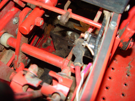

/ Gravely 14-G Transmission problem #9
Here is a pic of a 8000 linkage
