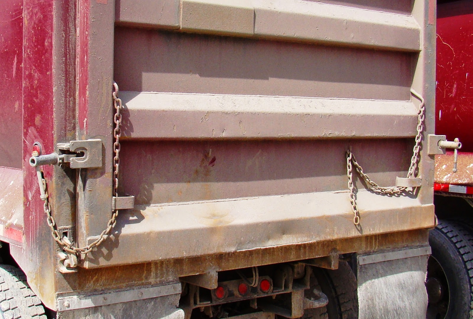

All the ten wheelers around here that deliver gravel have an extra "flange" type thing on the back of the body.
Kinda like this,,
Without it,, the material comes out too fast to spread,,,

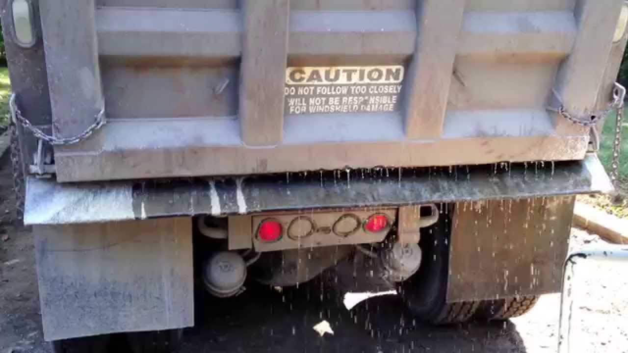

This is MUCH better,, notice the tailgate flange??
Kinda like this,,
Actually the "lip" extension has nothing to do with the speed of discharge. That is controlled by the chains on each end of the tailgate which determine the width of the tailgate opening.
The lip extension is needed to dump into equipment such an asphalt spreader.

Around here they bolt on the extension. If not dumping into a machine they take it off. Pounds are money.
