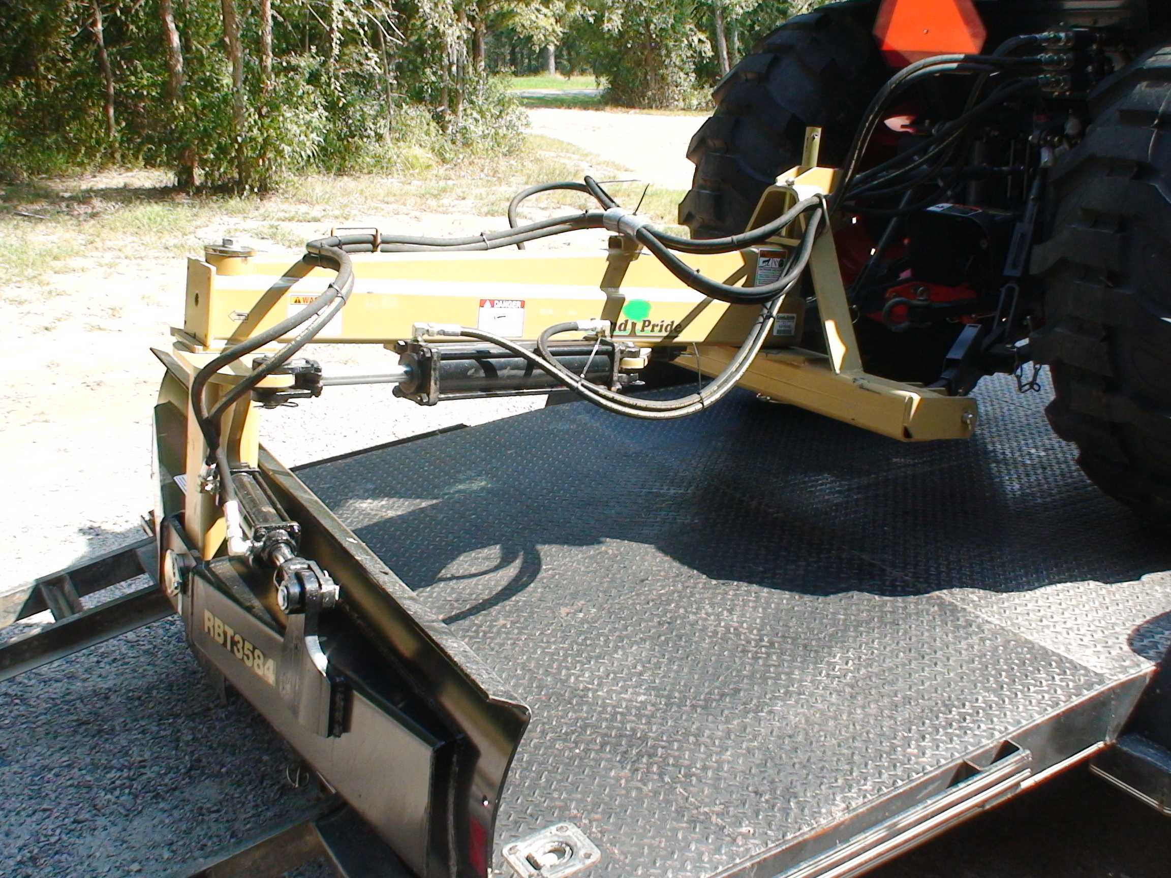

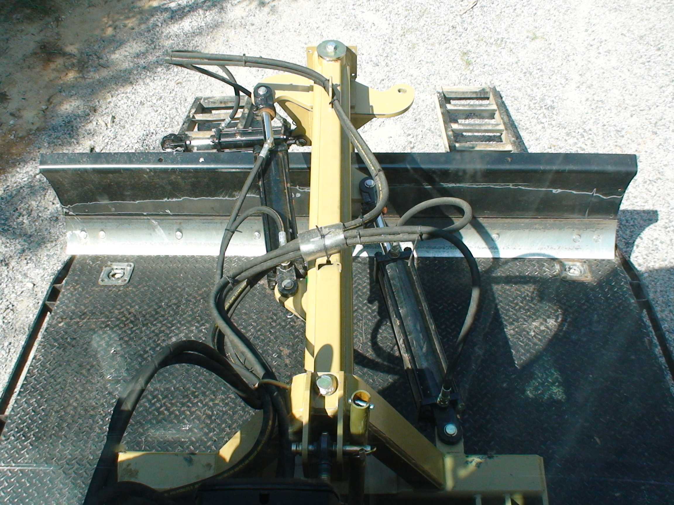

Hey ToJo, I have had good success with a rear straight blade. I maintain about 3000 ft of driveway for some clients and this does an absolutely wonderful job. I start with the blade angled, grading the sides to the middle. I値l work the material several times if needed. Once I知 satisfied with the mixture of fines in the aggregate, ill straighten out the blade and grade straight down the middle of the drive. To finish it off I値l reverse the blade and float out any blade lines that remain.
Good Luck.
Kevin

That rig looks awesome. Do they make them small enough for a BX24? Any idea what that rig would cost in BX24 size?

That is a sweet rear blade Kevin. Terrific set up.:D :D
