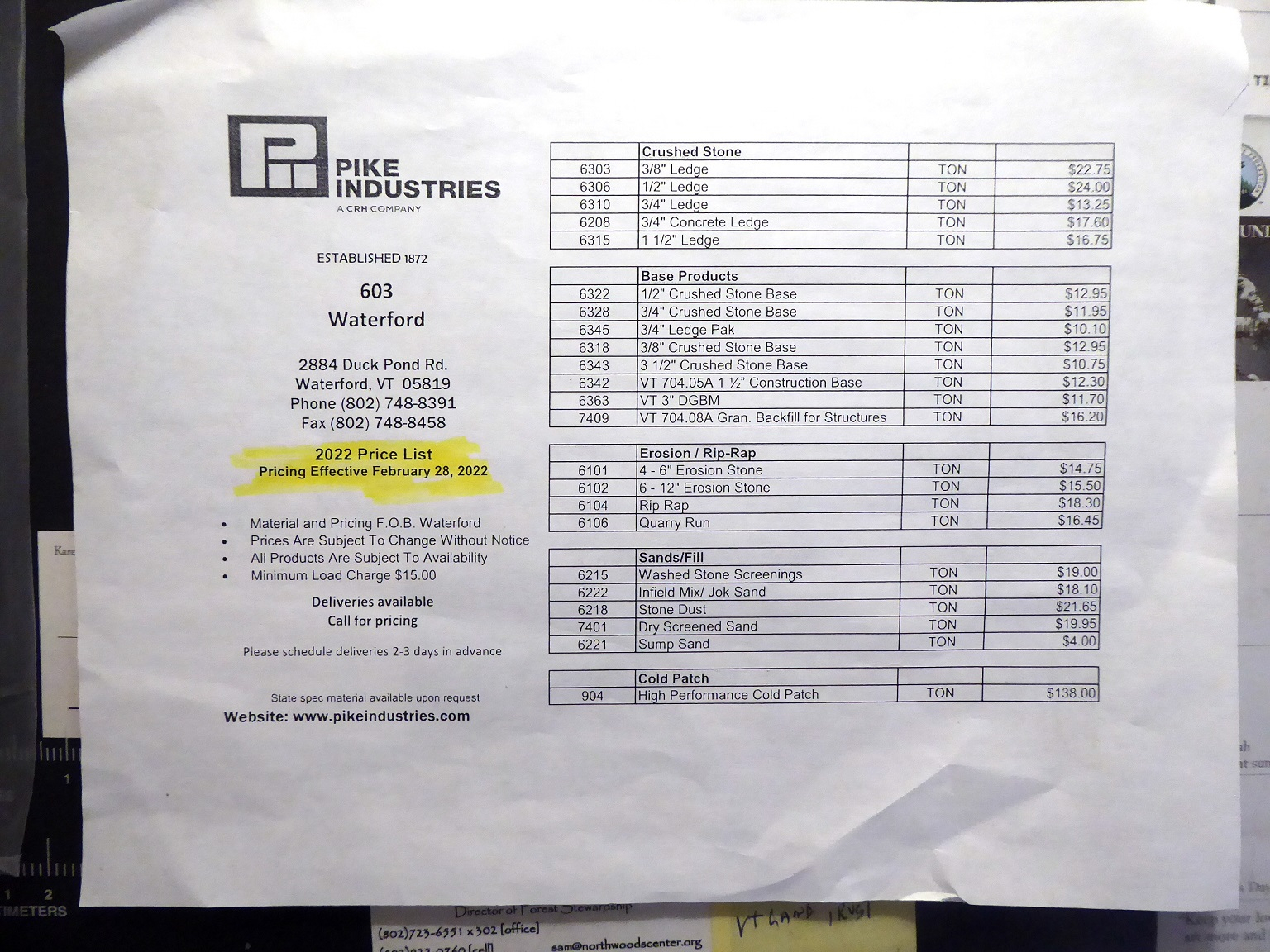

These are the crushed ledge products from our local Pike crusher plant. Pike is the major highway contractor and paver in the state with plants all over. But they serve and treat little guys like me with one-tons and dump trailers as if we were big time customers.
The road base products are mixes from the size stated in the name down to stone dust and have some clay in them. They are all formulated to pack hard. The "ledge Pak" has some dirt in it which gives it a brownish color rather than grey. You can see the state of VT spec products Eric mentioned. Once in a great while they will have a sale on one of those under a different name when the state rejects a batch or changes the spec. Thousands of tons sometimes.
