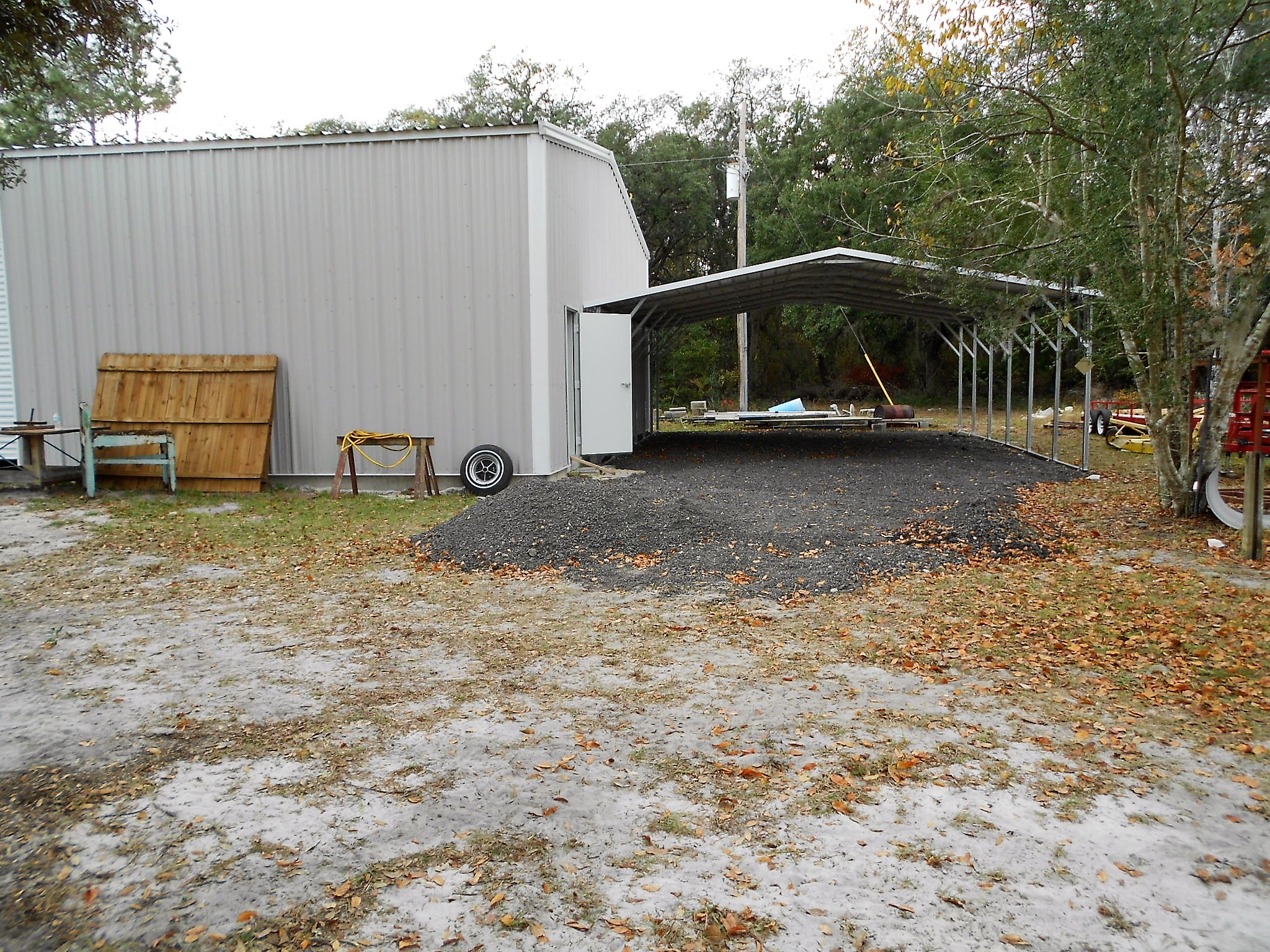

Matches what I was thinking. Not sure where streetcar is getting 1 to 1.5" #57's at.
There are alot of different terms and numbers for stone. And varying all across the country. Around here, we use numbers. And many places will list lots of different options but there are really only a few that are popular.
1's and 2's. A mix of #1 and #2 stone. Can usually only get it in limestone around here. It's 2"-4" diameter and great base material.
#4's. Gravel or limestone. Bout 1.5-2" diameter. Good for road base if limestone, not so much for gravel unless contained. It's also used alot for landscaping, as our gravel around here is a natural mix of sandstone, granite, quartz, and whatever those hard blue rocks are. Also good for backfill in drainage situations, like around foundations, septics, or drain tile.
#57. 3/4" stuff. Popular in concrete ready mix, driveway topcoats, or for a base under a concrete slab.
#8. Also called pea gravel (if gravel and not limestone). Asphalt mix or driveway topcoats. Also seen #8 gravel used for playgrounds.
All of these are uniform size washed stone and no fines or dust. They are considered self-compacting. Meaning you pour down a 4" layer, it is as compacted as it's gonna get. Since it's uniform and there are no fines to have to work into the mix. The #57 and #8 topcoat layers should be kept to a minimum thickness. Too thick and it's like trying to drive in a sandy beach as the gravel moves and rolls around under your tires.
Last two that are popular around here are 304's and 411's. Have heard both called crusher run, or xx" minus. The 411's go up to 3/4" (#57) in size. Where the 304's....go up to 1.5-2" (#4). This material is often used for base as well, but works better over top of larger #1's and #2's for a better base. And not being of uniform size, it indeed does settle, and requires compaction. Once compacted, and rained on for a little moisture to settle the fines in even better, it's almost like concrete.
