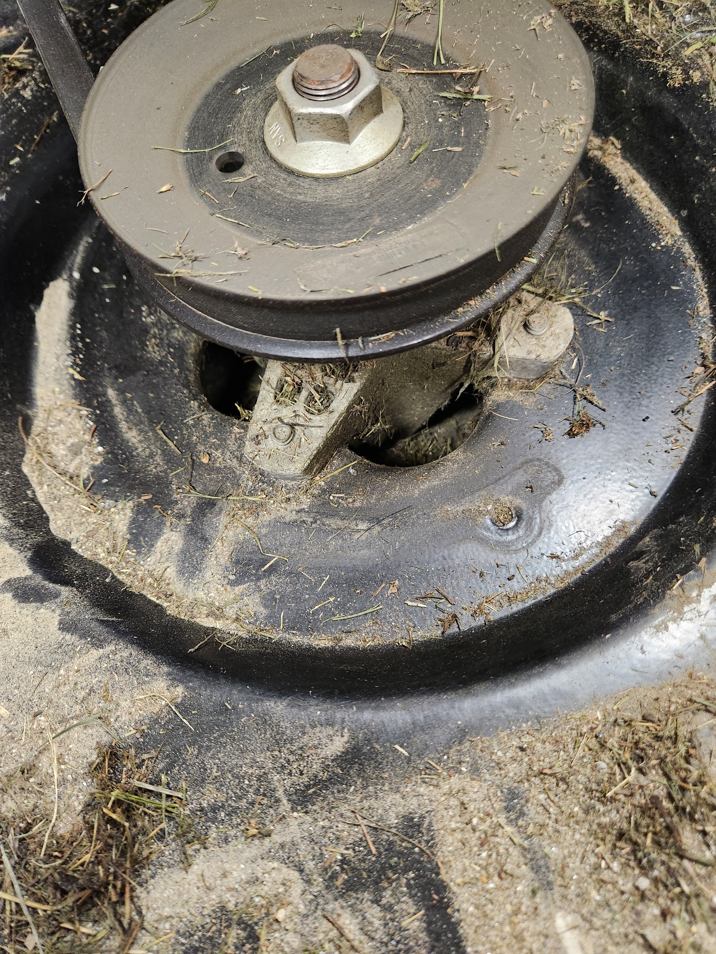

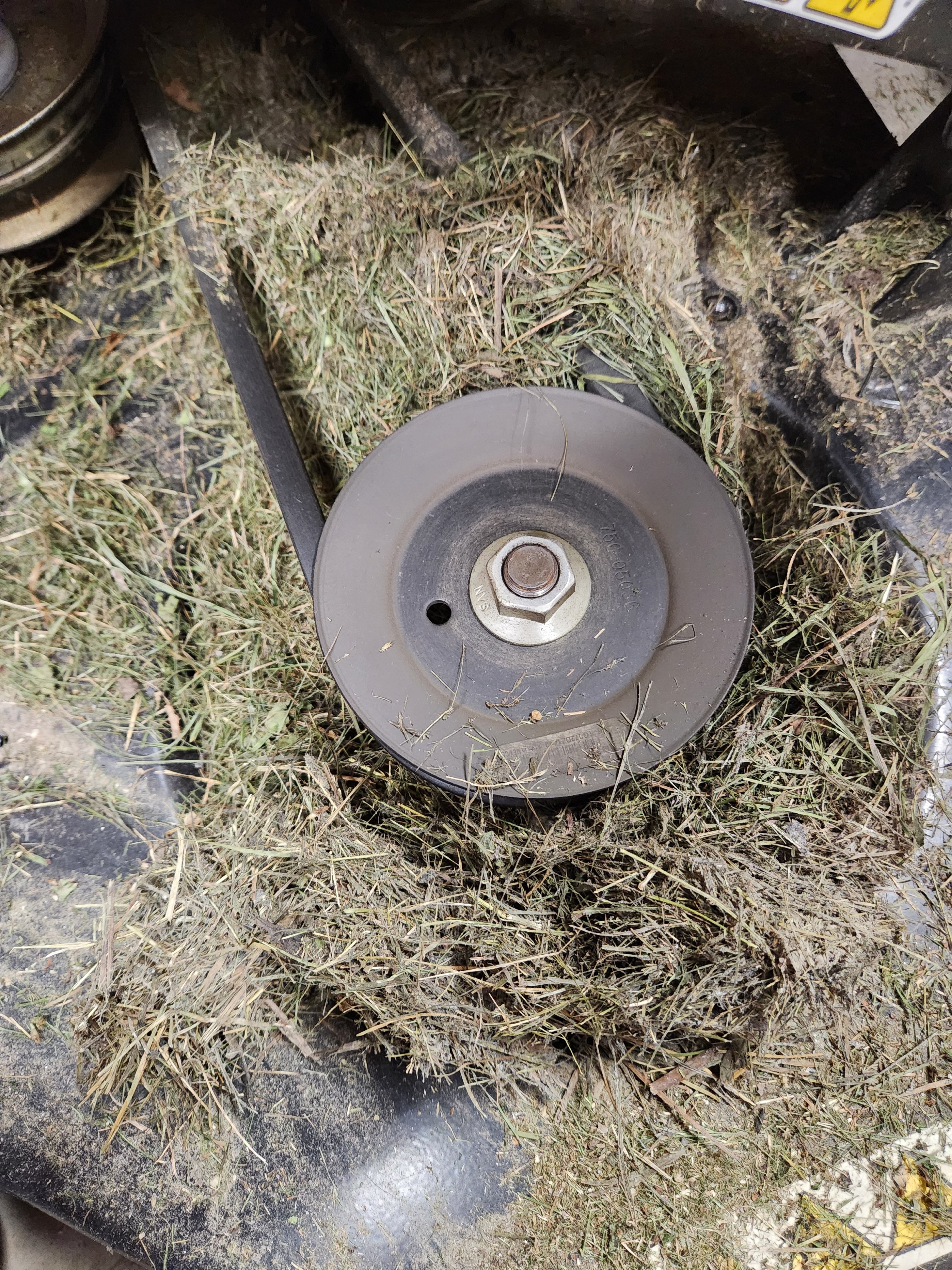

I have a Cub Cadet zero turn, but I'm sure many mowers have the same issue. As seen in pictures, there are openings in the deck around spindles that allow cut grass into pully area. No exaggeration, I just filled a 5 gallon bucket, with compressed grass. It's a pain in the butt using a blower or manually taking off guards. Is there a reason for these holes? My only guess is to allow air escape for high lift blades. If they were plugged, wouldn't the grass keep getting mulched?
Is there a reason I shouldn't find a way to plug holes? Has anyone tried this?

What model is it? I have a CC ZTR (Ultima ZTXS 5 54), but don't have holes like that on mine.
Have you always owned the machine? I wonder if the spindles have been replaced and there are parts missing, or maybe wrong spindles?
Mine gets a TON of grass built up on top of the deck, but the belt guards are open on the sides, so it's pretty easy to blow it off with the air gun.

I have the cc ztr50, uses the 50" cut deck and it has those same holes through the deck by the spindles. I have also wondered about the purpose of the holes. Mine loaded up with grass so badly that I had to remove the guards to clean it all out. After several times doing this I got tired of messing with the guards so I have been running it without them. I still get just as much grass buildup on top of the deck, but it is easier to clean out. I have wondered if maybe those holes are vents of some type to assist in air flow for high-lift blade operation. I have problems getting a good, clean cut. New and sharp blades, clean deck underneath. Deck is level and all blade ends are the same distance off of the ground, blades are the right length and installed properly, and when you sit in front of the deck with the mower raised and position the blades so they are all in the same position, (like clock hands in the 9 an 3 positions,) there is a good 2-3" overlap of the blade paths. Yet when I try mowing and get into bahia, the center and right side blades tend to leave a lot of uncut grass. One reason for asking this question is that when I start out with freshly sharpened blades, (30* angle) and a totally clean deck, both top and bottom, it seems to cut normally. But after mowing for a while and the deck getting covered in cut grass with no grass stuck up under the deck, (coming up through those holes?), that's when the problem becomes most noticeable. I always mow when the grass is dry. Just wondering if those holes are some kind of vent for air flow. I guess the next time I mow, I will make an effort every so often to clean off the top of the deck and see if this cures the problem. Didn't mean to hijack this thread, but the OP got me started when he asked the same question I had about the holes in the deck.

The first thing I did is remove the belt covers on my ZD mowers. Grass packs up in there, and it's a pain to remove them each time I blow the deck off (at least once each day). No testing, but I suspect the spindles, pulleys and belt get hotter with the covers on also. My anecdotal "evidence" is that after 2100 hours on one, and 1800 hours on the other, I'm still on the original spindles and belts!

Inquire and ye shall learn: Ok so I googled it and AI says this:
AI Overview
The openings near the spindles on a Cub Cadet ZTR 50 mower deck are designed to allow air to flow through, which helps create a vacuum for better grass lift and a more even cut, according to a forum discussion on Only Cub Cadets. This airflow is crucial for the mower's cutting performance.
So, to answer the question for the OP, should I close up these holes? I think the answer is no, according to what AI says. Now that raises another question: why do some of their decks have holes and others don't? Also, on the decks without the holes, what is the quality of the cut, does it leave any uncut or unevenly cut grass?

2023 ZTS1 50" cut. owned since new. Right now, I'm cutting lawn without pully guards, and it still collects, but not nearly as much. I've used a leaf blower, and as powerful as it is, it is difficult to get the bunched up, compacted grass out. Cutting about 2 1/2 acres.

I have tried several commercial products to reduce under deck buildup and they were so-so. My best results has been from totally cleaning and washing the under deck and letting it completely dry. I then spray a ceramic auto wax and let it dry for a day. I then put a second coat on and let it dry. After 2 major cuts the only buildup on both machines is on the right side at the edge connecting to the removable grass deflector. I also do the deflector at the same time. I am always amazed how there is no bunched grass after cutting due a clean distribution of the cut grass. It always feels good to look under the deck and not see globs of stuck grass.
