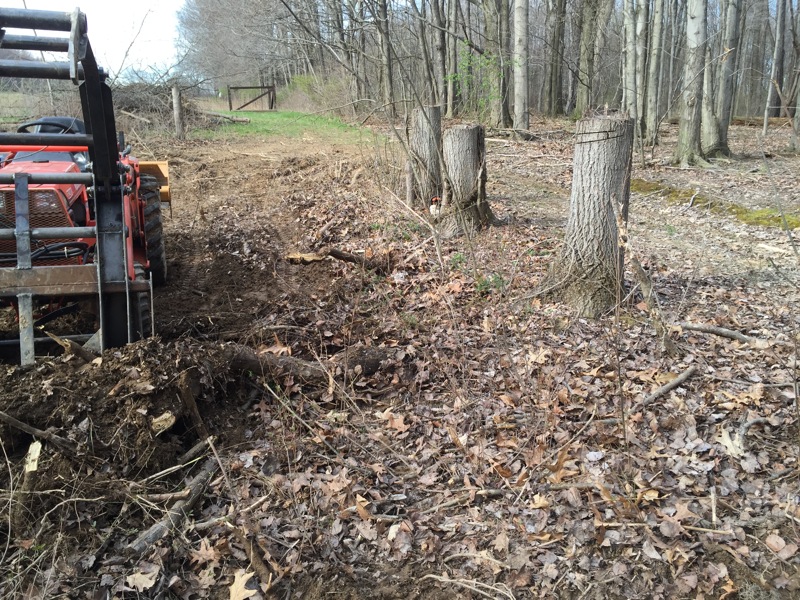

Something that recently moved up the "priorities" scale:
Yours would be much more efficient than either a standard clamshell or open bottom type grapple at collecting scattered tree branches.
Having used neither of those you mention I couldn't say for sure, but it seems to be working pretty good so far.
I'm guessing that the relatively short bottom tines would be a disadvantage in levering and popping roots with the FEL ...
I have less of a lever ... but (theoretically) more of a mechanical advantage I believe, because the lever is shorter.
...but the stout design would permit lots of pushing.
The limitation appears to be the stoutness of the FEL arms ... not the grapple ... :D
I'm trying to be pretty careful in using it, because I don't want to screw up or break something. Our tractor is fairly small and light ... 30 hp/1700 lbs (?) without the FEL or anything hangin' on the 3PH.
But to your point, it does seem to do pretty decent with roots ...assuming they aren't too large or tough.
I was kinda surprised when it popped this one today:
