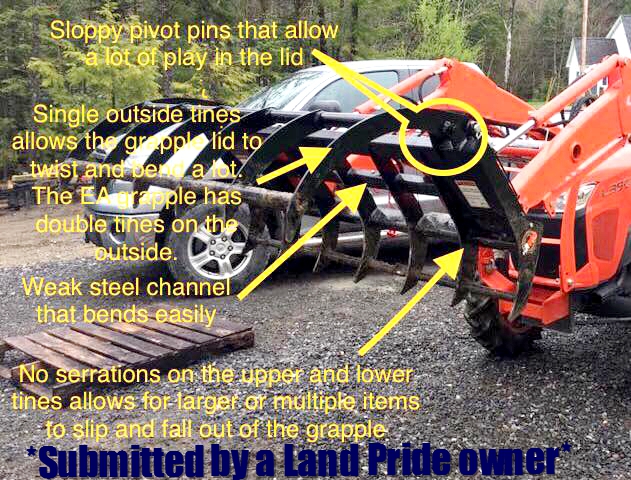

Comparing the 400 pound Wicked 60 to a Land Pride 10 Series.
Curious Kubota owner in another group: "Travis EA, what makes the Wicked60 stronger using 3/8ths metal? The 10 series(Land Pride) uses 1/2 inch on the outside and 3/8 in the middle tines."
Me:
Design. End tines are doubled up. Doubled up center mounted hinge point, greasable pivot points, and the thickest walled DOM round tube you've ever seen on a grapple running through the lower tines to prevent bending. Each lid tine extends to the 2nd lid tube instead of just welding a triangle on the leading tube like the LP. We even take it a step further and gusset them, which provides extra insurance against bending. Our way is stronger and will also hold onto small and/or loose debris more efficiently. Even our front lid tube is DOM. Solid, continuous welds. Serrated upper and lower teeth for gripping and ripping. The #Wicked60 is 400 pounds, which is simply ideal for the more capable L series and MX series machines. If L series owners are more concerned with maximizing lift capacity, they can back down to our #Wicked55, which shares most of the same Wicked 60 features I just outlined. This is just a quick, brief observation. Oh, you can also get it in Kubota Orange!!
From the EA Channel Group:
"My neighbor purchased a Land Pride for his 60 horse tractor because he didn't want to wait for a Wicked Sixty. He crushed it on the first day moving firewood. I came in and completed the whole job in 40 minutes and didn't chip any paint. Boy was he pissed. LOL #Wicked60 all the way!"

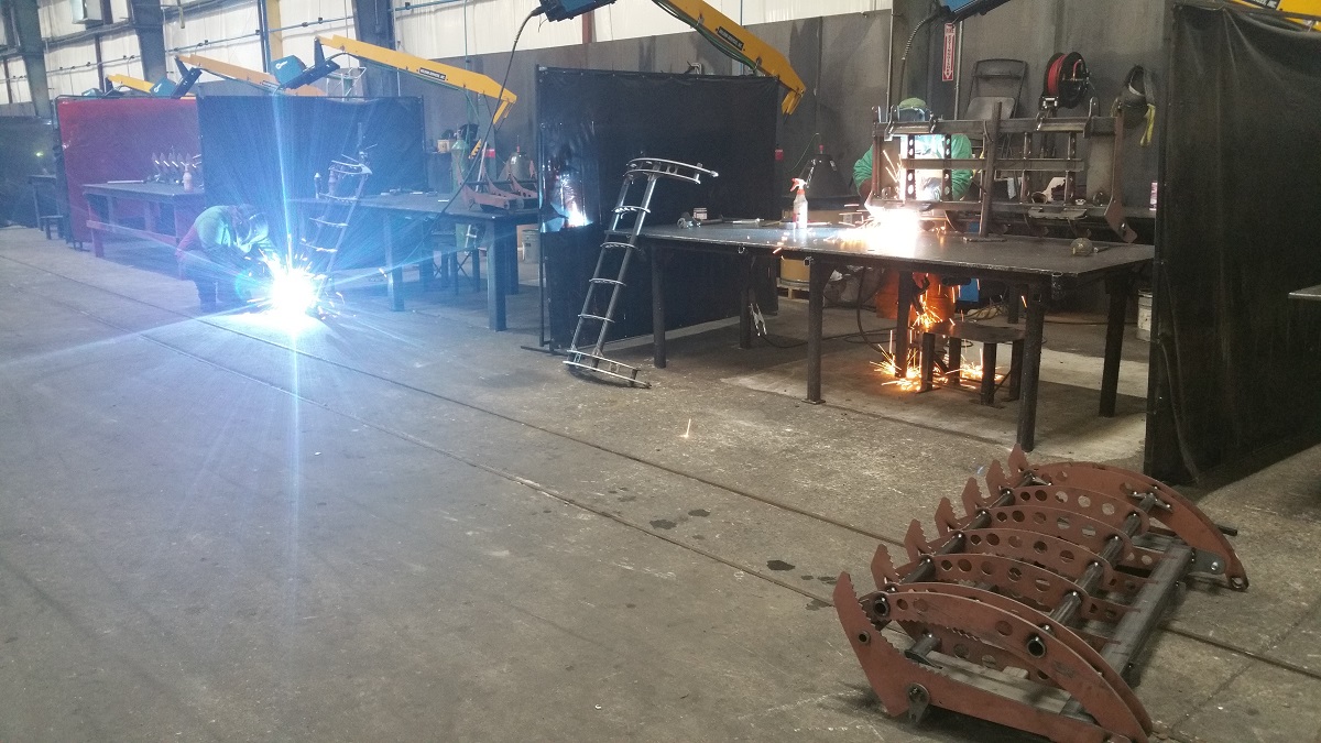

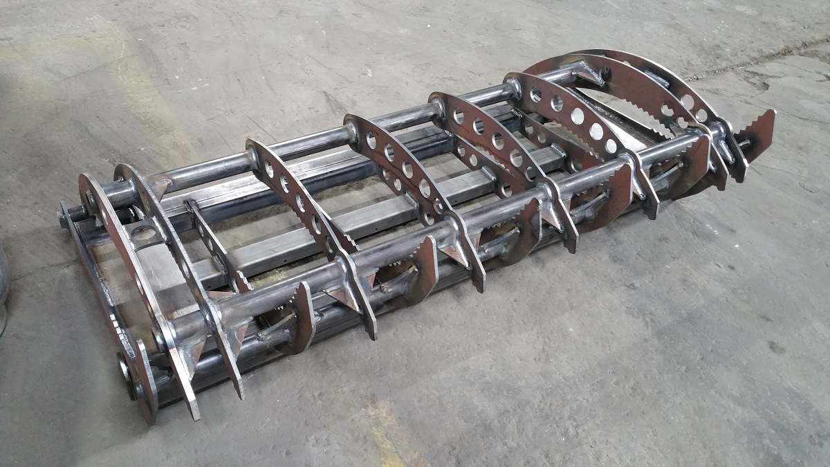

Wicked 55 Grapple rakes in process right now!

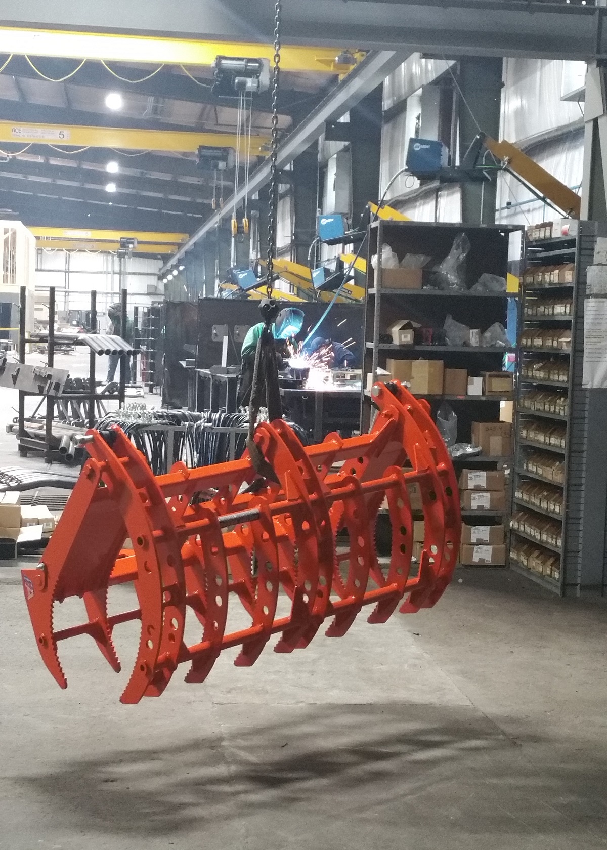

Wicked 60
is ready for cylinders and hoses!

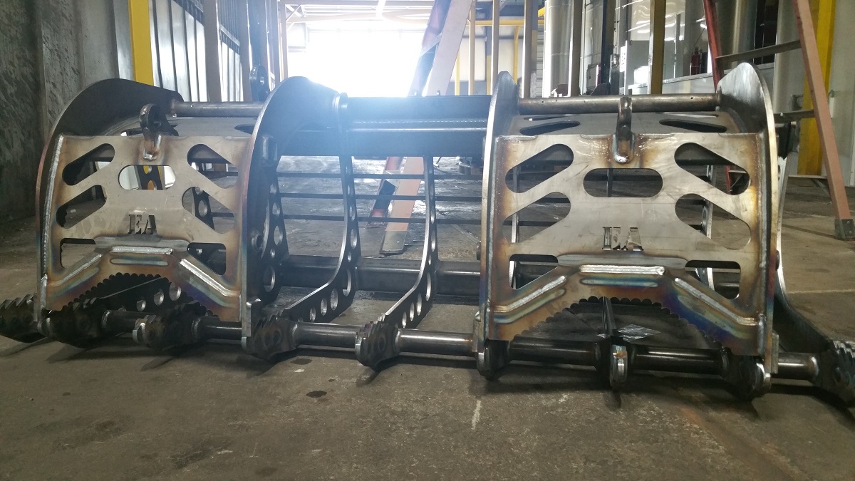

Original Dual Lid Wicked in the buff.

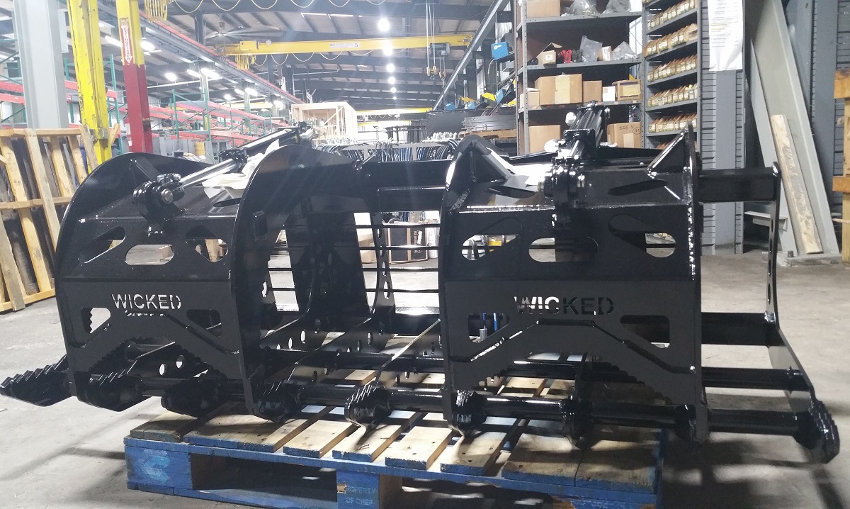

Wicked Utility Dual Lid
