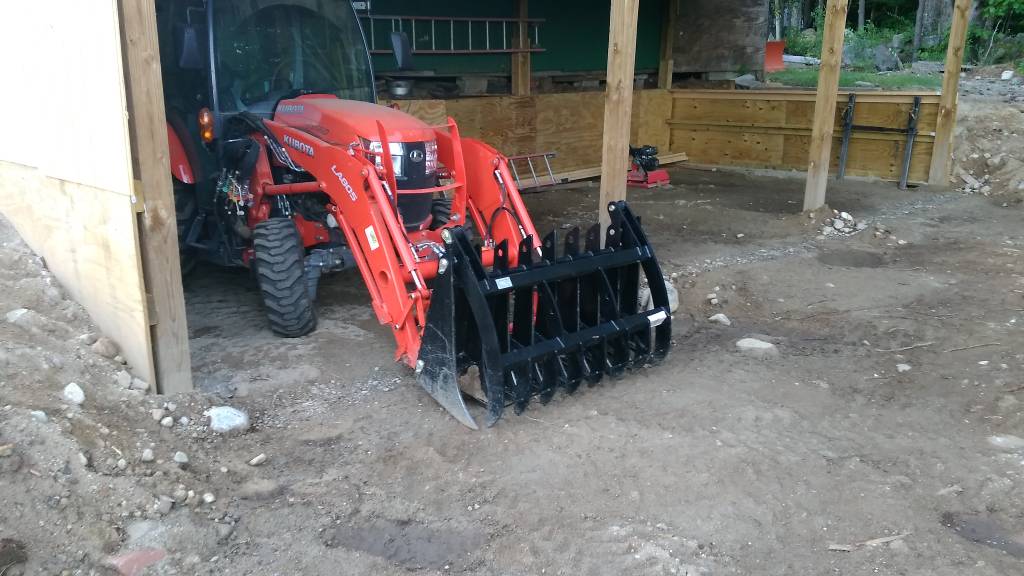

Sometimes you have to consider budget. I bought a Titan 60" root grapple. It fits my needs perfect. Mounted on my L3560hstc I move tree lenght firewood. Clearing some land pushing out juniper bushes cleaning up after having a big pine tree.taken down .
