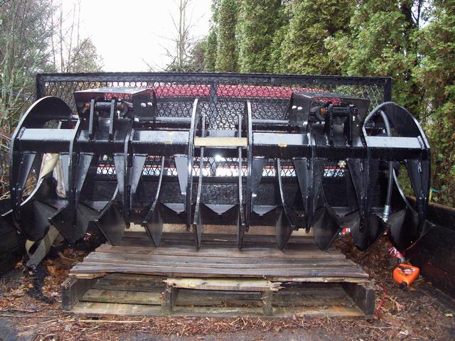

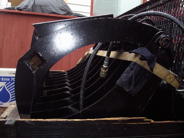

Here's a couple of pics of it on the back of the truck. The camera wouldn't focus in the dark last night.

Tried it yesterday on a few rock piles. The lower teeth slice nicely through sod to get under rocks. The tips (first 6" maybe?) of the lower teeth are 400 plate for strength and long wear. 1/2" 400 plate is plenty tough, and so is the rest of the grapple. It's heavy enough that I notice a difference in weight from the 8' material bucket that's normally on the front.
I think I'd prefer either slightly longer bottom teeth or more rollback angle to improve passive holding, but it does a pretty good job of grabbing rocks. For a grapple on the front of an M105S Kubota it could stand to have a bit greater holding capacity on rocks because I've got lots of loader capacity left from what I could grab of breadbox/microwave sized granite in piles. That's without loaded rear tires or a counterweight. Will definitely need some extensions on the teeth to tax it on brushpiles. I'm thinking of maybe welding some plates on it for mounting 3 bale spears, but we'll see after it's used in anger on some 10' tall piles.

Nice grapple. A bit more than most CUT owners need but certainly appropriate for your big equipment and mission. I have a Horst QA adapter and it is extremely well made.
You chose hardened steel which makes sense especially for the lower tine tips if you are raking for rocks. My Millonzi LD48 is mild steel and after about 100 hours of pretty rough work (though not primarily rock raking) I can say that there is no evidence of wear. I have managed to bend or splay out the top tines (original version grapple with inadequately reinforced top tines) so I am glad that being mild steel it should be easy to repair with a little heat and persuasion once I get off my lazy butt to do it. I'd imagine that hardened tines would be a lot more difficult to repair. I make the point as most CUT owners are probably not going to subject their grapple to the type of industrial use you have in mind and that mild steel is actually a pretty darn good (and cheaper) material for grapples.
