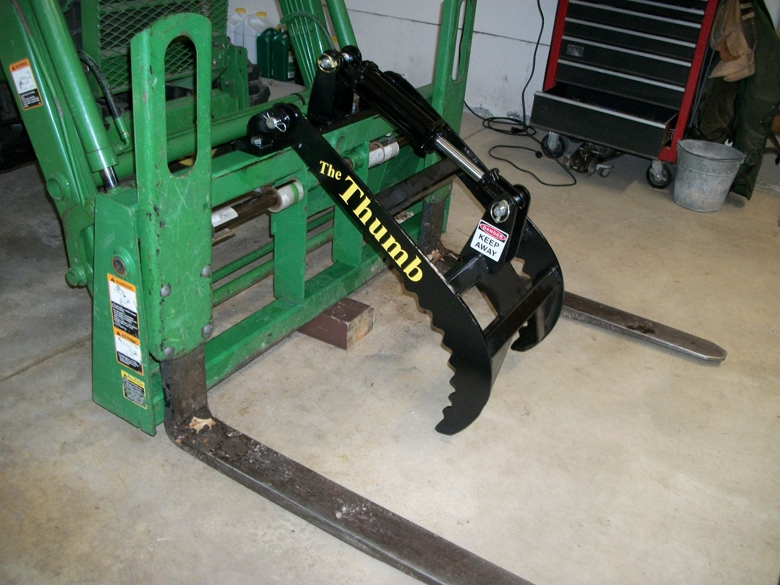

I wanted a narrow grapple to go over my forks to secure logs and brush against the forks. Very happy with "The Thumb" and all it can do. My thinking, is much better to grapple (grab) in the center for better balance of the load on the FEL.
Also is light weight, and I can move it around by hand when I pull the pins to remove it, or mount it. Plenty robust for my 430 FEL and JD 4300 tractor.
