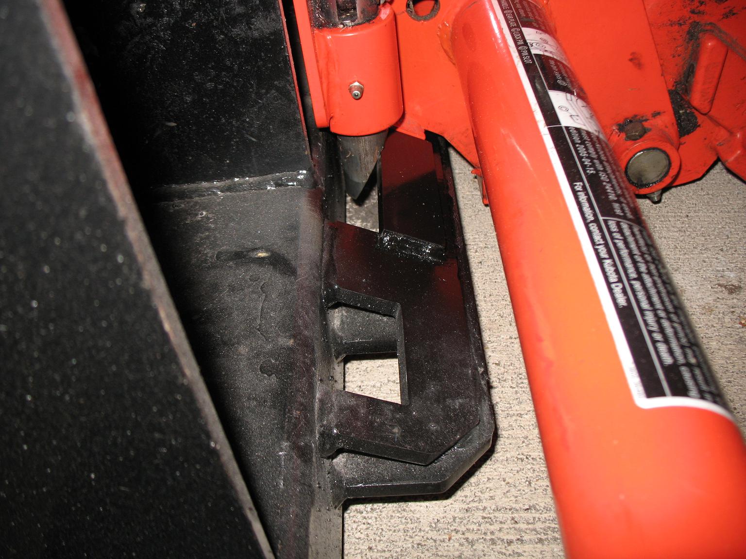

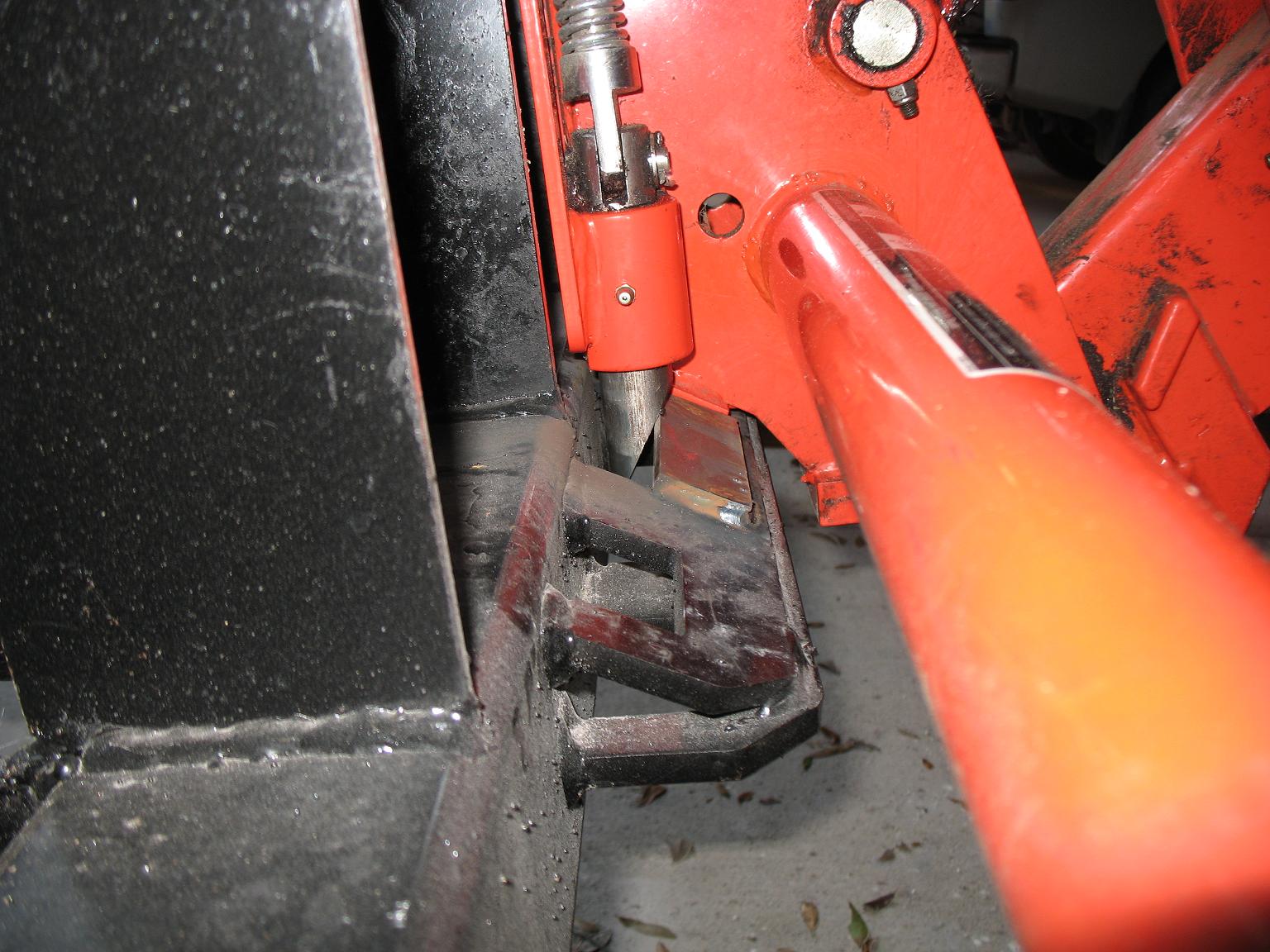

Actually, that's probably better than a pic. Thanks -- looks like a have a new project....
We let this tab extend toward the securing pin's sloped surface by 7/16", & that did the trick.
   / Grapple research and tentative conclusion what may be best for me; what do YOU think? #143
We let this tab extend toward the securing by 7/16", & that did the trick.
That was exactly what I had in mind for the repair. Glad you got it solved.

Yeah, it didn't occur to me how that one would roll off the tongue.:laughing: BUT it really does describe the experience of hitting a bump and having the front of the grapple fly up and then come down with a loud CLANG. Every time I'd think "That can't be good for my hydraulics...."
I was thinking I might go a little long and then grind it back to a perfect fit.

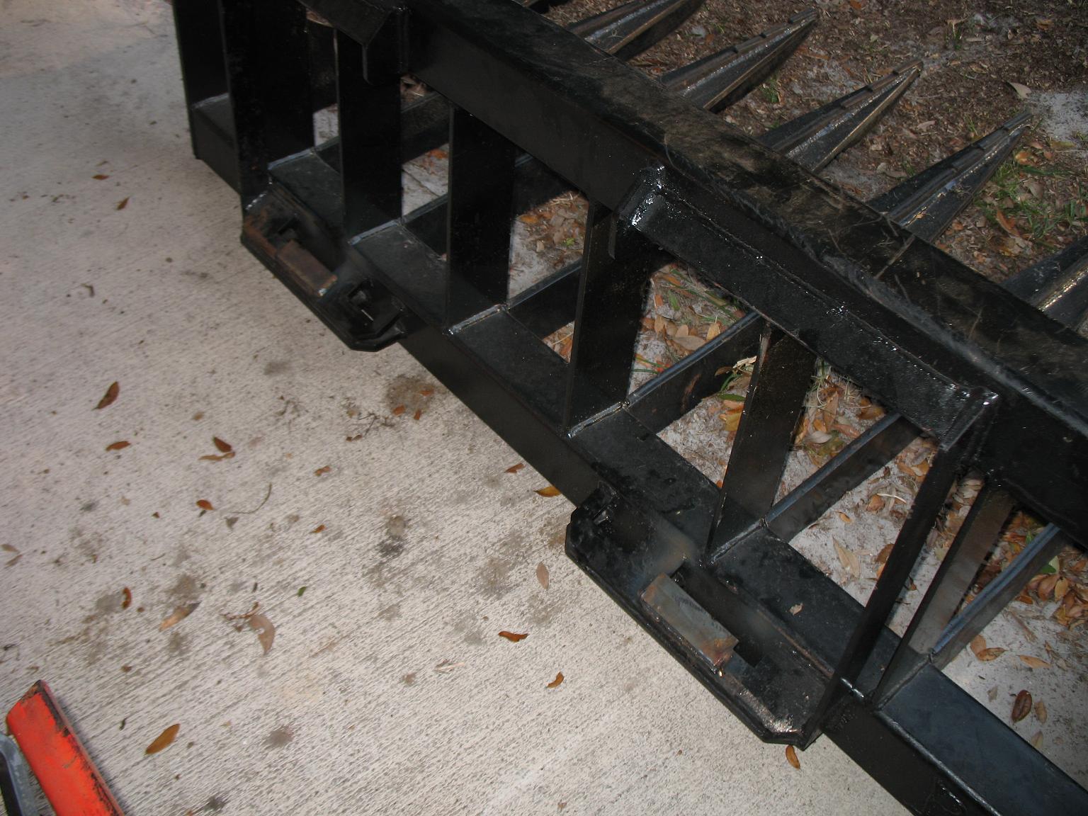

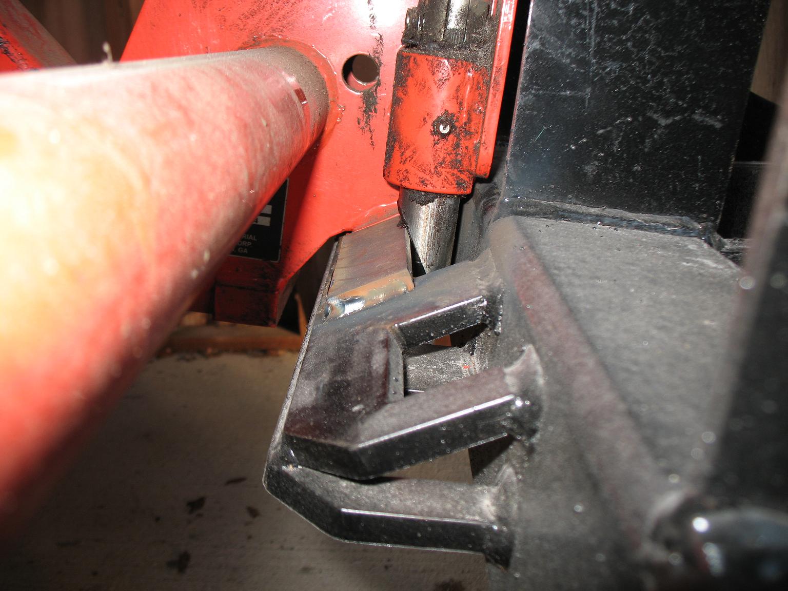

Received mine today. Rather than "shims", they sent me another set of the exact same piece that Wild Kat uses for the pin securing mount tabs. I had a local welder cut those into rectangular pieces & weld them to that take up the ~7/16" gap I had with mine. Now the pins fit very tight & they play is eliminated.
Glad you got everything sorted out and fixed! :thumbsup:
I thought about that, too, but just decided to settle on 7/16" & see how that worked. And it does :thumbsup:

Here is the fix (click on them for bigger pics):
Unpainted:
Painted:
