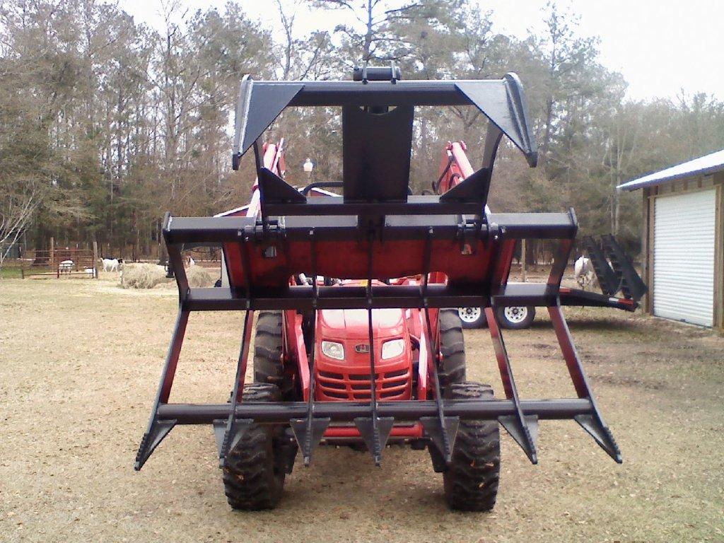

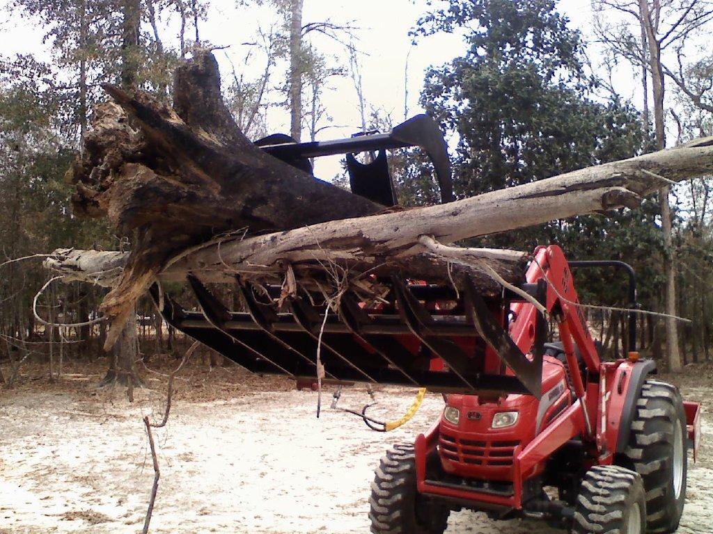

Here is a pic of the Markham 60" med duty grapple made with 1/2" steel. It was $1276.00 shipped and it weighs around 500lbs....my tractor has about the same lift capacity as yours and you could get by with the cheaper light duty one if you wanted....its made with 3/8" steel and about 75lbs lighter......Mike
