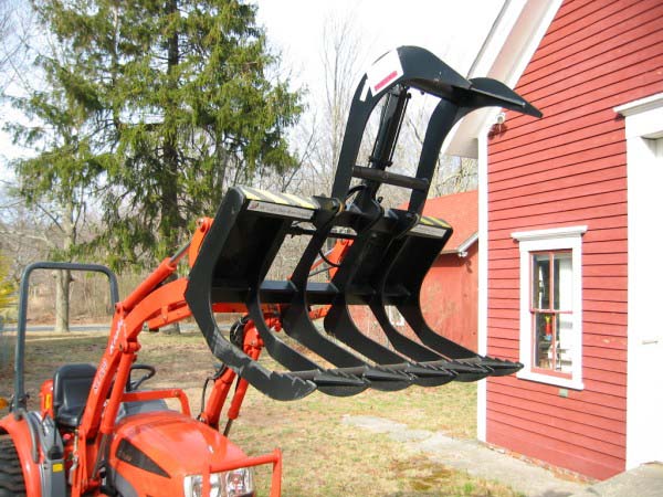

Need a grapple to move downed cedar and the bucket will be the best and cheapest. But will the rake do a better job?

I think the Rakes are probably better, but if you need versatility, go with the bucket. After all, you're not going to be loading dirt with the rake. I think the rake allows more room to get a balanced bite than do many of the buckets. The open teeth and sides make for a better grab in my opinion.

I moved over 100 downed cedars this winter, most of 'em 12" or more in diameter at the butt. I used my 4n1 bucket to shift and stack the logs, and it did the job, but I think I would have been better off using a rake like the WR Long RBG.
We pulled the trees with branches away from the stumps to debranch them where I could use the 4n1 to clear the area regularly, stacking the branches for chipping this summer. But the bucket can't grab more than a few branches at a time. The rake would have made that part much easier.

A rake will definitely be able to take a bigger bite because it is not limited by the bucket sides. It is also more expensive so you need to take that into account. The Add A Grapple type devices would definitely allow you to get the job done but less efficiently than with a true rake. Here is an idea of what you might bite with a rake. (photo)

A rake also makes it easier to see what you are grabbing as you can look thru the tines rather than around your bucket.
Rakes will also pick up less dirt with the material you are moving.

I bought an ANBO grapple rake for my L-39 Kubota. I looked at both the grapple rake & grapple bucket styles.
For picking up objects that are not sitting flat on the ground, the grapple rake allows you to "clamshell" down over an object. You can then lift vertically up and over other objects.
The grapple bucket is less expensive and might work for you if you have a limited,occasional use.
The weight of the grapple will also reduce the lifting capacity of your loader.
You can't beat the ability to move heavy stuff without leaving the tractor seat.
