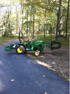

Grapple is up and running after a trip to the local Deere dealer to get the hydraulic connectors squared away. Thank you all for your help! Now to have some fun!

You cant have much fun with a small pic like that. :laughing: :laughing:We need some size to see those pics man! (nice grapple :thumbsup: )
