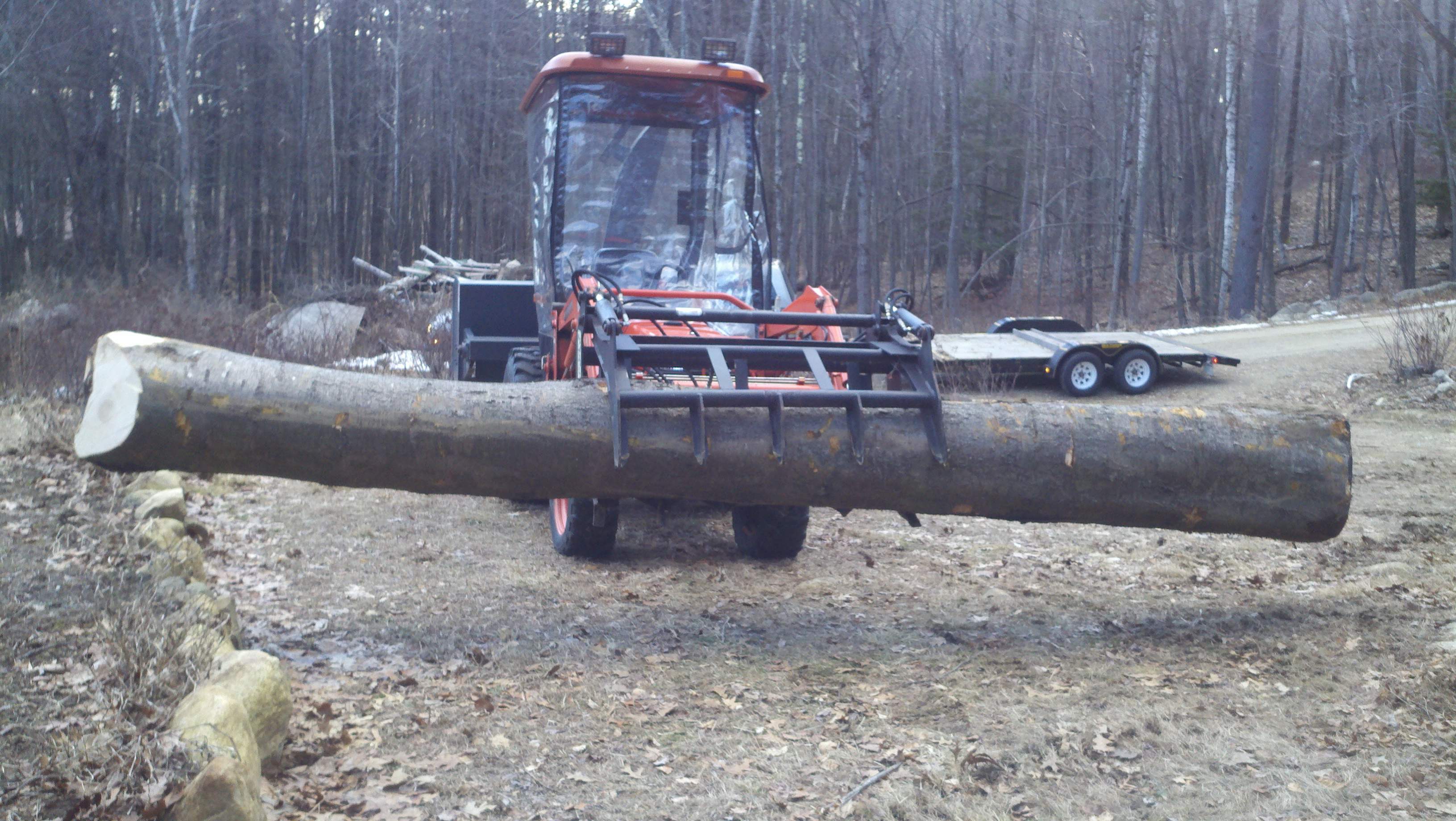

TXwoods,
Your 2920 is a little bigger than my 7610. I have the WR Long RBG2-48 with thier electric valve kit with the rocker switch mounted on the joystick.
I love it and wouldn't trade it for anything. It has done everything I have asked it to do and more. I find it great to move and stack logs, rocks and brush. My 7610 does not have the SSQA system, so I have to put in and remove the 4 pins. It is a pain sometimes, as it can be as fast as a couple minutes to hook up, or as long as 10. Depends on where I have it stored. My long range plan is to convert over to the SSQA.

NHbotanut, That is a huge log your moving there, it is amazing at what can be done with these machines.
