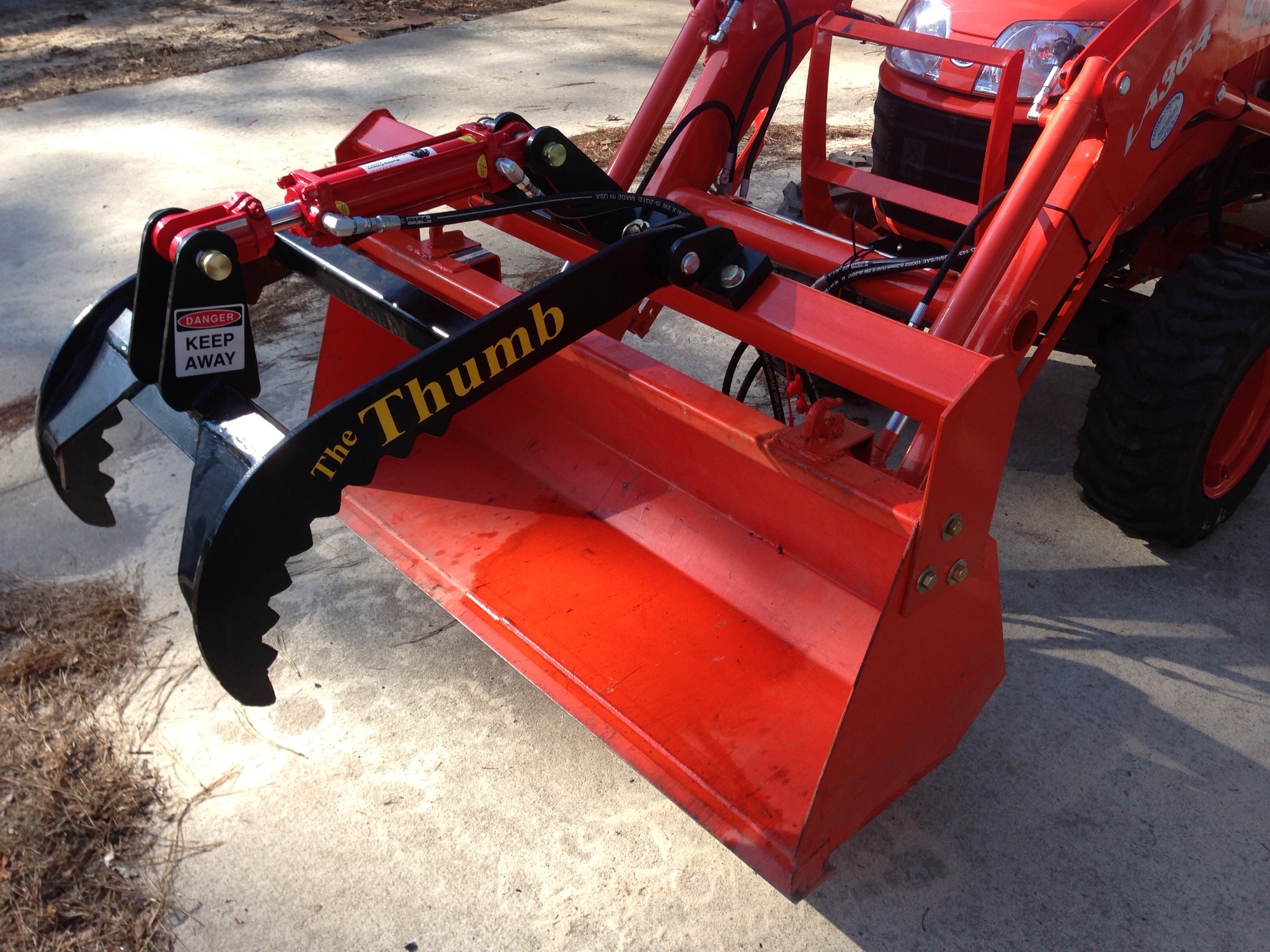

What type grapple? For my purposes, it looks like a bucket-style root grapple is the right choice, for example, the WR Long OBG2. I set out to find out what small grapples are available and how they compare on cost and weight. A search turned up the following:
I read about people who'd had good luck with each of these and a few who'd had bad luck with some of them. For example, I saw pictures of the Wildcat structural failure from a while ago. Maybe they've fixed that now. With the price going from around $500 to $900, I hope so. I also saw many people say one can't go wrong with a WR Long.
For my plan, I've chosen the WR Long OBG2 48".

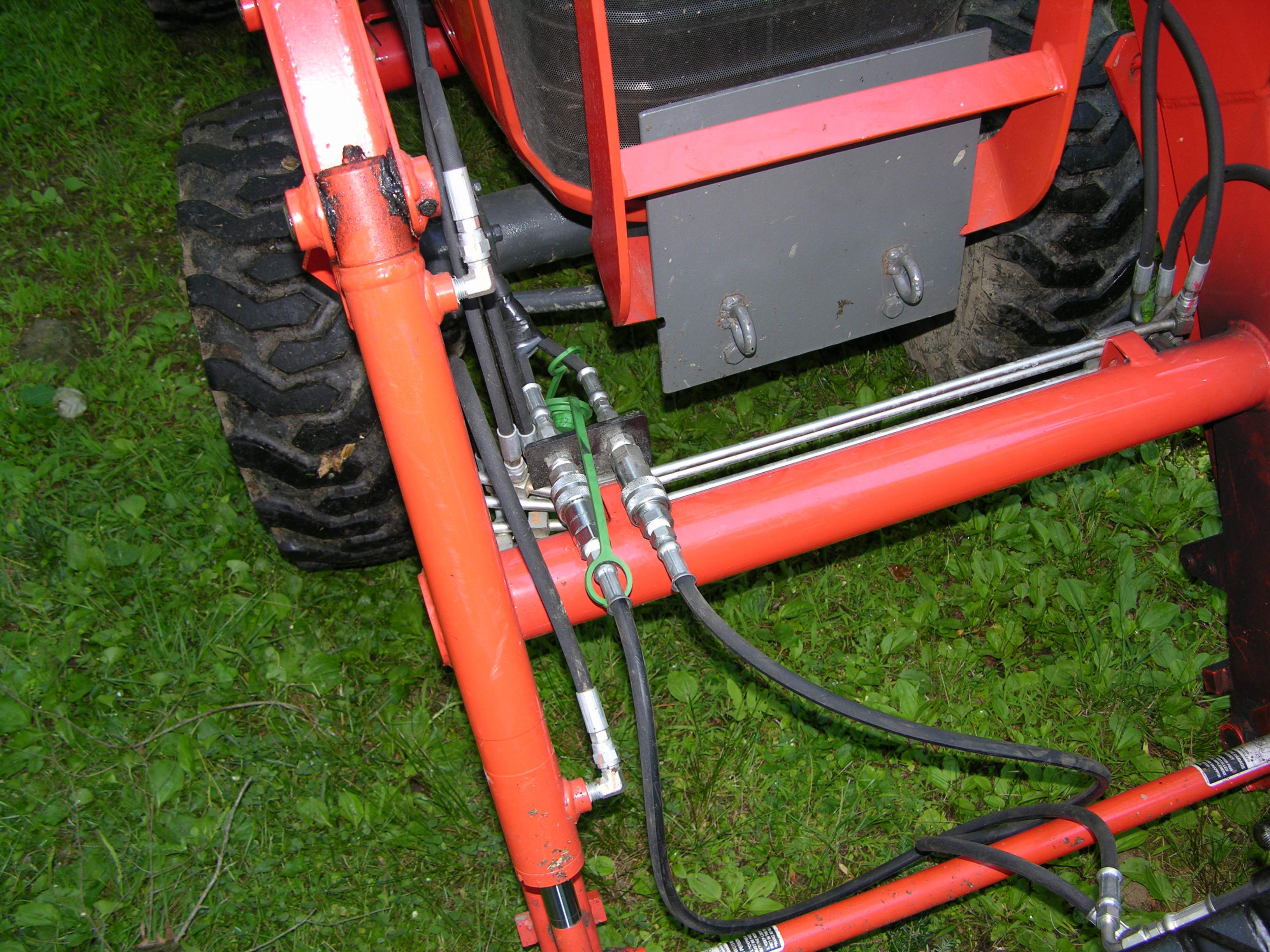

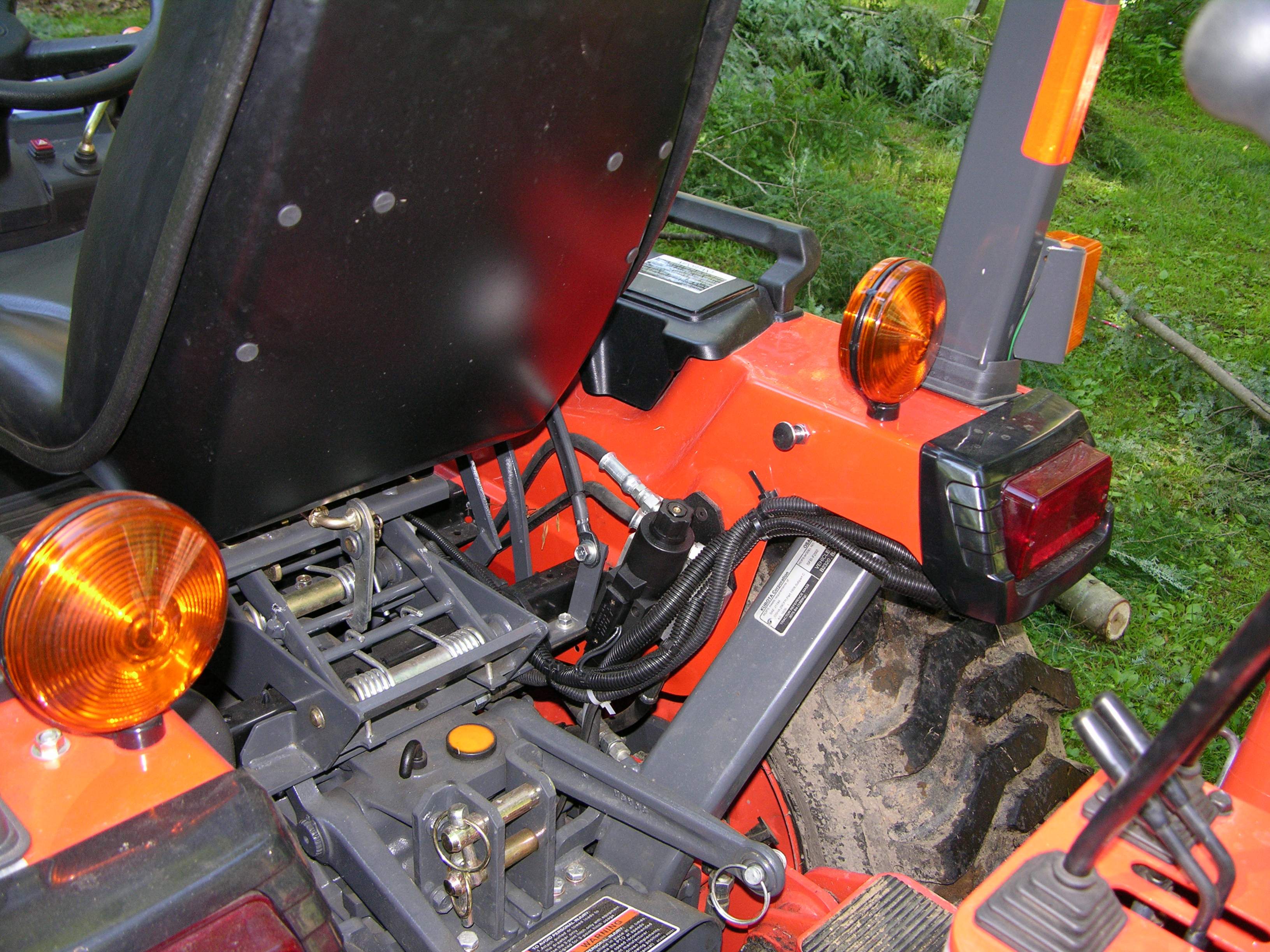

Hydraulics, the hardest for me to learn. After many hours of study, I think I have the basic ideas - open and closed circuits, power beyond, spools, valve types, couplers - but I still have a lot to learn. To work the grapple, I believe there are two basic systems, true 3rd function and diverter. A true 3rd function makes grapple opening/closing independent of the other two bucket functions while a diverter system shares one of the bucket functions and the operator chooses with a switch which to use at a given time.
WR Long offers both types and the true 3rd function is only $60 more than the diverter. Also, WR Long has a true 3rd function model for my tractor but not a diverter model. It operates with a 3-way switch that's mounted on the loader handle.
The WR Long 3rd function looks like a clear choice to me.
- Wildkat 48" Mini Econo Grapple - 420 lbs - $900
- Titan 48" LW Root Grapple - 500 lbs - $920
- Gator 48" Light Duty Root Grapple - 385 lbs - $???
- WR Long OBG2 48" - 357 lbs - $1415
- Michigan Iron Hound Dog QAG-48-S 48" - 350 lbs - $1445
- Numerous valve kits - $800-$1000
- WR Long Electric over Hydraulic Valve Kit - $645
