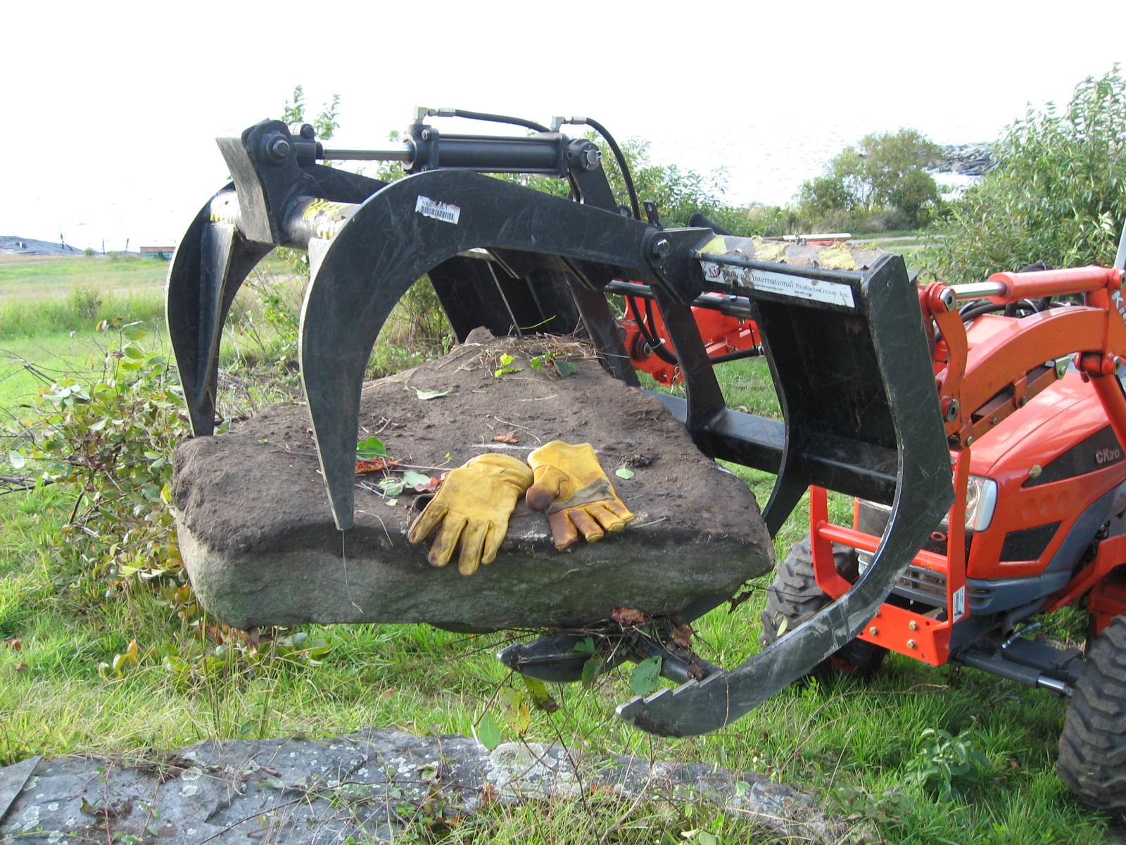

I have been intrigued by the capabilities of a grapple in place of the the FEL. Has anyone tried putting one of these on a 2310?
Like the Millonzi LD 48
Untitled Document
I have some big concrete blocks I need to move. It looks like it may be pretty effective.

Anbo's cost a LOT more than the Millonzi and are substantially heavier if I am recalling my figures correctly. I don't think there is an Anbo made that weighs only 285lbs like the Millonzi.
Be careful not to buy more grapple than you need as it will be both expensive and will limit your lift capacity. The Millonzi should handle concrete blocks fine and will certainly be able to hold more than your FEL can lift.

Thanks Island
I suspected they were pricier. They do have one model which weighs in about the same. Two others are heavier. - 345 pounds.
Price and weight are my two main factors. I do not need super heavy duty. It seems the heavier the grapple, the less I will be able to pick up.
Exactly. Also, consider that most grapples are actually designed for skidsteers which are likely to use them in more brutal ways than CUT owners would on their own property. A light weight grapple is really all almost any CUT owner needs. Some guys go overboard and get grapples made of T1 steel and grossly oversized for what they need but that is part of the same disease that gets people to buy 40+hp tractors to mow their lawns etc. The aim is to get the right tool for the right job and in the world of grapples only the smaller, lighter ones are really well matched to CUTs.

I have the Millonzi LD48 and it has 3/8 inch steel "fangs" top and bottom (I forget the technical term right now). I don't think you'll find any grapples made with 1/4 inch mild steel. The LD48 weighs 285lbs which is only about 100-150lbs more than your basic bucket so it should leave you with a good amount of lift capacity.

Yeah, I kinda thought 1/4" would be to thin. This is probably a better grapple for my needs. I would make something like this out of 3/8". It shouldn't take to much lifting capacity away from the FEL either. The hardest part will be to find time between all my other projects.
