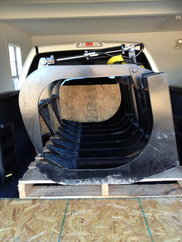

Picked up my new 48"econo Wild Kat grapple yesterday. And my WR Long valve kit was also delivered yesterday. My install will be a bit different in that I have to have pin plates fabricated and welded on because my loader is not a quick attach. I will keep the thread updated but my install may take some time. I can't even unload the grapple today because my daughter has ball games all day.

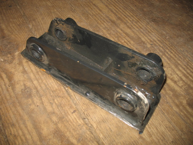

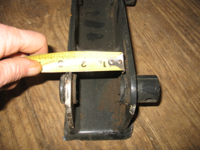

I have a set of pin plates I took off my bucket to convert to QA. Will accept loader frame width 2 & 1/4", and 7/8" pin diameter. If interested, send PM.

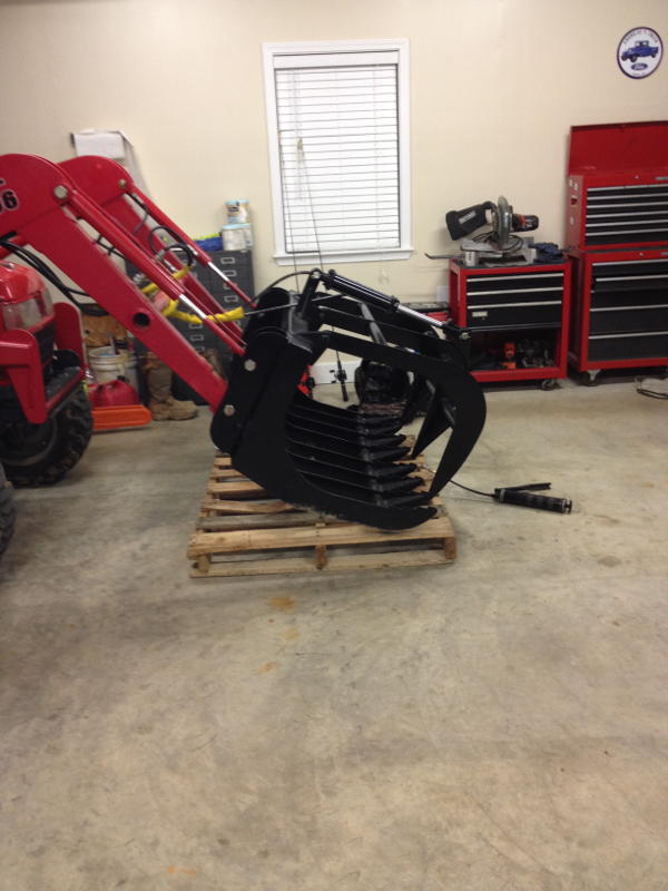

I said I would keep this thread updated which I haven't done. Well I finally got my grapple installed and functing. I'm looking forward to giving it a workout this weekend.
/ Grapple install #7
Looks awesome. You will love the grapple. For what it's worth, I have the ATI quick attach and it is pretty nice. It has a few shortcomings, but is adequate. My Kubota was not skid steer QA either.
And a bit of advice. Before you get too carried away pretending you are a bulldozer playing with you new toy and start knocking down trees and wading into house sized piles of debris, make sure your grill is protected with a good screen or guard of some kind. You will damage something eventually if you don't. Found this out the hard way!!
