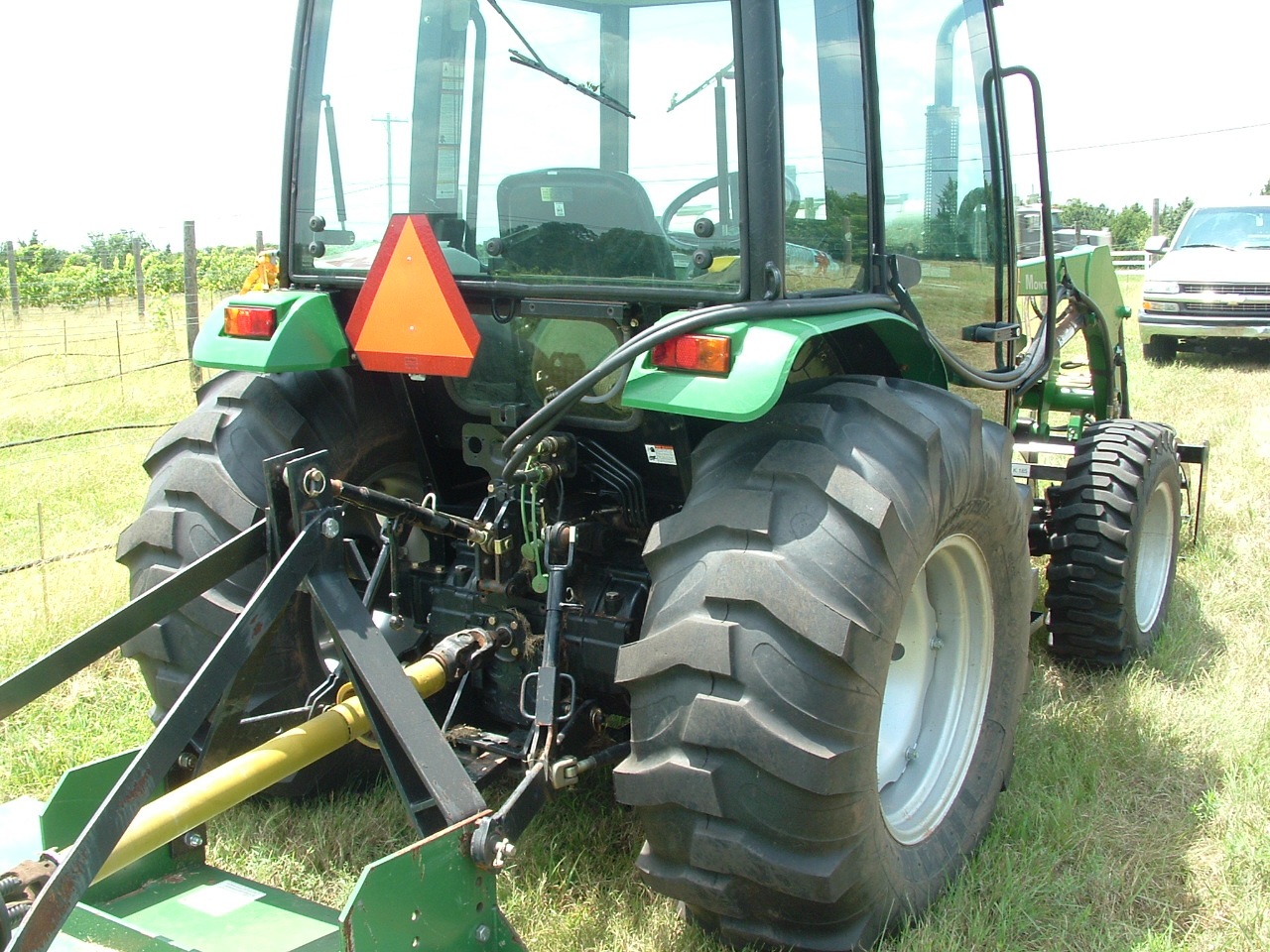

I posted a question a while back about the hydraulics on my new grapple. Attached are the pics that everyone requested.
The grapple is plumbed into the rear remotes (pic 003). The grapple came with the hoses already installed from the 'T' to the cylinders. I installed the hoses coming up out of the top of the 'T' that couple into the hoses that plug into the rear remotes.
The problem is that when I open the grapple and then let off the handle the claws seem to loose their pressure and slowly close instead of staying in place. Actually the grapple claws just flop around when I let off the handle instead of staying where I ant them. I borrowed another grapple once before I bought this one and didn't have this problem. I could open the grapple claws fully (or however much open I wanted them) and they would stay there in that position until I opened or closed them.
Any idea what my problem is?
Thanks,
JC

A couple of things to check: 1) Your remotes: Some are single acting and double acting but require you to choose which and 2) Make sure the ends on your hyd. hoses are compatible with whatever is inside your remotes.
The plumbing on the grapple is correct. An interesting experiment would be to reverse the connections at the remotes and see what changes, if any, occur...

I can't tell by looking but is there a flow restrictor installed on the grapple cylinders? (piston end) The first flow restrictor that I used when I made my grapple caused the same problem that you describe. I moved the restrictor to the other end of the cylinder and the problem moved to the location on the restrictor. I then bought a restrictor from TSC, which has a larger nozzle size, and it fixed the problem.

If one of the cylinders leaks internally it would cause that sort of problem.

But since the cylinders are hooked in parallel to each other, just one leaking internally (fluid bypassing the piston seal) would cause this condition.

I reversed the hook-up to the rear remotes and now the upper claws stay up where I leave them. Unfortunately now they won't stay locked down on the load when I let offr the handle.

Hmm, Is that tractor under warranty? Maybe on side of the spool is leaking internally...
